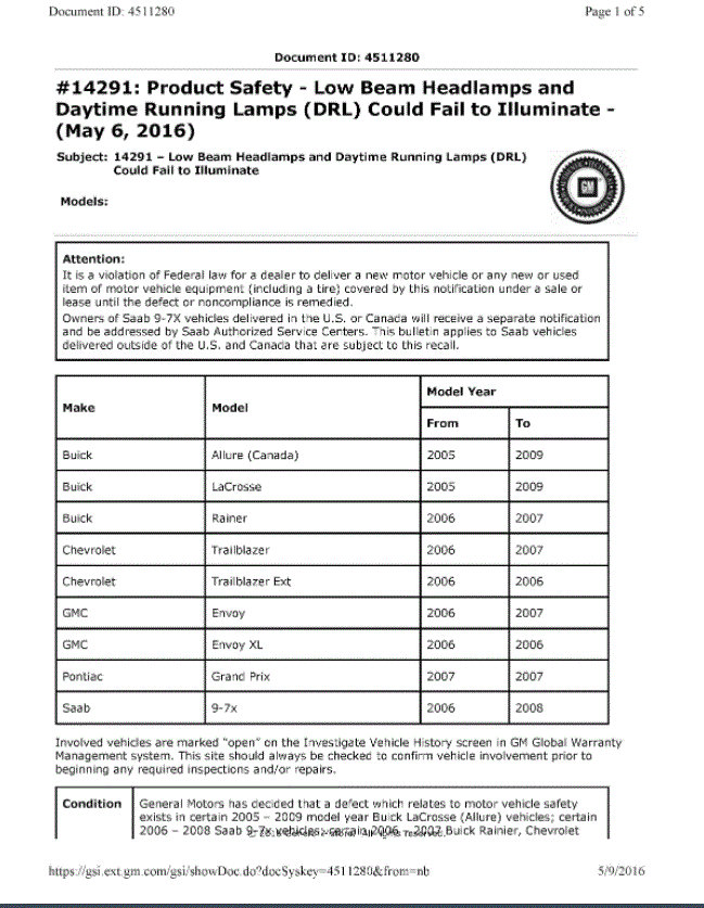

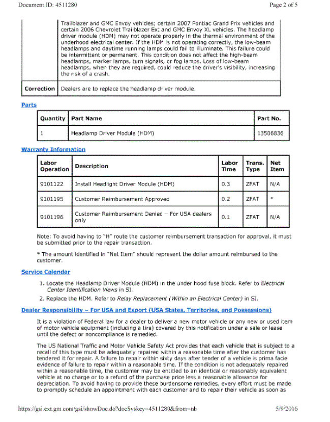

While driving at night my headlights will go off, I have to turn on high beams in order to see. after about 2 minutes they will come back on it will continue to happen while driving. also my back and brakes lights keep going out. I am continuously changing bulbs and the plastic part that holds the bulbs because it melts.
