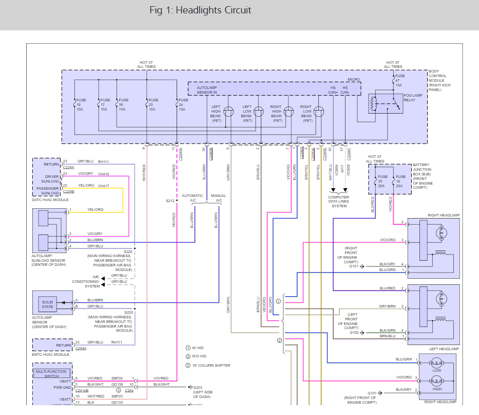

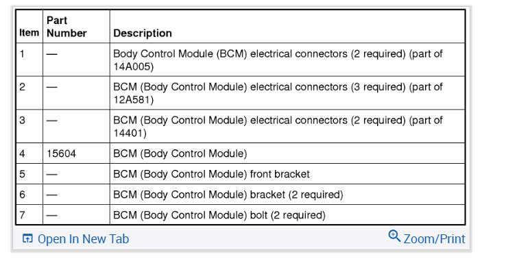

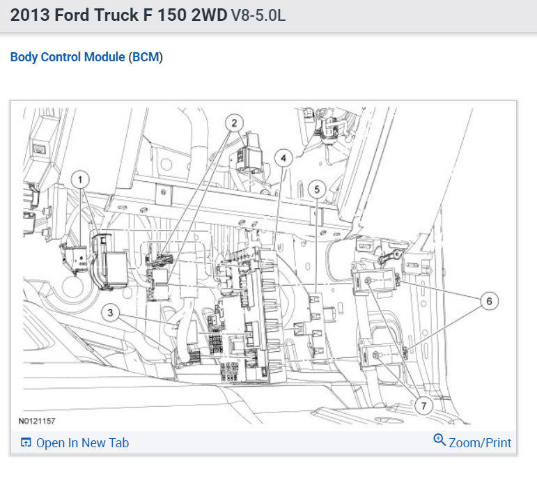

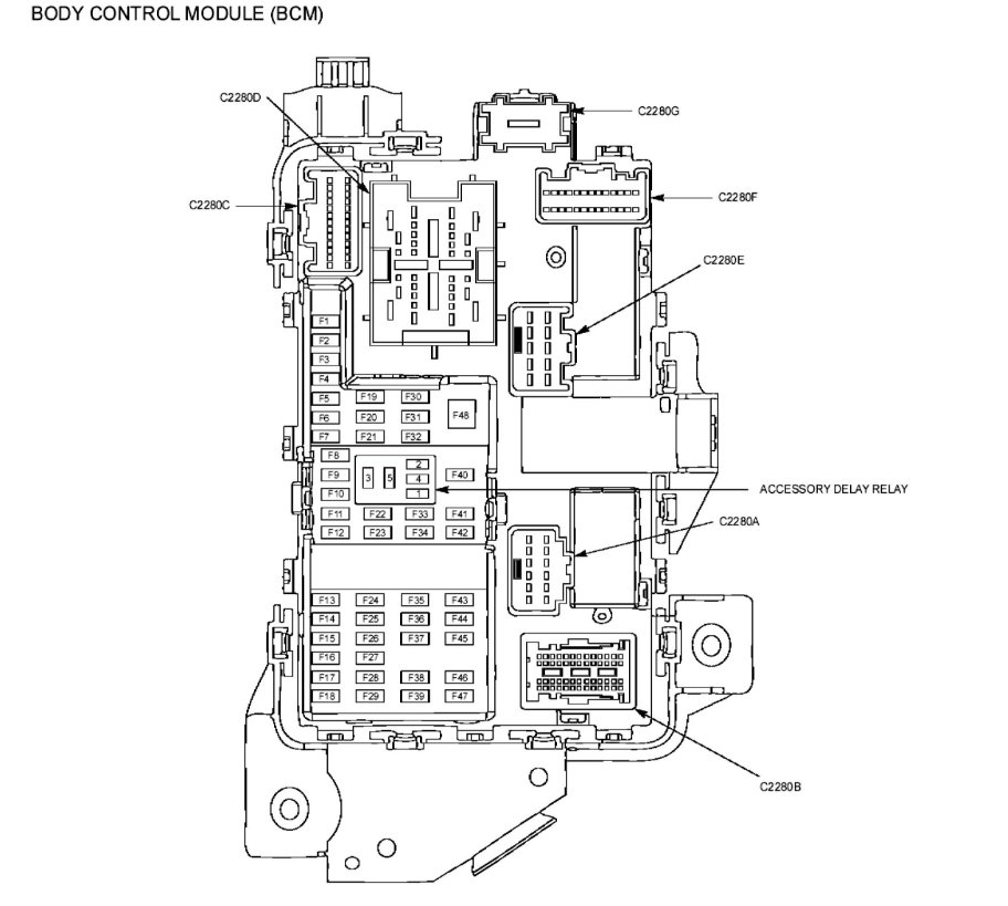

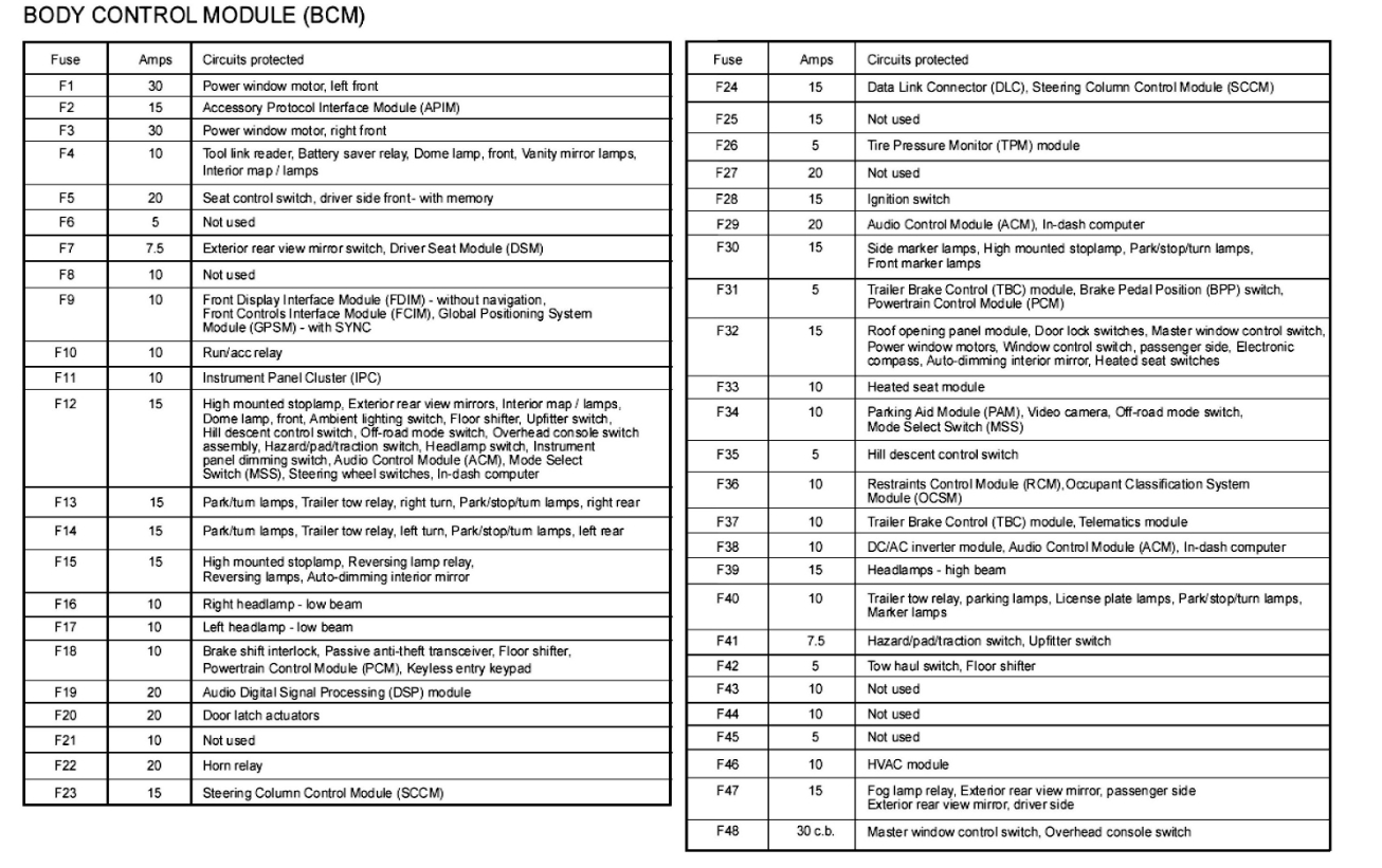

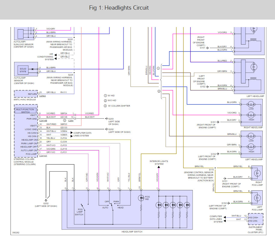

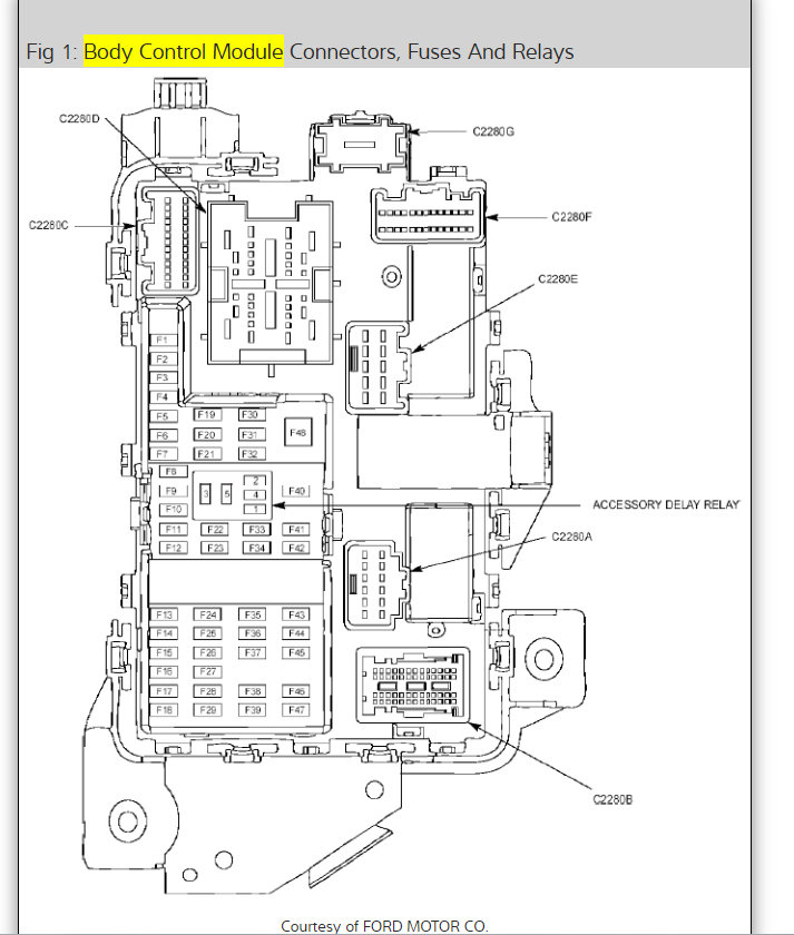

It sounds like the BCM has gone out but to be sure lets check the fuses that run the system, #16, 17, 39, 23 and 24. Here is a guide to help us get started and the wiring diagrams for you to see how the headlight system works and the fuse location and BCM location below.
If the BCM is bad it will need to be programmed in which will run about $130.00.

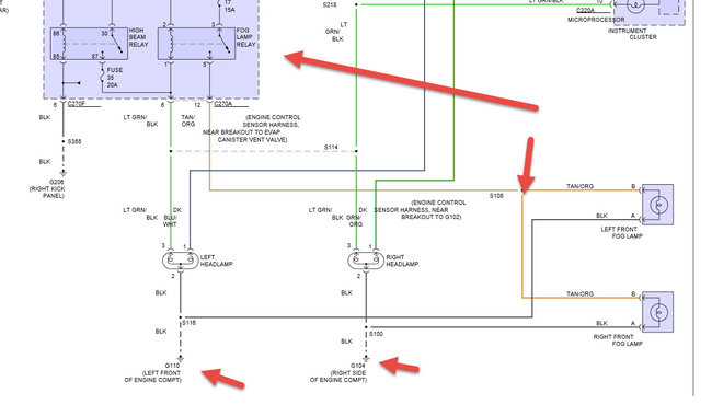

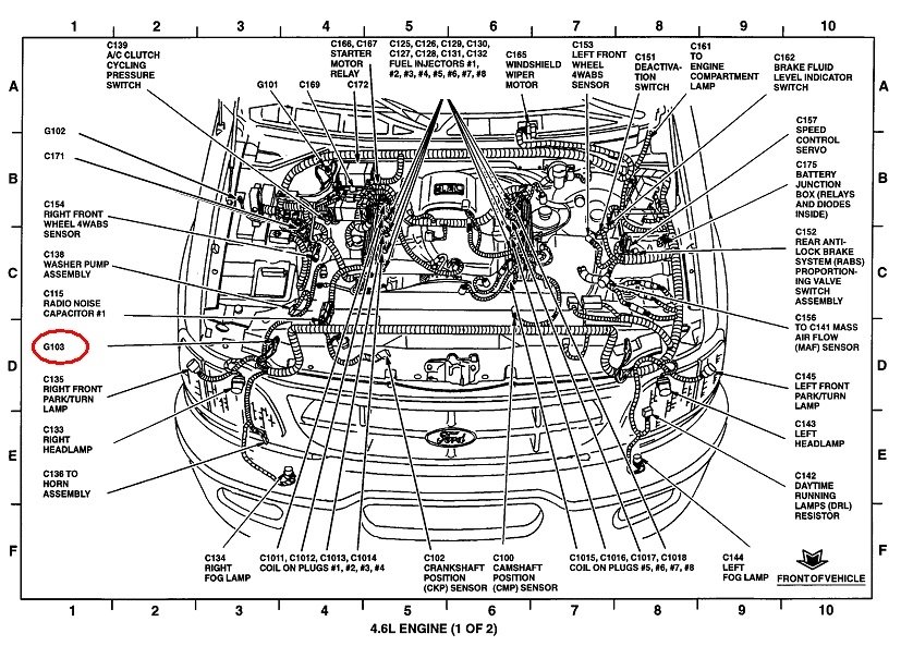

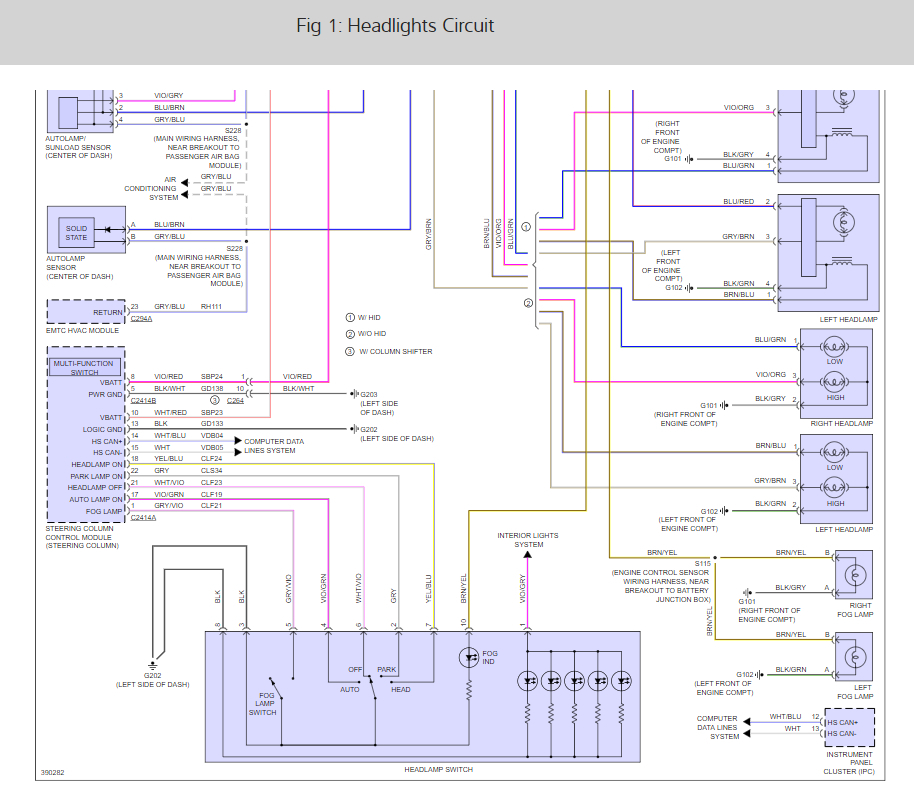

check items in pic like grounds etc. it may be a broken or shorted wire or bad connection at relay, try some dielectric grease on prongs of relay about $2 on counter at auto parts.

This problem could be the switch, can you please re-upload the pic harry? it didn't show up

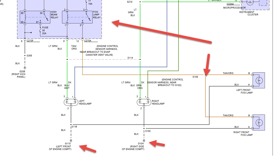

originally I sent a pic that didn't show up the fog lights operate off the same relay etc. you had stated that the one side worked which in the pic both operate off the same relay so it could be a wiring issue like shorting out or partially broken between LH and RH sides. so make sure to check that. the smart box problem I thought was limited to expeditions but not really sure. It is 2003-06 that have that problem and it's normally the fuel pump circuit that screws up, not the lights. so check the wiring in the pic as it may have a problem there it is the same color on both sides. also check the grounds as they are separate and could be the problem for one light.

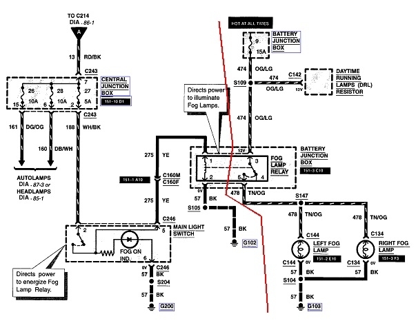

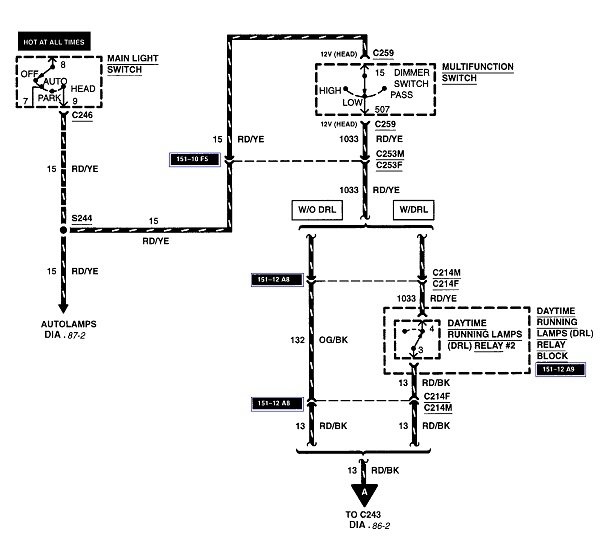

Your dandy observation that the relay clicks proves everything in the first diagram and everything left of the red line in the second diagram is working. That leaves very little. The tan / orange wire, circuit 478, is in common with both lights, but the better suspect would be a corroded ground, G103.
The third drawing is for the 4.6L engine, but G103 is listed as, "right front radiator support" for all engines.

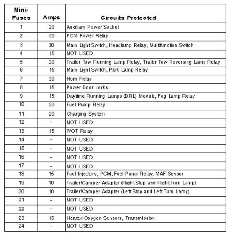

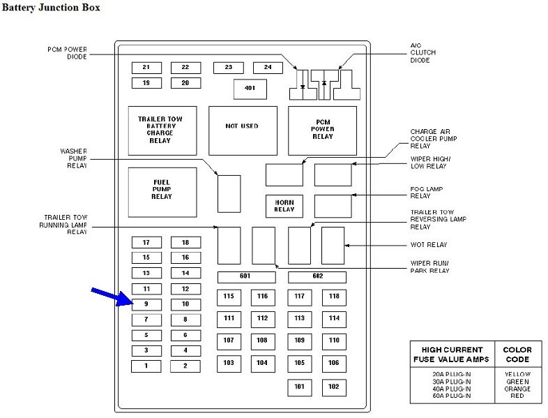

If the ground looks okay, turn the fog lights on, then take voltage readings at one of the bulb sockets. One must have 12 volts. If it's missing, check fuse 9 in the under-hood fuse box.
