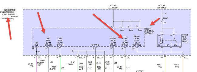

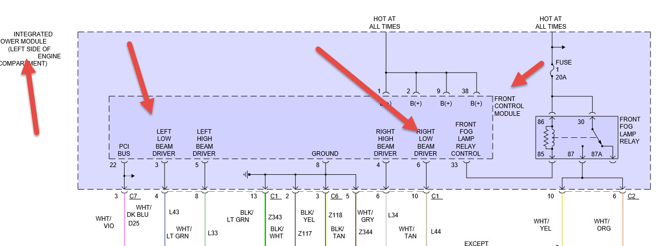

I asked about a 2003 dodge caravan se head light problem. I changed bcm got one from a salvage yard still same problem lights stay on when switch is off. if I unplug the light switch they go off only if ignition is turned off . soon as I turn key on they come on. I tested the light switch plug there is NO POWER TO ANY WIRES at the light switch
