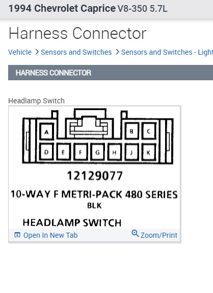

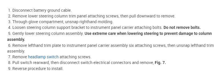

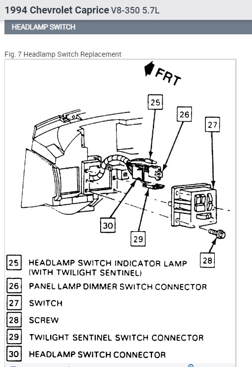

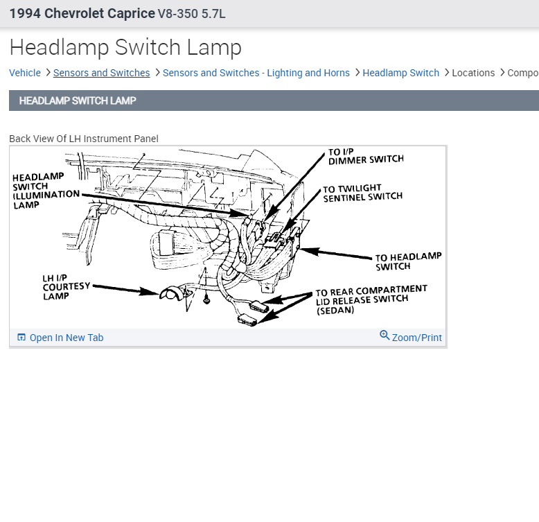

It sounds like it could be a faulty headlight switch. It is possible to have corrosion on the connectors that is triggering the intermittent light on and off.
Check the connectors and make sure it is secured, free of corrosion or burnt pin(s).
Here is a helpful guide:
https://www.2carpros.com/articles/how-a-headlight-switch-works
