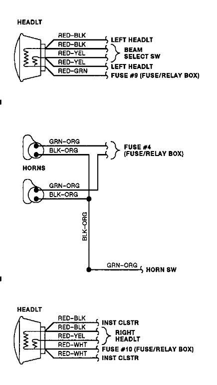

The headlight circuit for your vehicle is a very simple and straightforward system.
At the left headlight, test the Red/Green wire for battery voltage. If voltage is available, ground the Red/Yellow and Red/Blackwire individually and if light comes on move on to the light switch.
If grounding the above 2 wires at light switch turns the lights on, it means the light switch is bad or the ground circuit is open.
