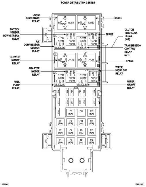

Sounds like a partial PDC failure. IE the main fuse box unit has failed inside. If the large fuses test okay then you will want to find a good shop and have them verify that, but it is very common. and expensive.
Chrysler decided to integrate as much electrical as possible and really screwed up by making one or two rails in the PDC power a lot of things and making it into a non-serviceable item. Instead you remove it and install a new one.

If it is the same year and model as the above it's very likely to be the same problem. Take a test light and run the fuses with it.
Make a note of which ones work and which don't and post the results back on here and we can look at the wiring and see if there is any single item that can cause those to stop other than internal failure.
