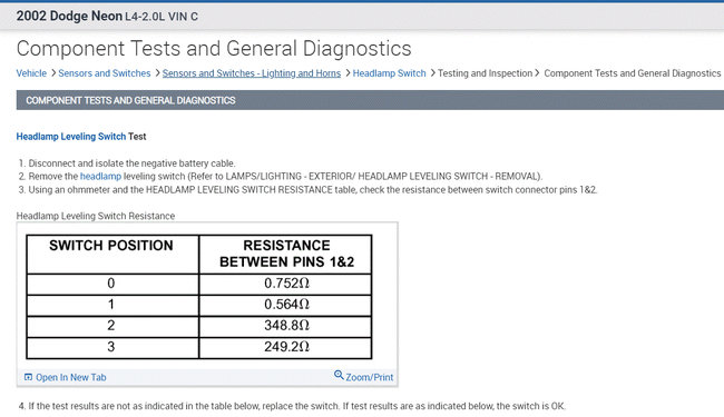

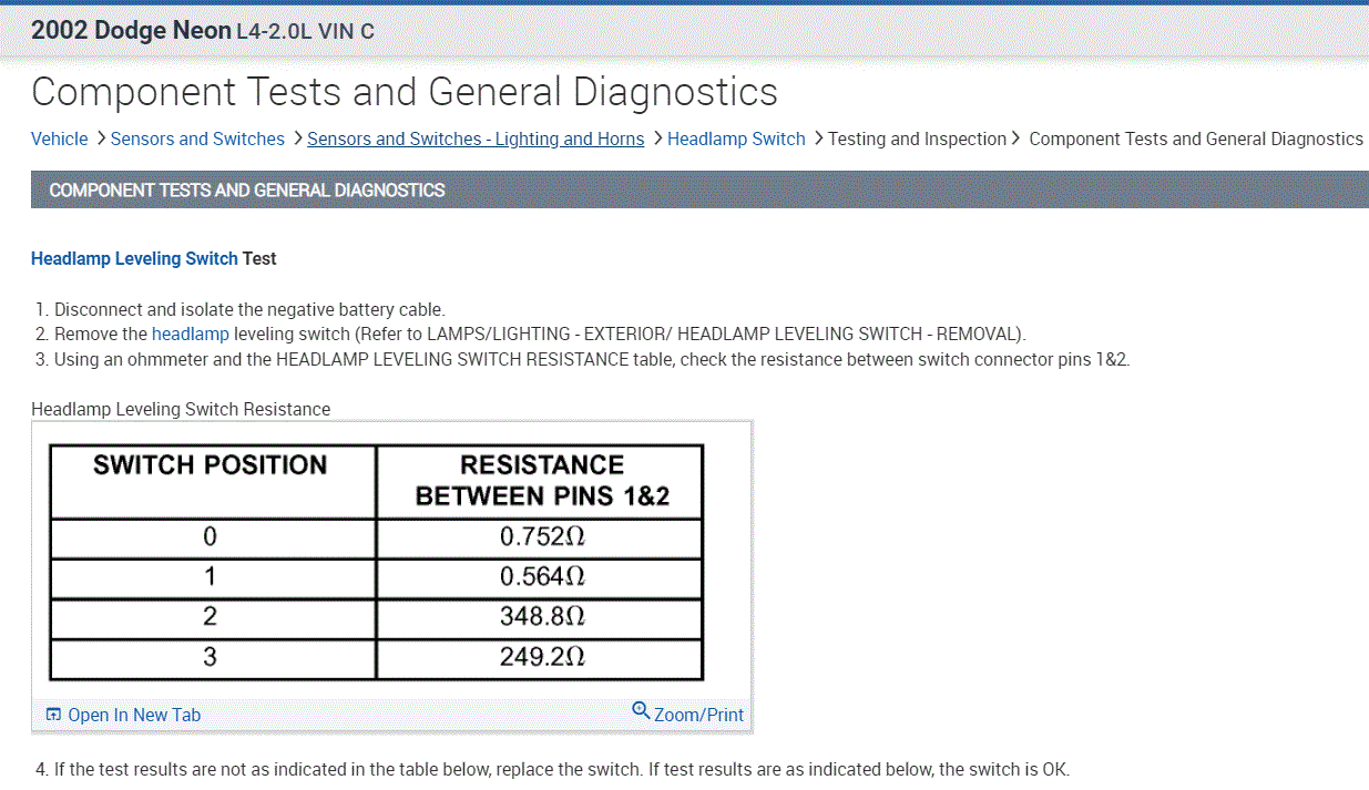

I read through the wiring schematics for both the parking lamps and headlamps. The only common denominator for both is the headlamp switch. Have you checked the switch or replaced it?
I attached diagnostics for testing the switch. Take a look through them and let me know if you are comfortable performing them.
Let me know what you find.
See pic below.
