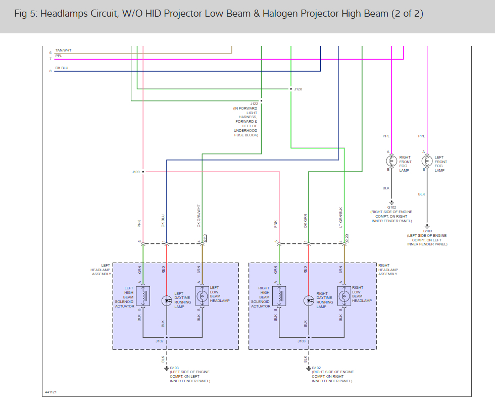

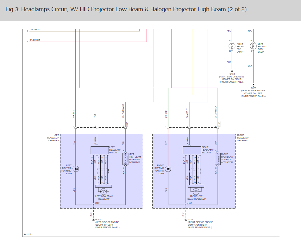

I have the vehicle listed above SLT model with 9012 bulbs. I wish to change them back to original HID light bulbs D3 S. how much work would it be to change them? Do I have to change the wiring or use the wiring that's there?
