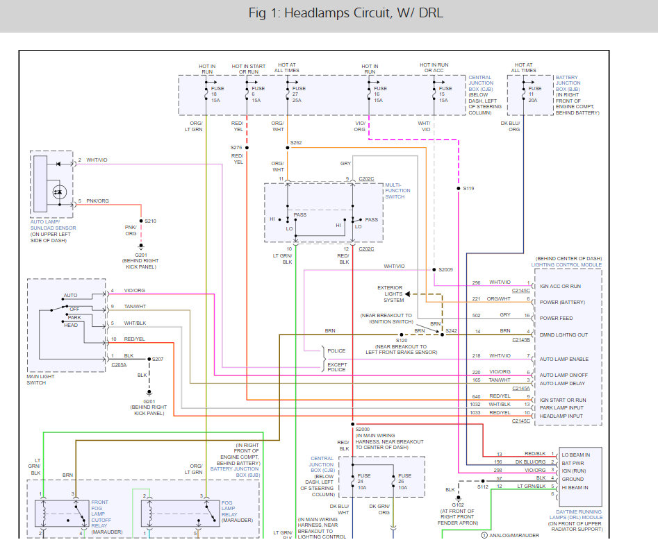

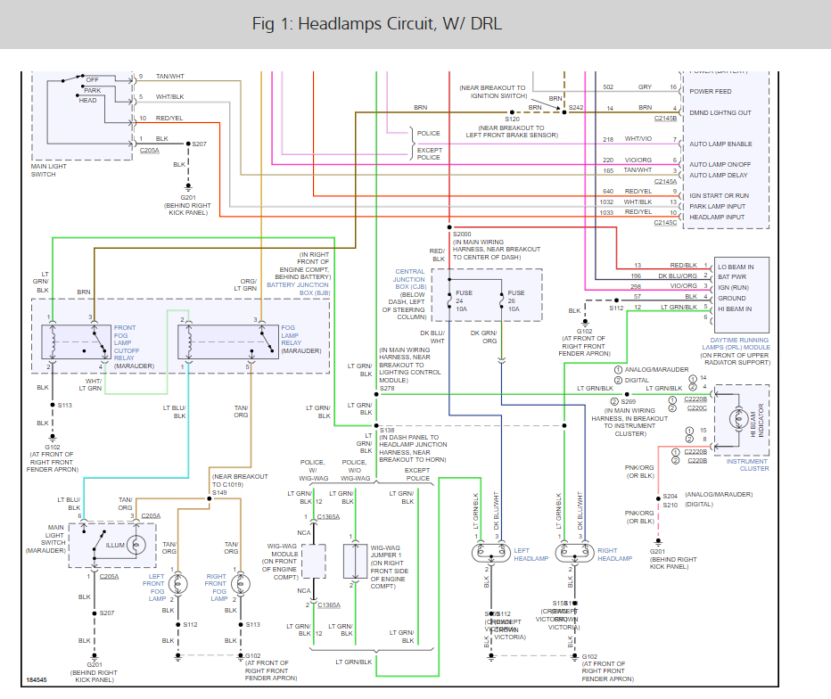

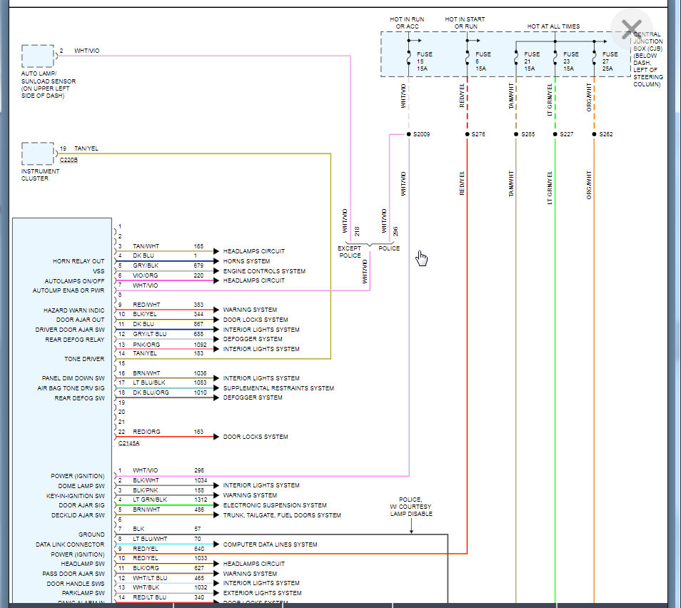

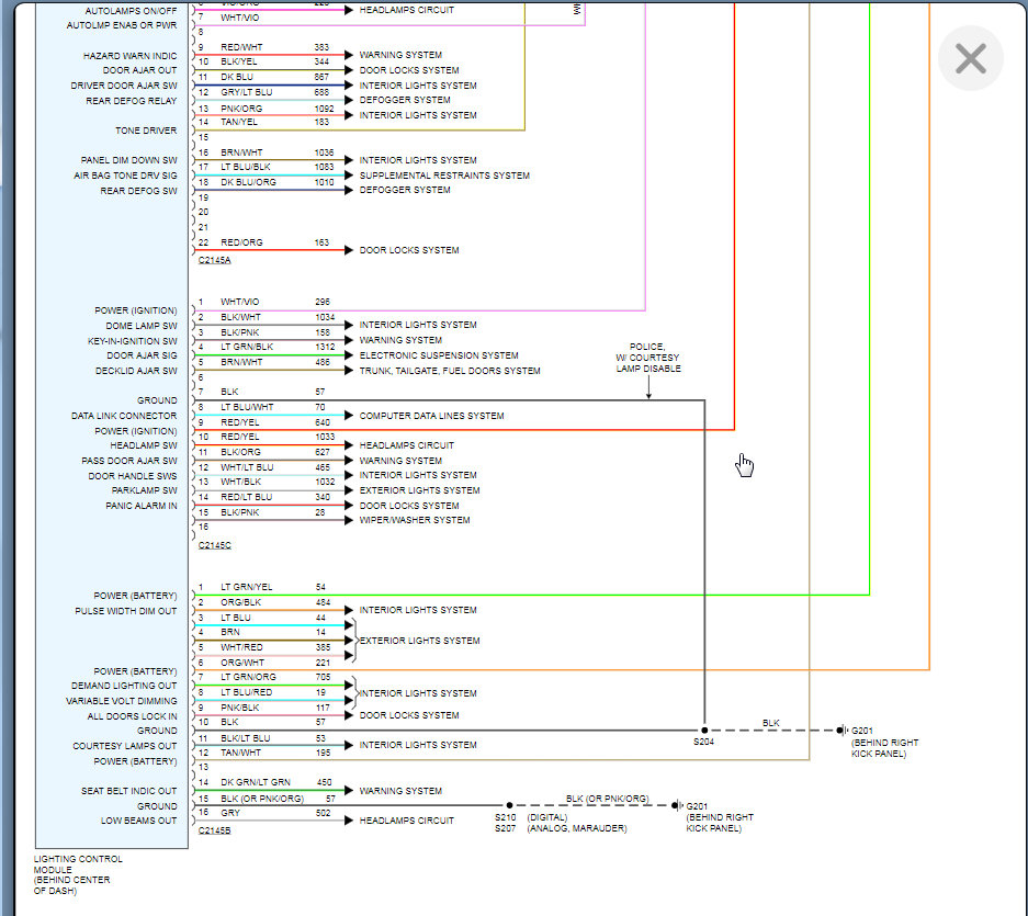

Here is the wiring diagram for the LCM that shows all these fuses but let me know if it something different. Thanks

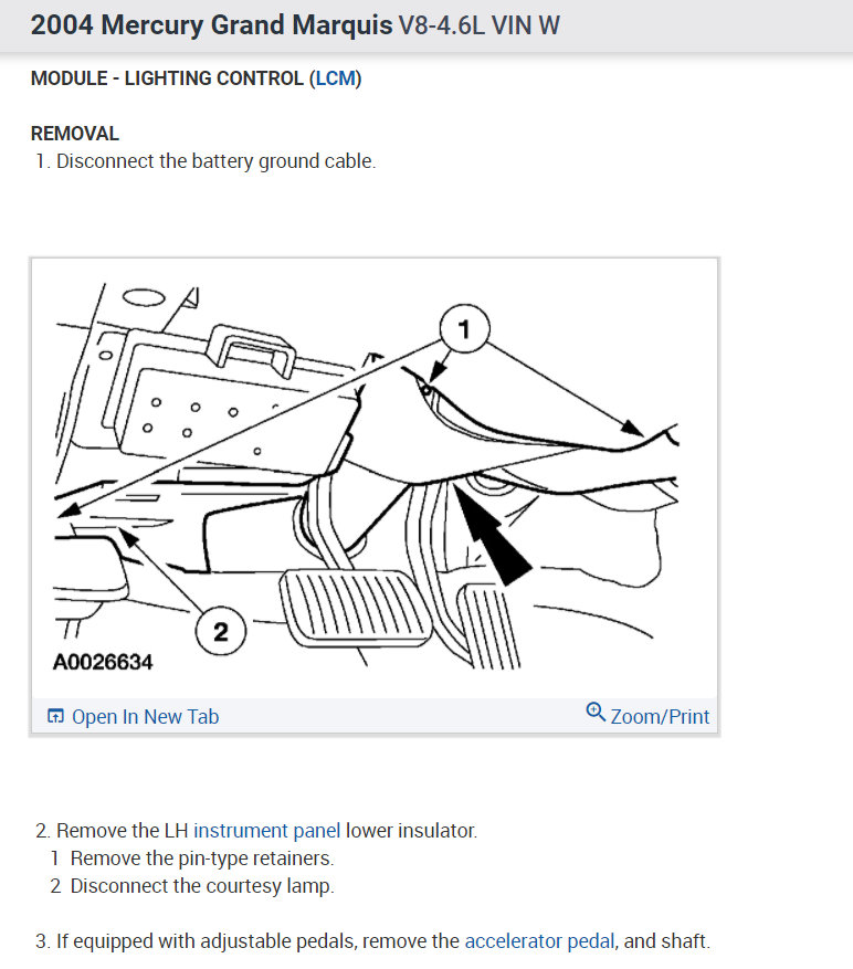

It sounds like you have a lighting control module that is out. with the headlights on (fuse good) see if the module is warm. if so I would replace it. here is the location of the lighting module and the headlight wiring diagrams so you can see how the system works. Check out the diagrams (below). Let us know what happens and please upload pictures or videos of the problem.
