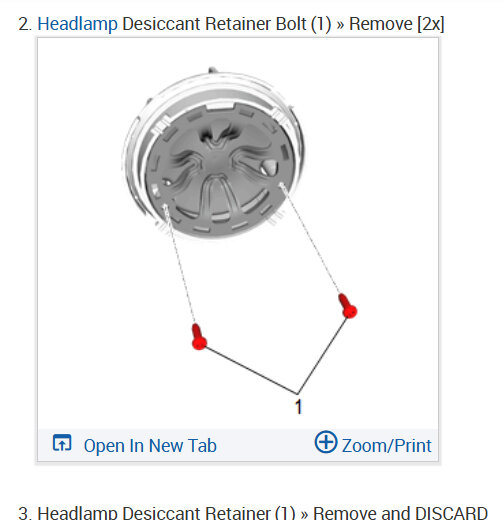

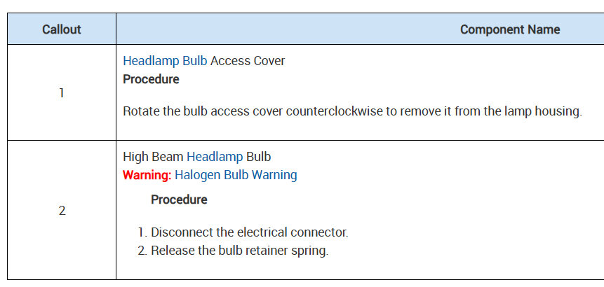

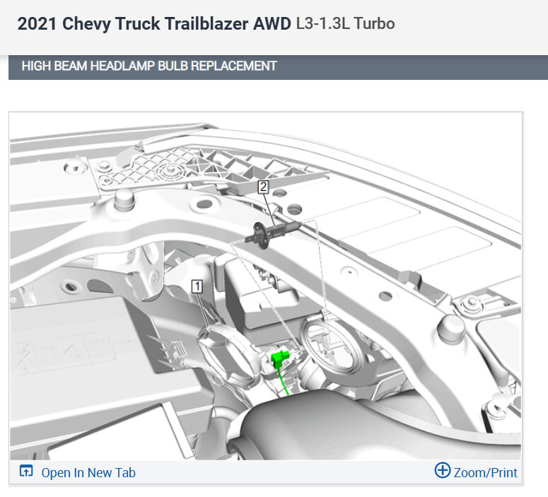

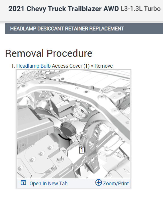

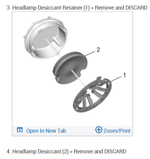

It sounds like there is something wrong with the headlight desiccant, or the bulb is not installed correctly or that it has the wrong headlight housing installed. Check out the images (below). Please upload pictures or videos in your response of any problems so we can see what to help you with and let me know how it goes.
