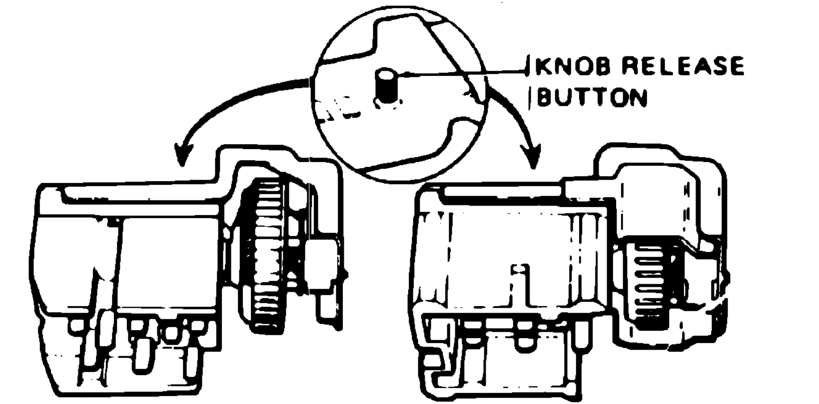

Headlamp Switch
See Pic 1
1. On models equipped with airbag disable airbag system as described under MAINTENANCE PROCEDURES/AIRBAG SYSTEM DISARMING.
2. Under instrument panel, depress light switch knob and shaft retainer button on side of switch and, while holding button in, pull knob and shaft assembly from switch, Fig. 2.
3. Unscrew trim bezel and remove locknut.
4. From under instrument panel, pull switch from panel while tilting downward, disconnect electrical connector and remove switch.
5. Reverse procedure to install.
