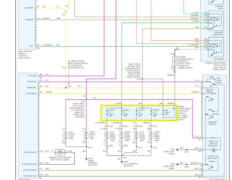

The drivers side head light is very dim.
Mar 11, 2019 at 4:34 AM
Good morning,

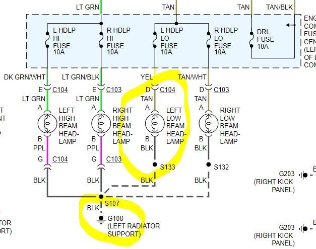

The most common issue is either a bad ground or the connector on the headlight is corroded.
The ground is on the left radiator support. It is the ground for all the headlights.
I would think it is the connector.
