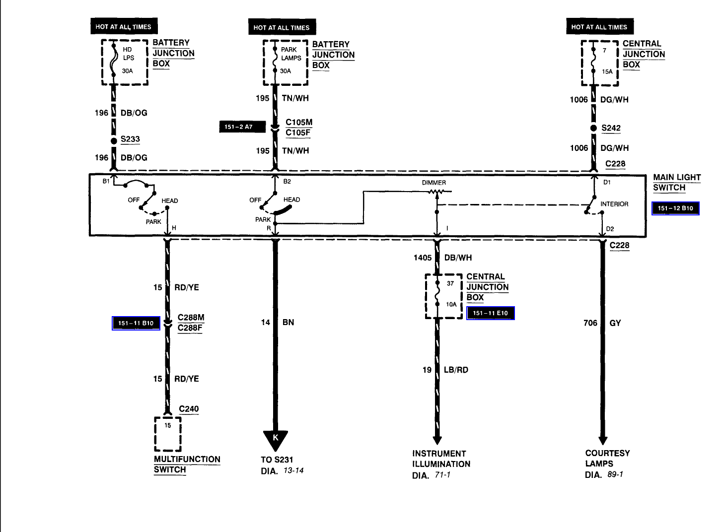

I need a wire diagram telling me which wires go where on the headlight switch pull switch. I was not the person who disconnected the wires. now I need to connect them. the car is the Gt model.

This is the diagram showing the switch. Is the plastic connector still there or ? Check out the diagrams (Below). Please let us know if you need anything else to get the problem fixed.
