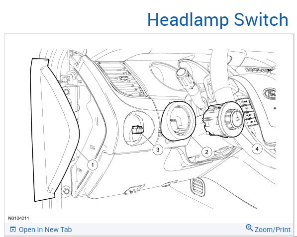

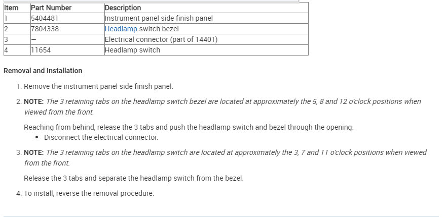

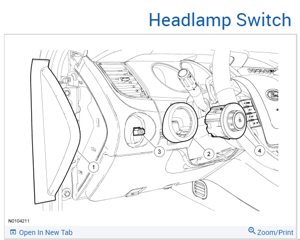

As far as replacing the headlamp switch, it's not too hard, but you need to take your time when removing the plastic bezel around it. It is clipped in so take your time not to break any of the plastic clips.

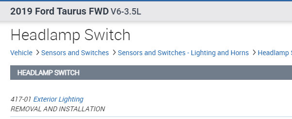

If you look below, I attached the directions from the manual for replacing the switch. Take a look through them and let me know if you have questions.
Let me know if this helps.
See pics below.
Aug 21, 2022 at 9:16 PM
JEFFK53
Hi Joe, this is exactly what I was looking for, wanted to know if there were any hidden screws and didn't want to end up breaking any tabs on the panels. Next step is to get the headlight/fog light switch and assemblies. Couldn't believe the Ford dealer couldn't find the switch!
Thanks,
Jeff
Aug 22, 2022 at 7:07 AM
There shouldn't be any hidden screws. It is held in with the three retaining clips. Just be careful and don't force it.

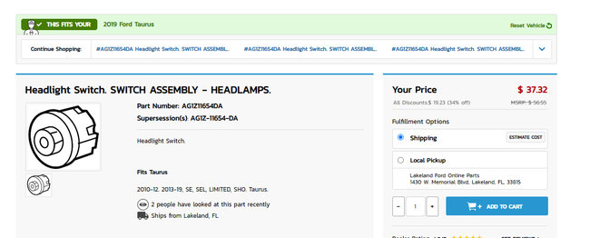

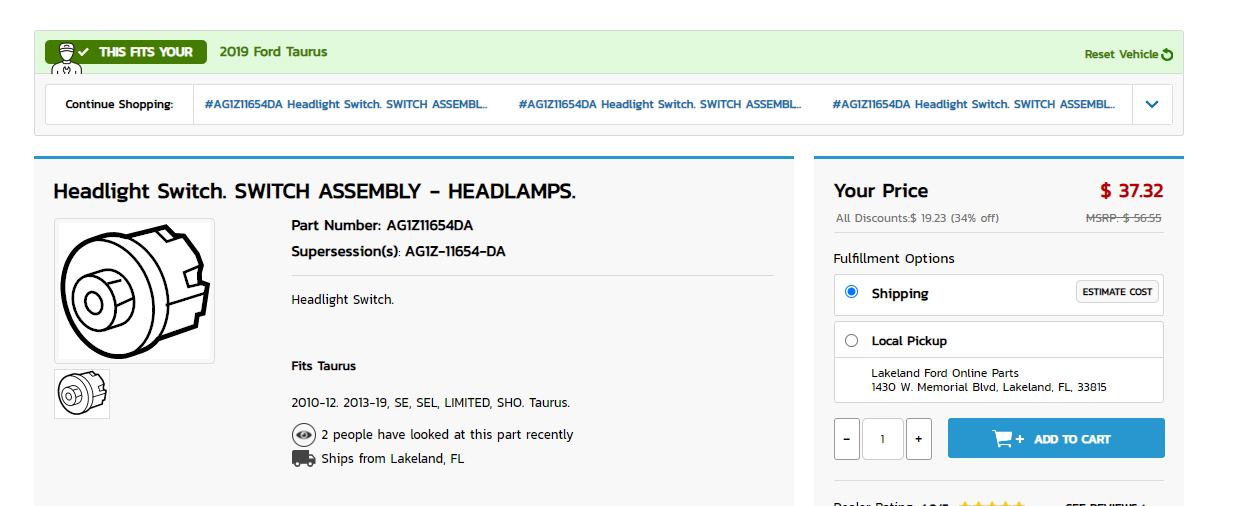

I'm surprised too. This is a newer car. I find it hard to believe they couldn't find a switch. The OEM part number is AG1Z11654DA. If you type in Ford part AG1Z11654DA, you'll find them. I attached a pic below that I found.
joe
See pic below.
