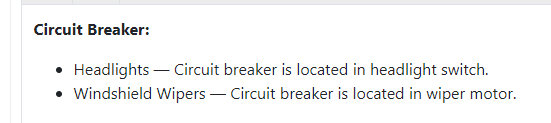

In 1982, they used a circuit breaker that was integral to the headlamp switch. See pic below. To the best of my knowledge, no relay was used. Power was supplied from the switch.

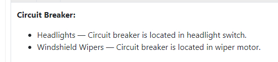

See pic below.
