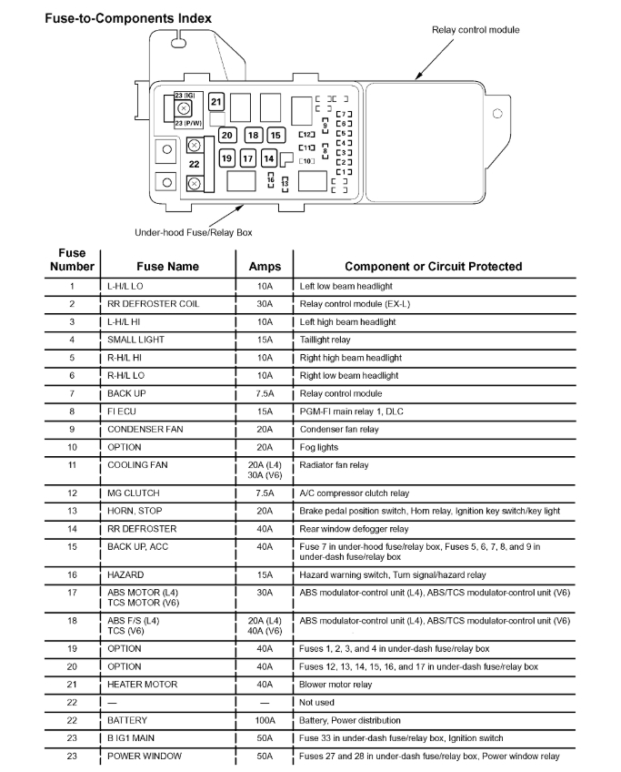

Trying to check the right headlight relay, but i cannot find it. Where is the relay for my right head light located?

there is only high and low beam relays check fuses five and six under hood fuse box. if not that then it may be a ground or bulb issue. It may also be your multi function switch on steering column which a mechanic should check if everything is okay elsewhere. Here is a guide to help test it and the headlight relay location in the diagrams below.
