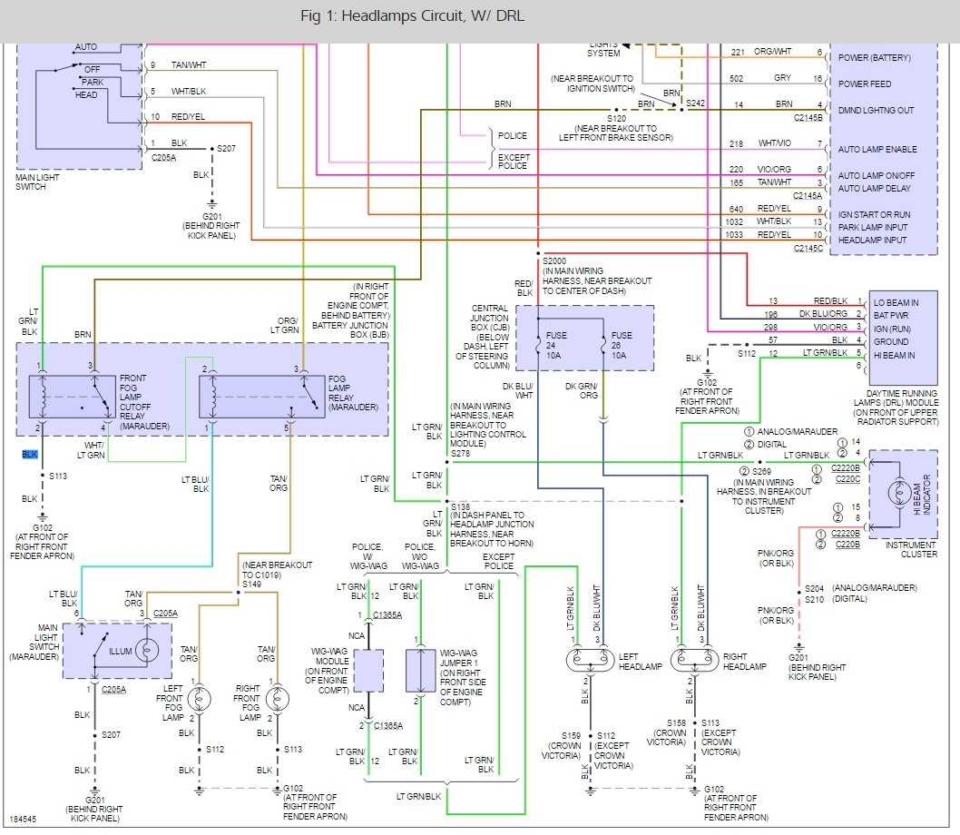

I bought a headlight for my car, but it doesn't work. Thanks
Feb 20, 2017 at 10:18 AM
Hey Guys,
I have this wiring diagram and I don't see a headlight relay just a lighting module like Steve W. said run some tests using a test light to find where you are loosing power.
Please run some tests and get back to us so we can continue helping you.
Best, Ken
May 7, 2019 at 11:01 AM
HIL0143COMCASTNET
Does it have one? Headlights not working headlight wiring diagram.
May 19, 2021 at 6:50 PM (Merged)
There is no headlight relay. Here is a headlight wiring diagram to show you how the system works and a guide to help you check the wiring:
Cheers
JCLINT
  • 0 POST
I had this problem it was the main headlight switch. Thanks for the guide. I love this site.
