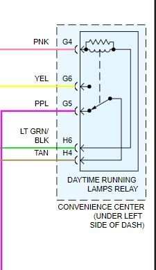

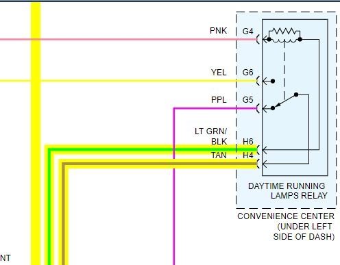

My first suspect is the day time lamp relay. It is located under the left side of the dash. I attached a picture of a portion of the wiring schematic showing it. If there is a relay with the same part number, switch them to see if that changes anything. Also, here is a link that shows how to check a relay.

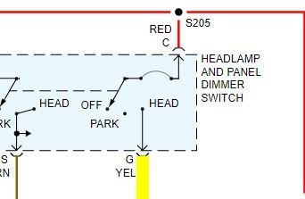

Okay, I see only a few possibilities. First, you checked the DRL relay. Take a look at picture 1. Make sure power is available at pins H4 and H6.

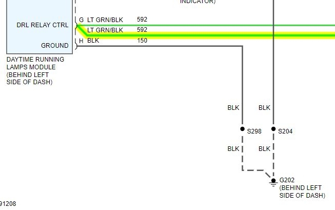

3. Look at picture 3. Here is what I need you to check. Make sure there is power to the highlighted wire which goes to lamp feed with the lights on. If there is, then check the ground for the DRL relay module. See location in image. If there is power in to the light feed and the ground is good, I suspect the relay module has failed.
