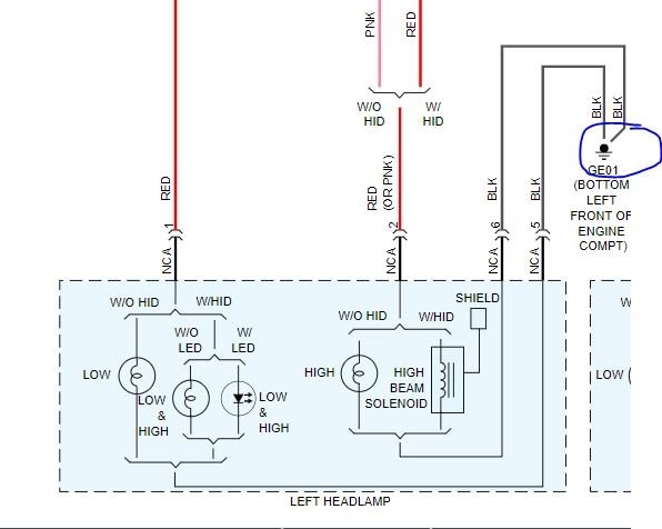

Next, if both high and low beam stopped at the same time, check and confirm the ground is still good. See pic 1 for location.
As far as a fuse or relay, there is a high relay, but that wouldn't affect the low beam. Also, there isn't one fuse for both high and low beam.
Make sure the bulb is good and check the ground. Also, if possible, upload a pic of the damaged item you mentioned.
