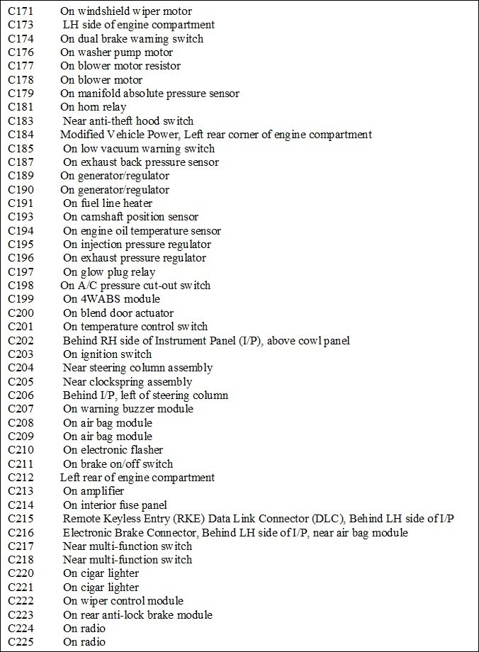

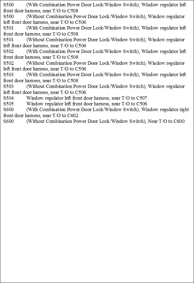

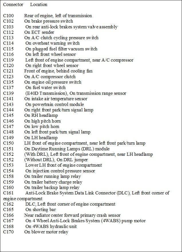

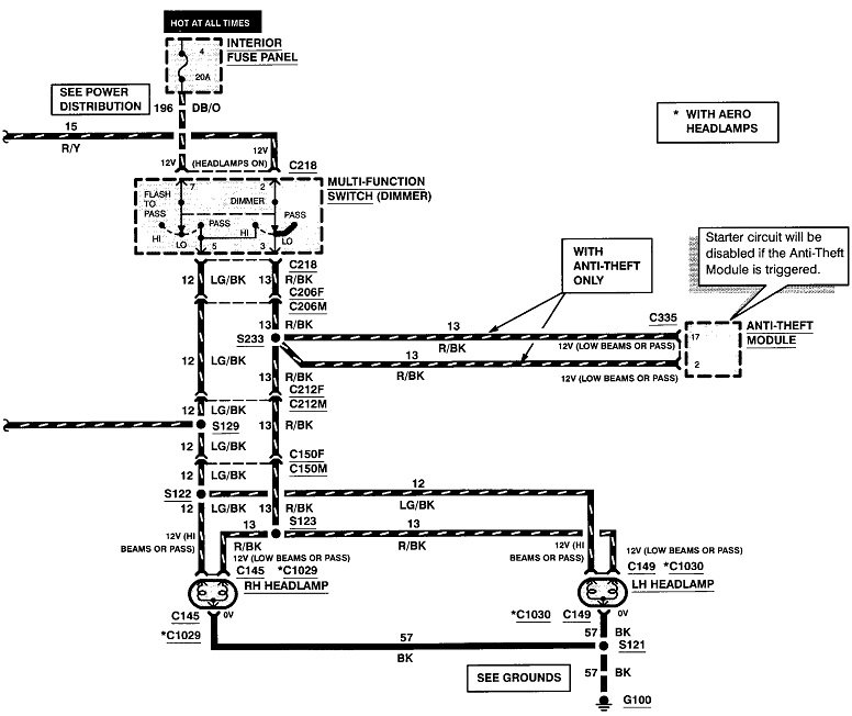

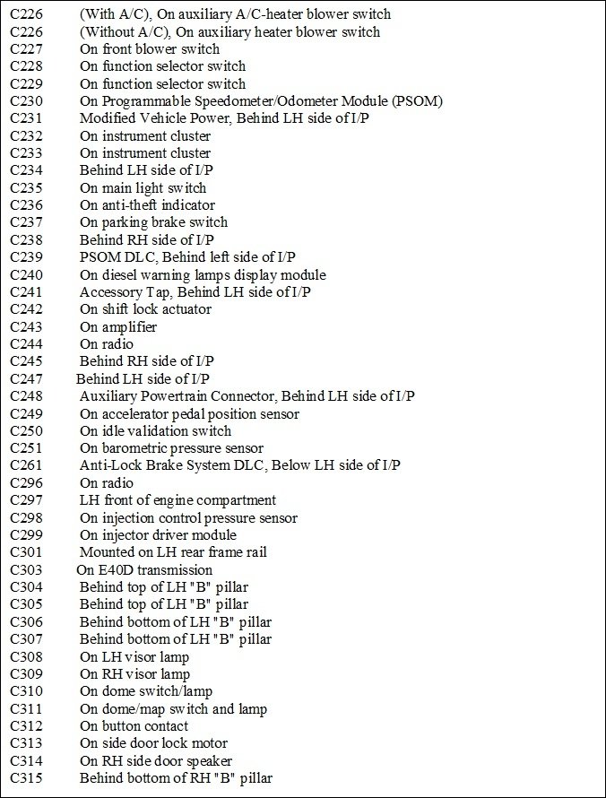

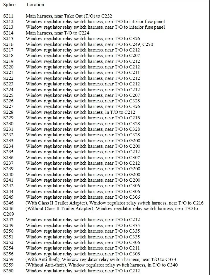

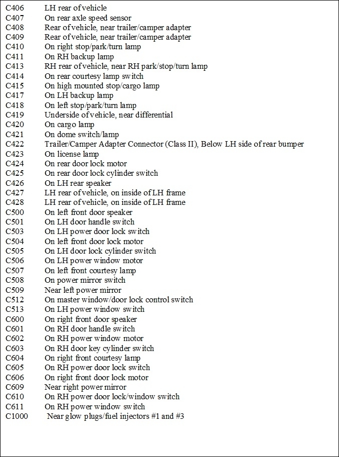

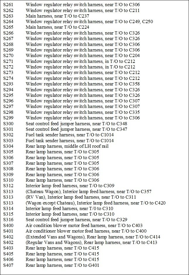

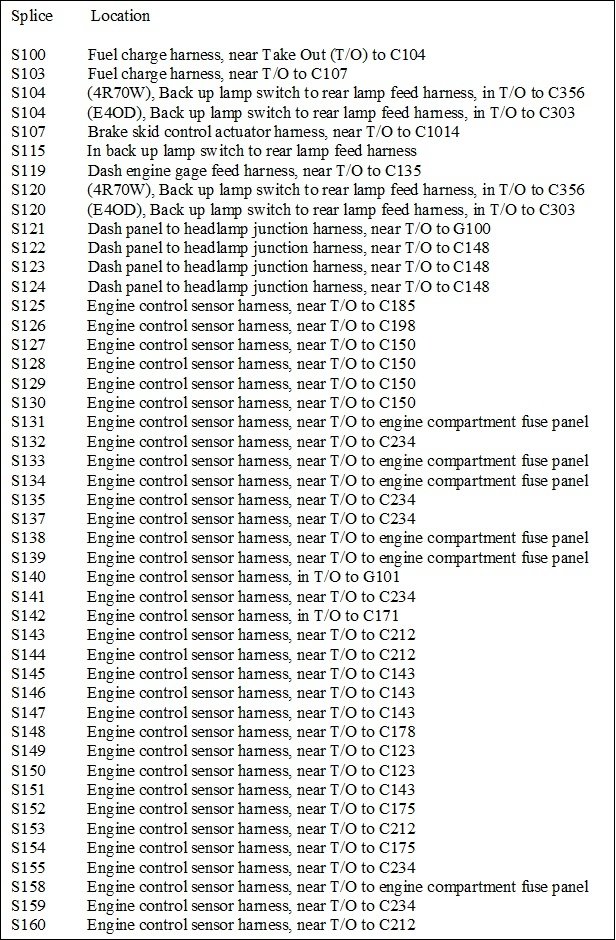

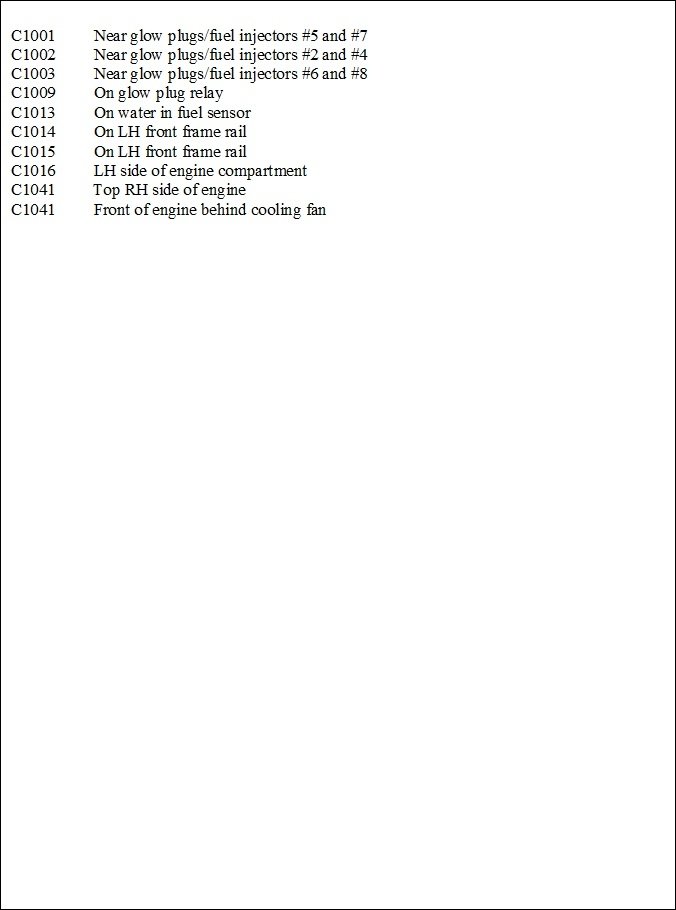

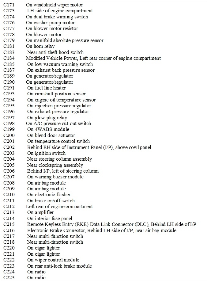

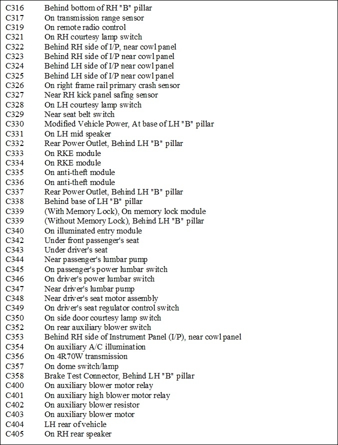

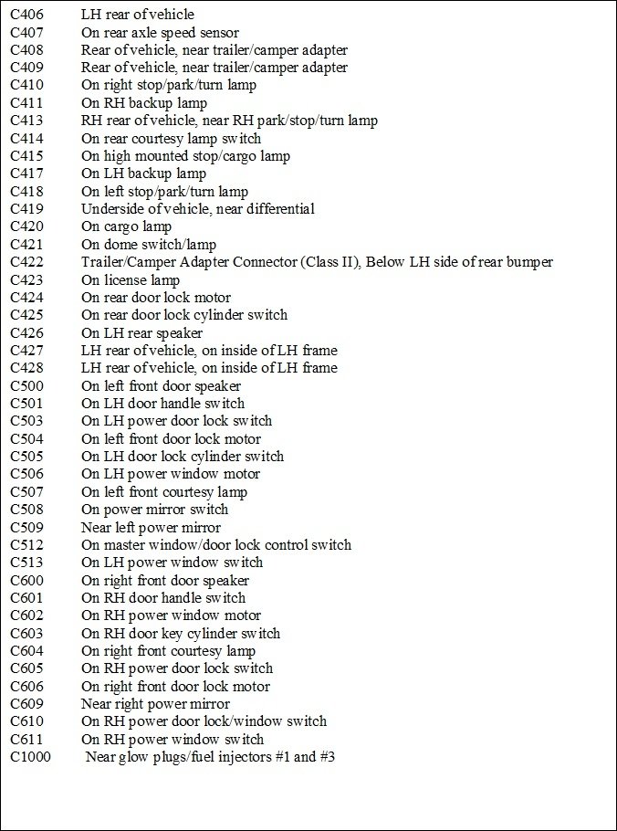

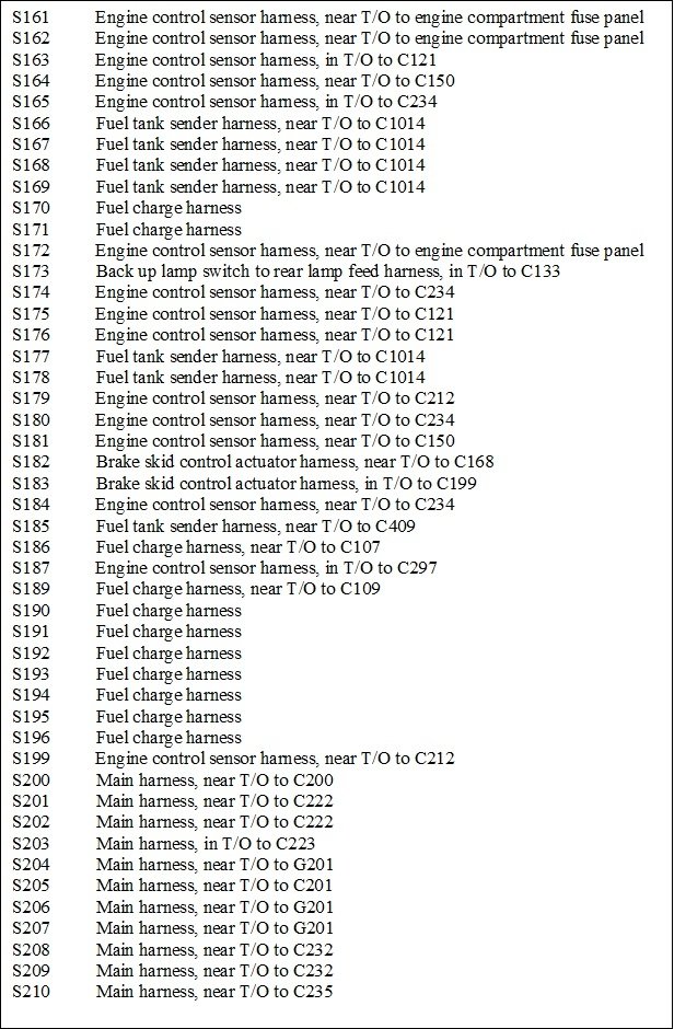

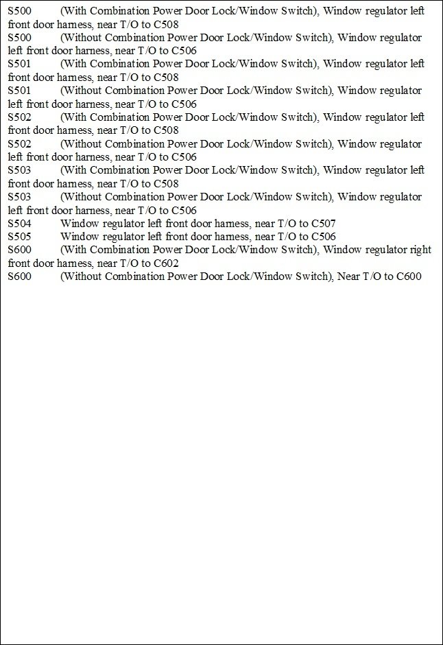

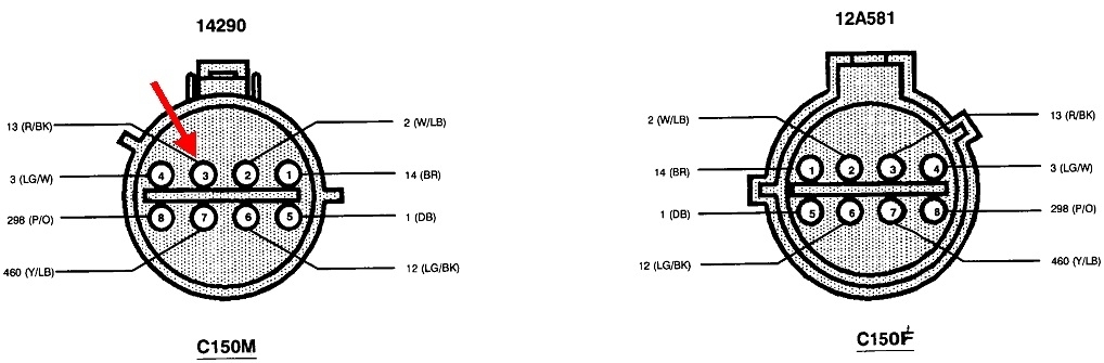

Hey, look what I found. This is a list of connector locations. The last four drawings show the three connectors, in order.

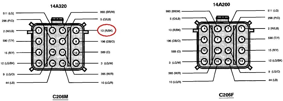

There's two solutions to this voltmeter problem. Both require current to be trying to flow in the circuit, then the results of that high resistance will show up as voltage that is too low, just like water pressure is too low at the end of the hose. The first method is simply to let the head lights try to draw current, (meaning to cause current to want to flow). That means all the connectors have to plugged in, then you can back-probe next to the wire where it goes into its slot at one of those connectors. If you find 12 volts, try again on the other side of the connector, or just move on to the next test point down the circuit. When you find 12 volts, the circuit is good up to that point. You're looking for the first place you find the 12 volts is missing. That's the point of the high resistance, (your foot on the hose).
The alternative is fast and is a better choice when it is too difficult to back-probe a connector. Unplug it, then use a test light instead of a voltmeter. Unlike the voltmeter, a test like requires current to flow through it to make the bulb light up. This has to be the common, cheap test light with an incandescent bulb. There's new electronic test lights on the market that provide inaccurate results the same as voltmeters do. The only way to get enough current flow to light up the bulb is if the circuit has no breaks up to that point. If there's a solid break, the bulb will be off. If there's a high-resistance break, the bulb might glow dimly, but consider that as "off" because only a bright light indicates the circuit is okay to that point.

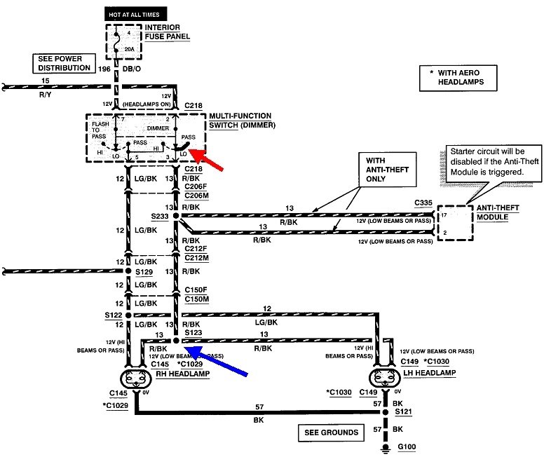

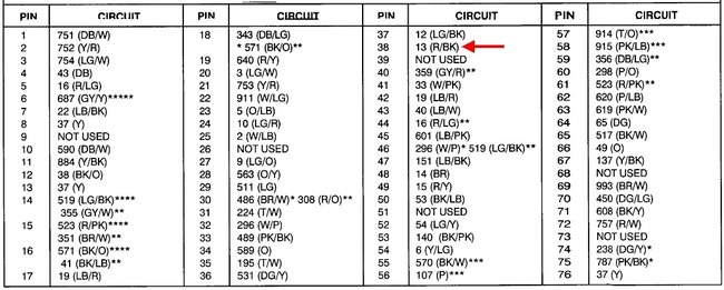

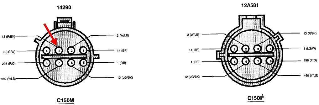

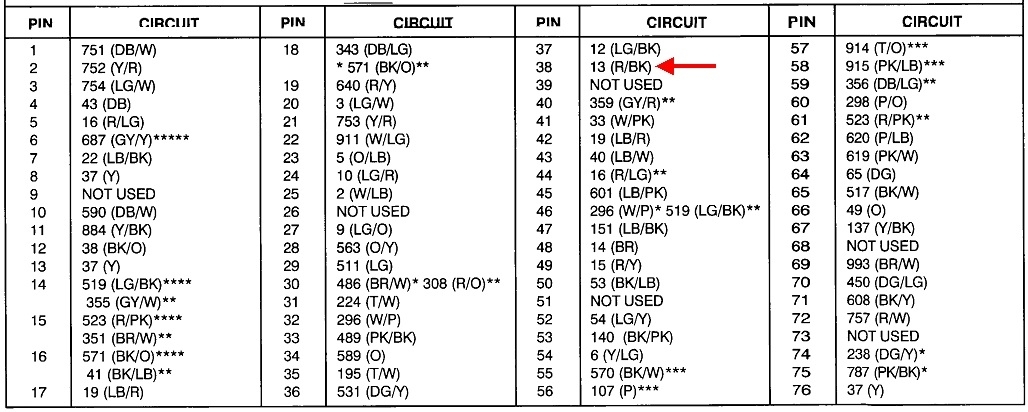

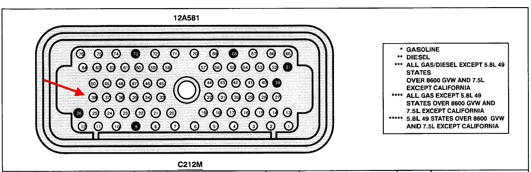

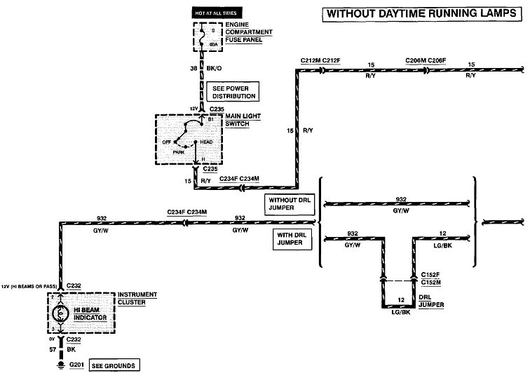

If you're on the verge of becoming confused, this will finish the job, so don't read any further if that's the case. This isn't an important detail, but this is the perfect circuit to explain the most efficient way to do this type of testing. Some people will find the 12 volts missing at the head lights, then work back to connector C150, then back to C212, then to C206, and then to the multi-function switch. If the bad connection is at the switch, it could be an hour of crawling around before they find it. My preference is to start at the switch, then move on to connector C206, then C212, and then to C150, in that direction. I risk wasting time to get all the way to the last splice before I find the cause of the problem.
The most efficient way is to start in the middle, in this case, at connector C212. If the 12 volts is there, the cause is in the last half of the circuit. If the 12 volts is missing, the cause is in the first half starting at the switch. Once you know which half it's in, find a good test point in the middle of that one. Each test eliminates half of the circuit you need to look in for the problem. This assumes all the places to test are easy to get to. Sometimes we have to pick the easiest ones first to save time, then go digging for the hard ones after testing shows that to be necessary.
