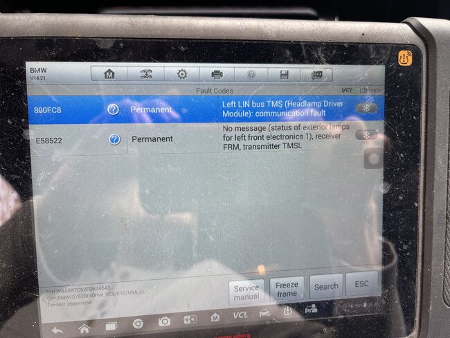

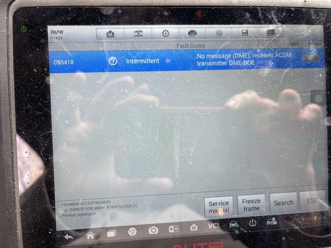

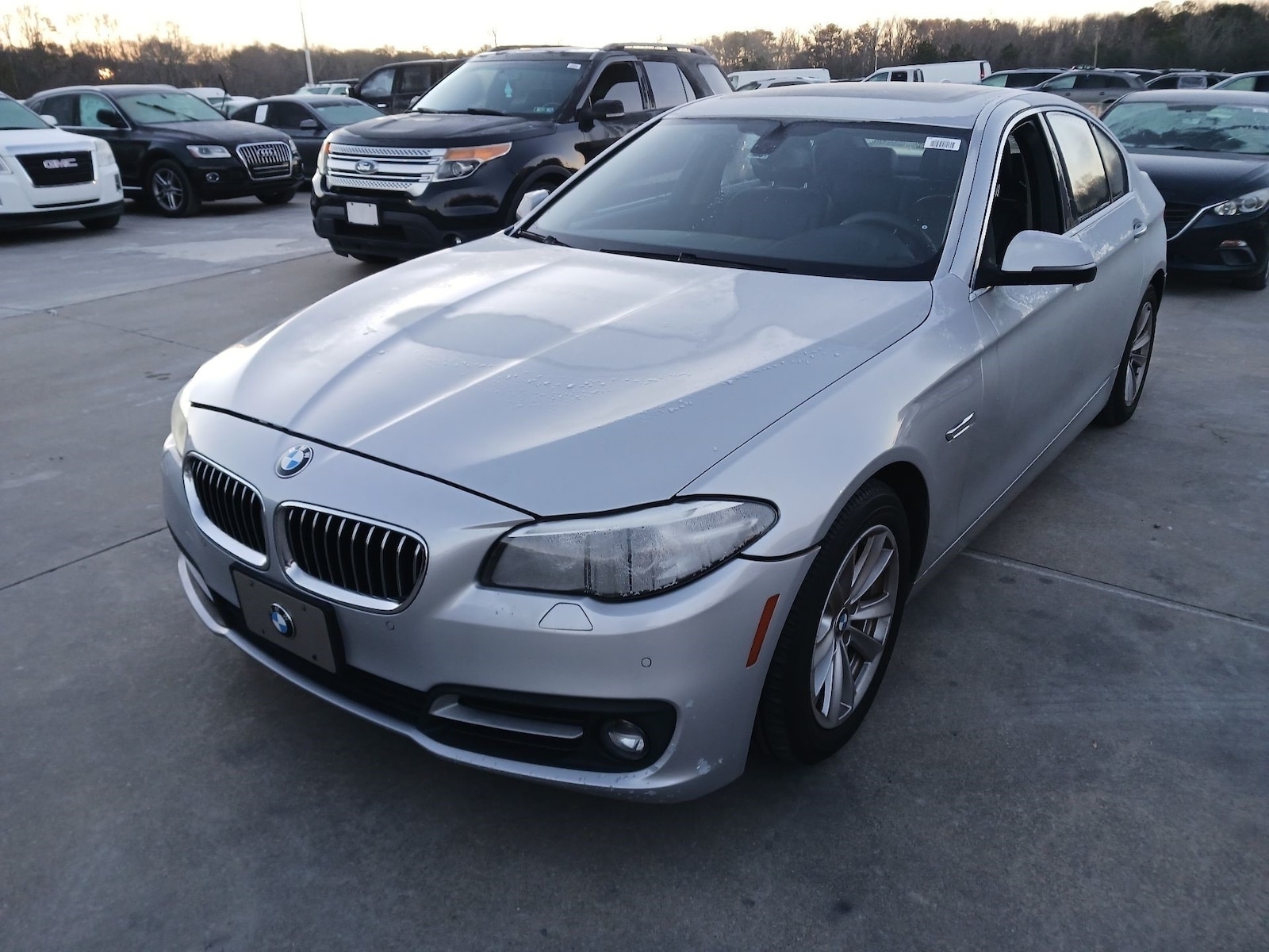

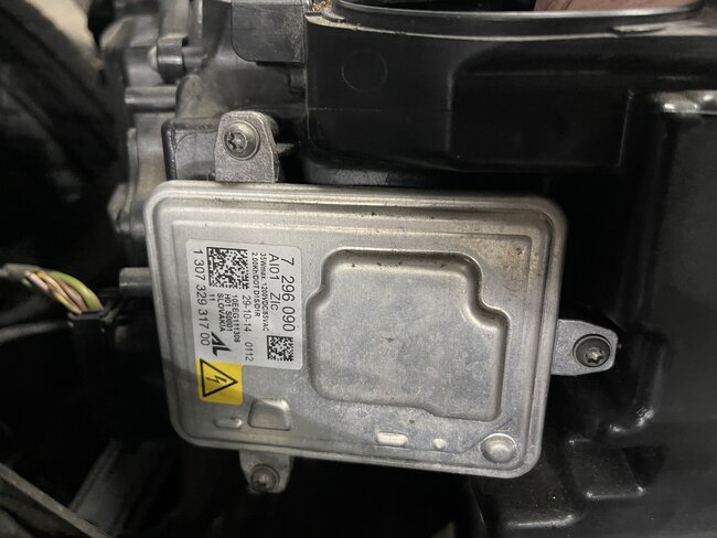

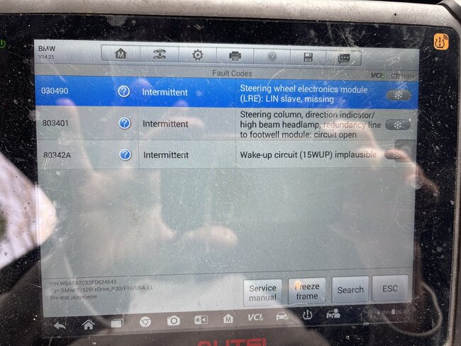

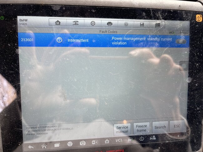

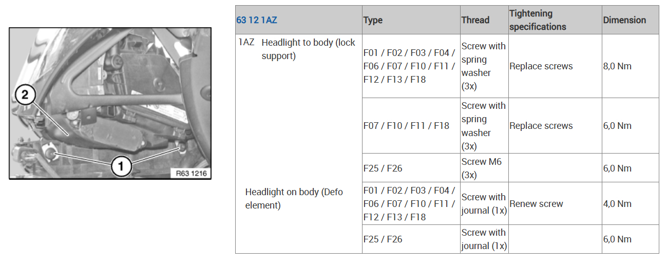

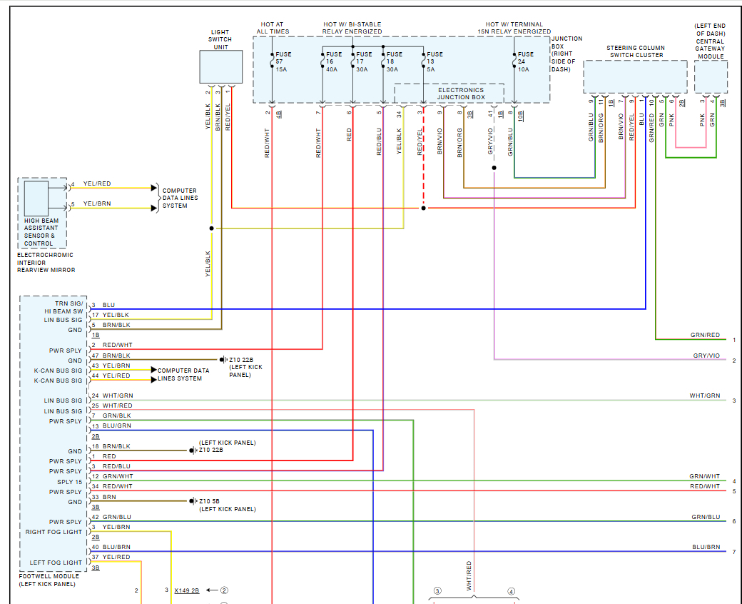

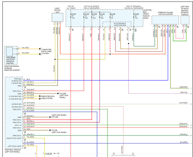

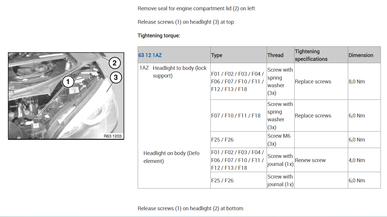

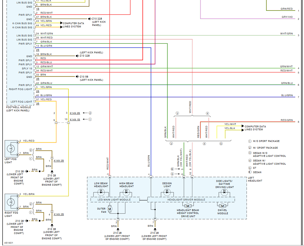

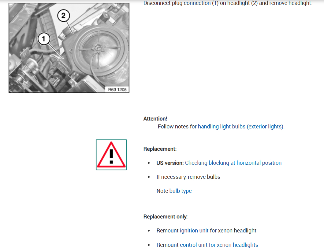

bought this 15 model AWD 528i. Only thing that works on the left light is the blinker. I also see moisture in it. Not sure if the whole light assembly would need to be replaced or some parts that control everything inside could be replaced. It had several codes first, deleted all and these only one that are/maybe related. I tried activating any of the lights on this left side and nothing came on.
