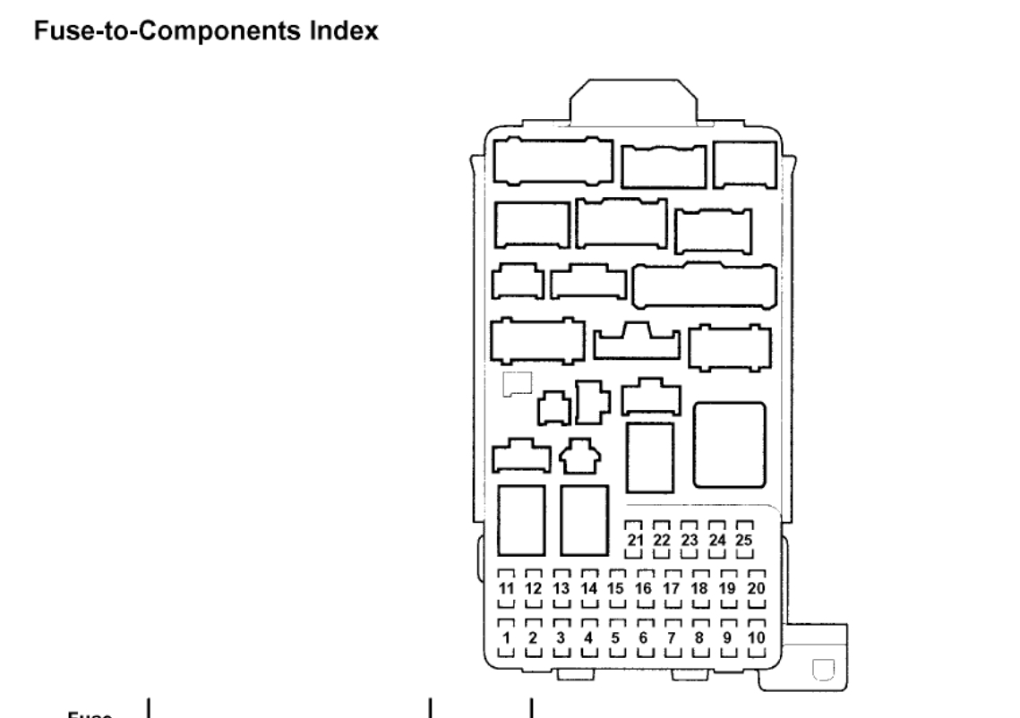

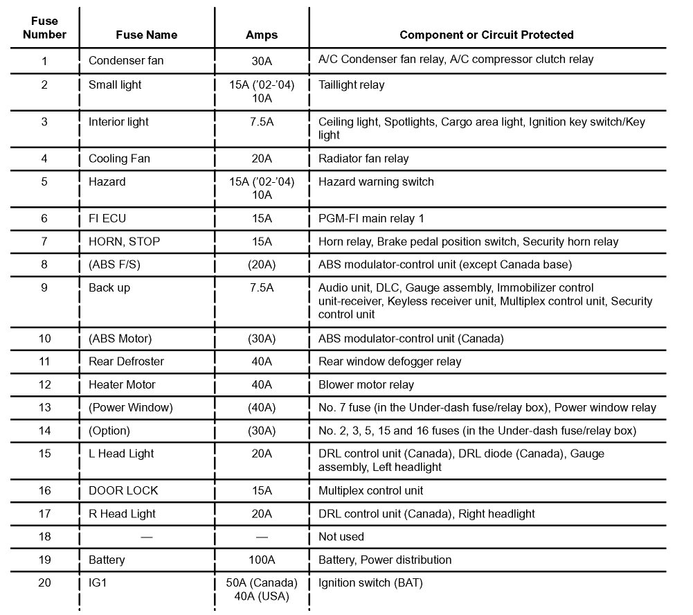

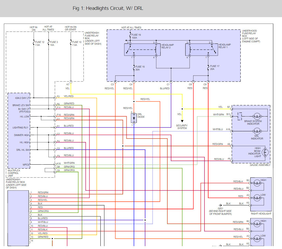

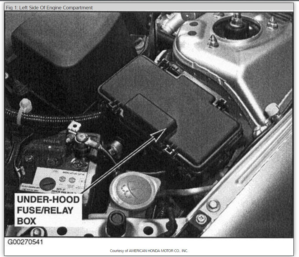

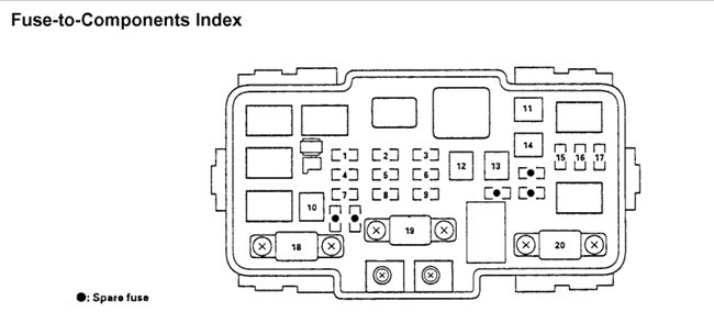

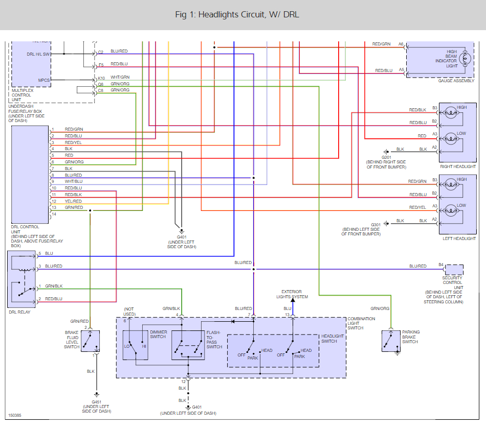

Headlights are not lighting up, except for passenger side high beam. DRL indicator light is on in the dashboard. Have tested fuses and relays for resistance and they are giving a resistance.
The tail lights and reverse lights work perfectly, as well as turn signals.
