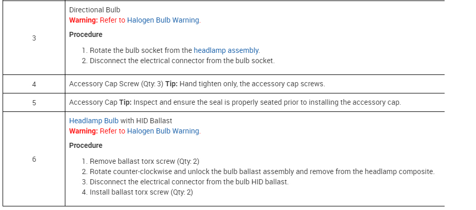

Are you able to get it to turn 1/4 turn? Once that is done, it should wiggle out.

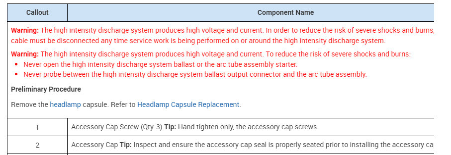

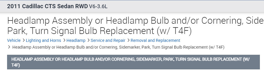

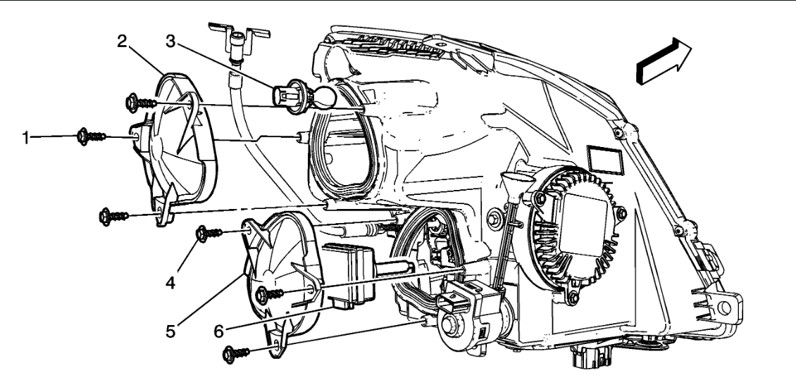

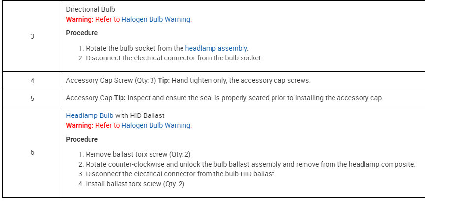

I attached the directions below. Take a look at them and let me know if they help.
See pic below.
