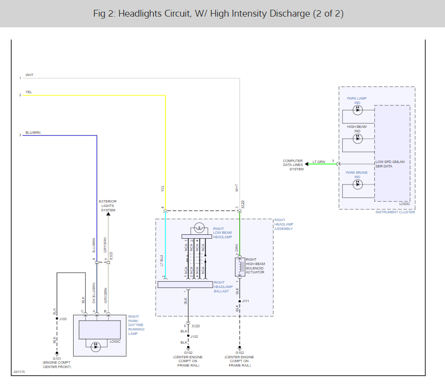

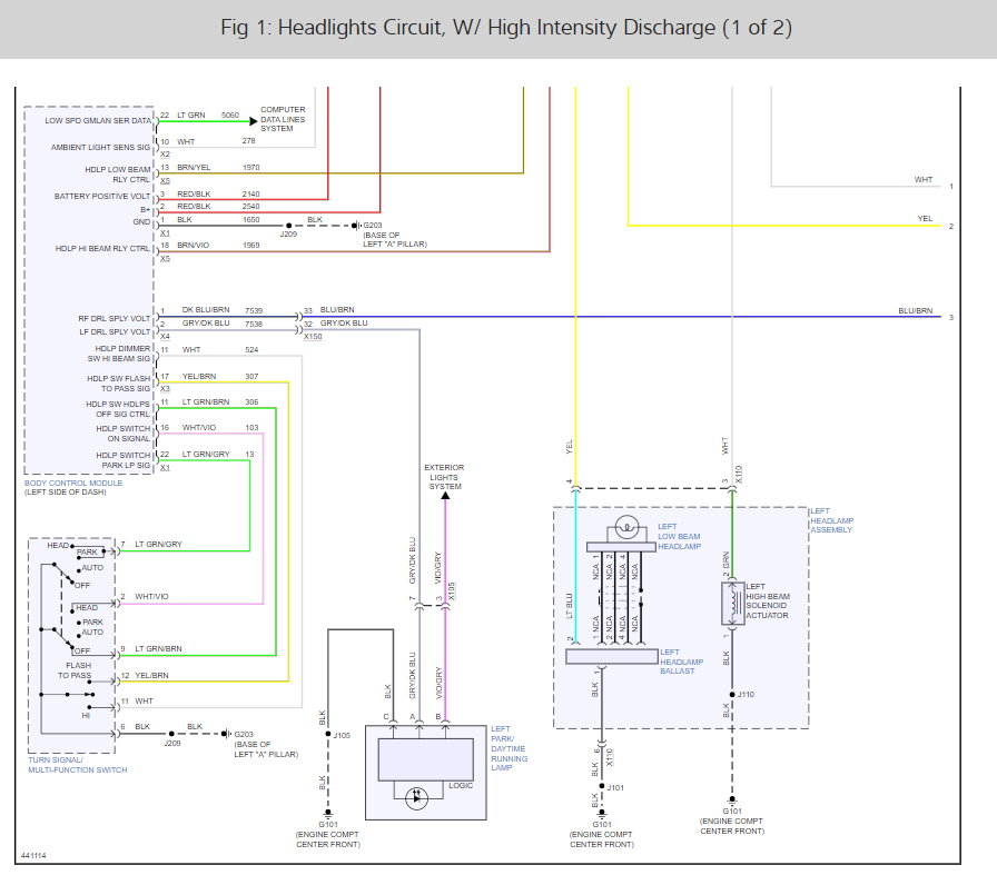

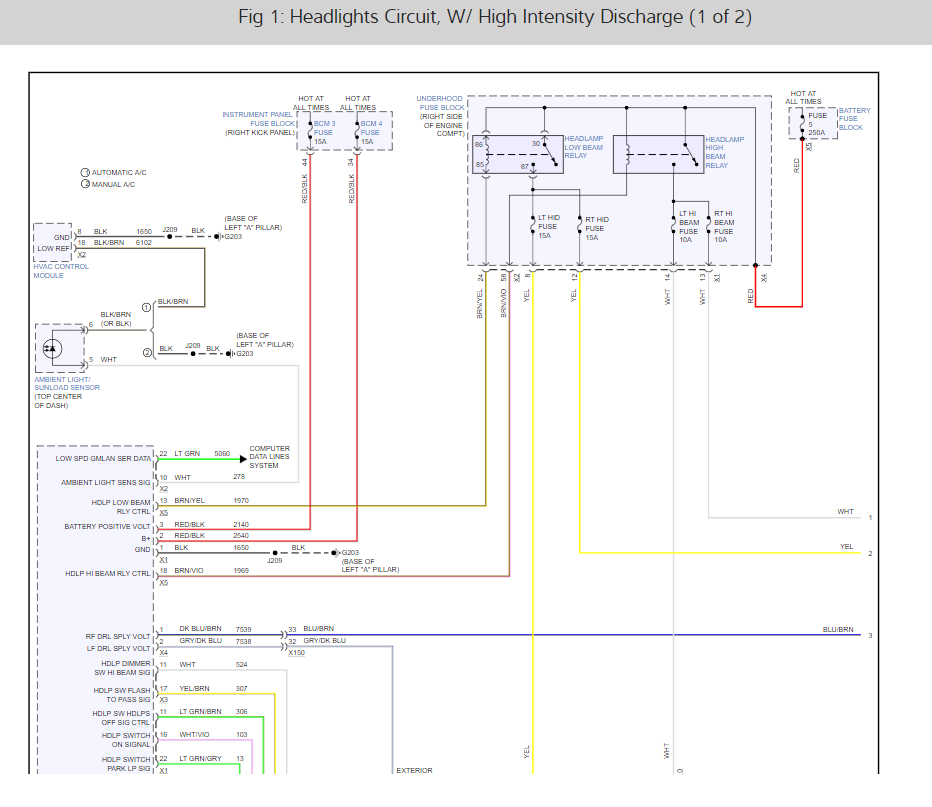

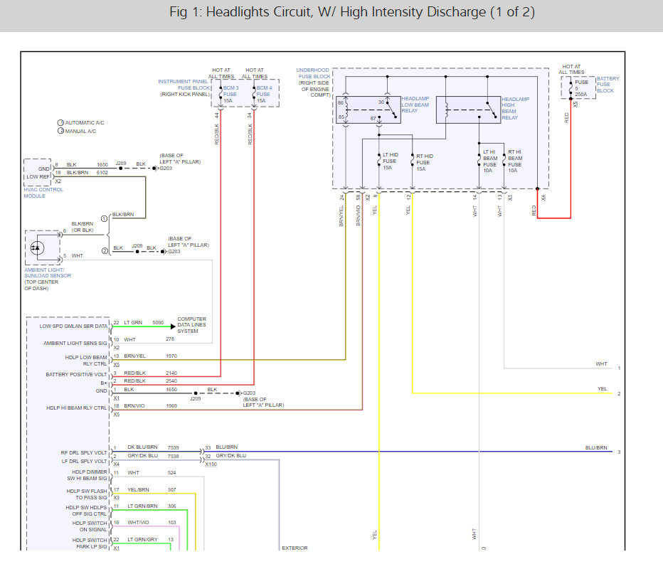

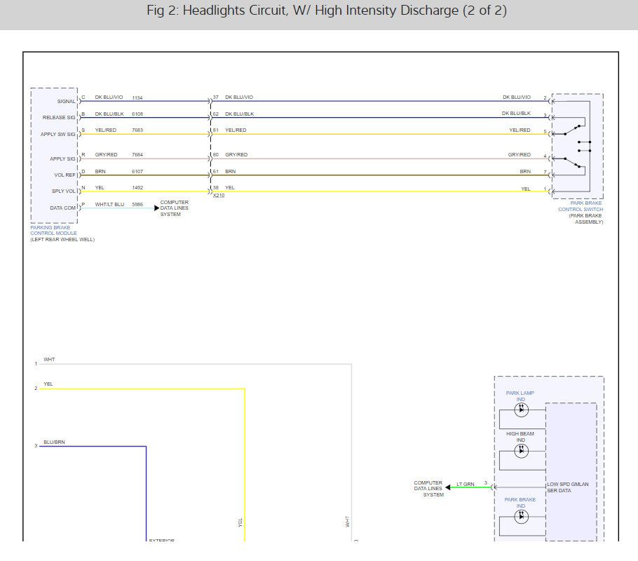

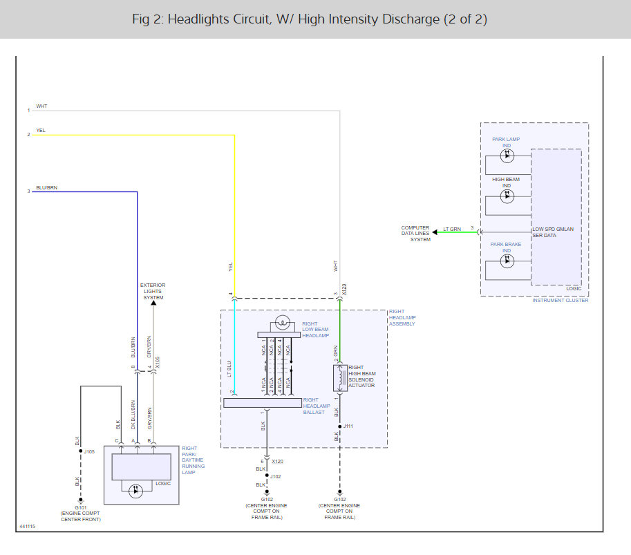

The wiring harness should be the same but the connector at the switch will be able to tell you, remove the switch to see if there are empty places where wires should be? Here are the headlight wiring diagrams so you can see how the system works. Check out the diagrams (below). Please let us know what happens.
