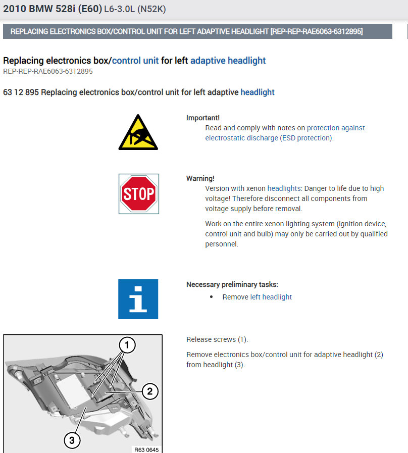

On this vehicle there is actually single led bulb for each headlight for the angle eyes.
So check that light as it could be bad.

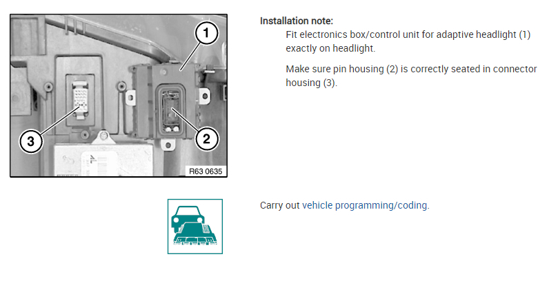

If the self leveeing function is not working it is due to the control module for that head light. It is located at the back of the headlight housing (see diagram below).

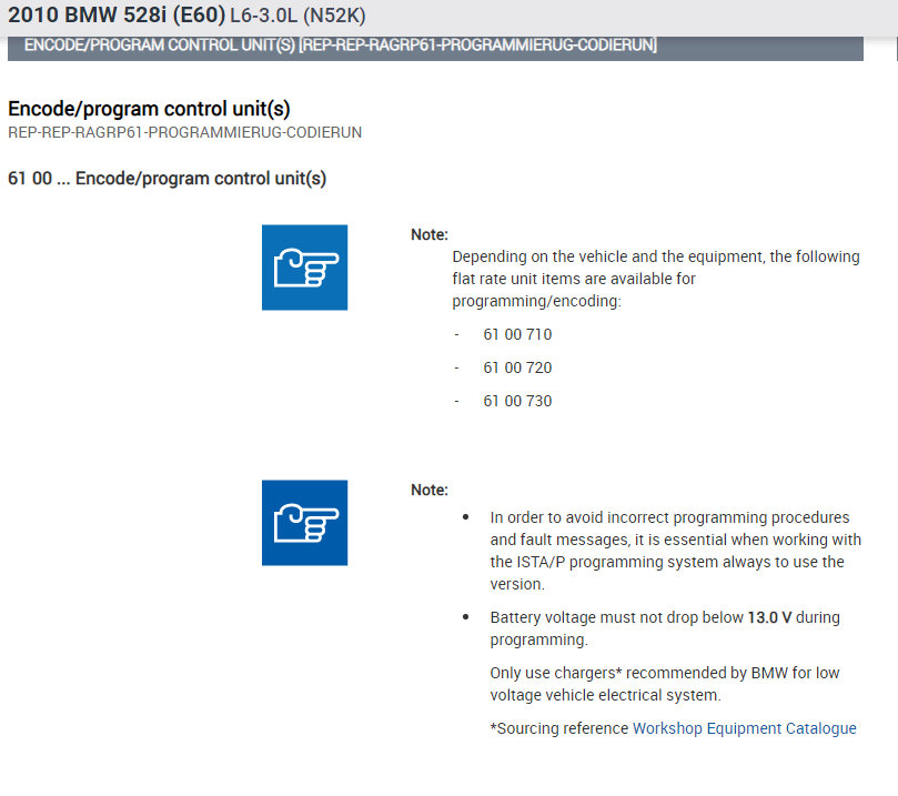

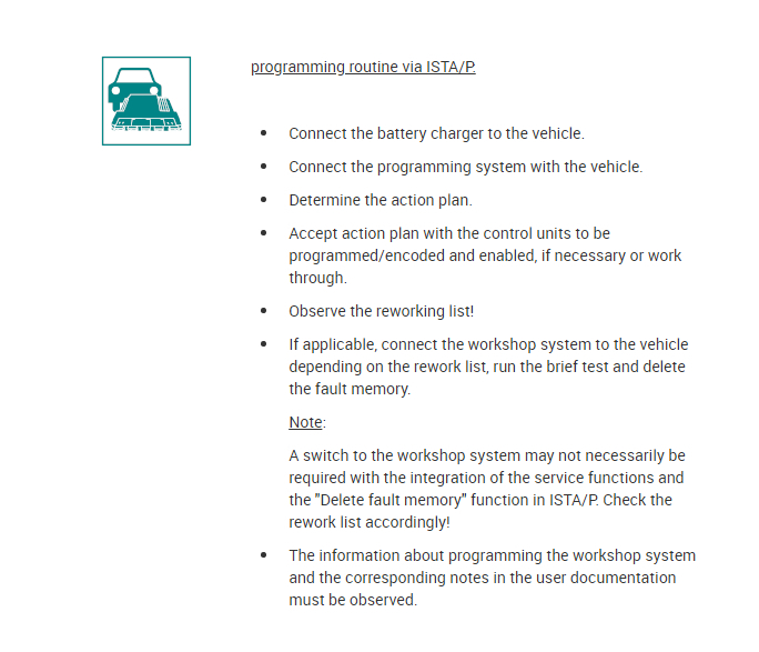

Please note that the module does need to be reprogrammed. I have induced the programming procedure for the module as well.
Thank you.
