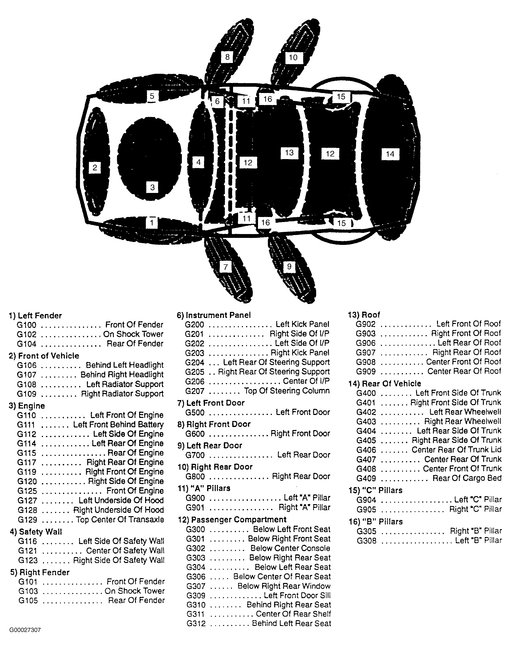

The Passenger side head light is dim and I need to know where to look to fix the ground wire problem both high and low beams are effected.

Your ground point is G201 #6 Right side of I/P

On the passenger side fender is the ground for the passenger headlight

That's what my reference says above-so go ahead and try that ground

You need to find that ground, it is very important that you do. I believe it goes through the dimmer switch.
