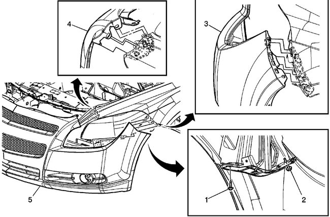

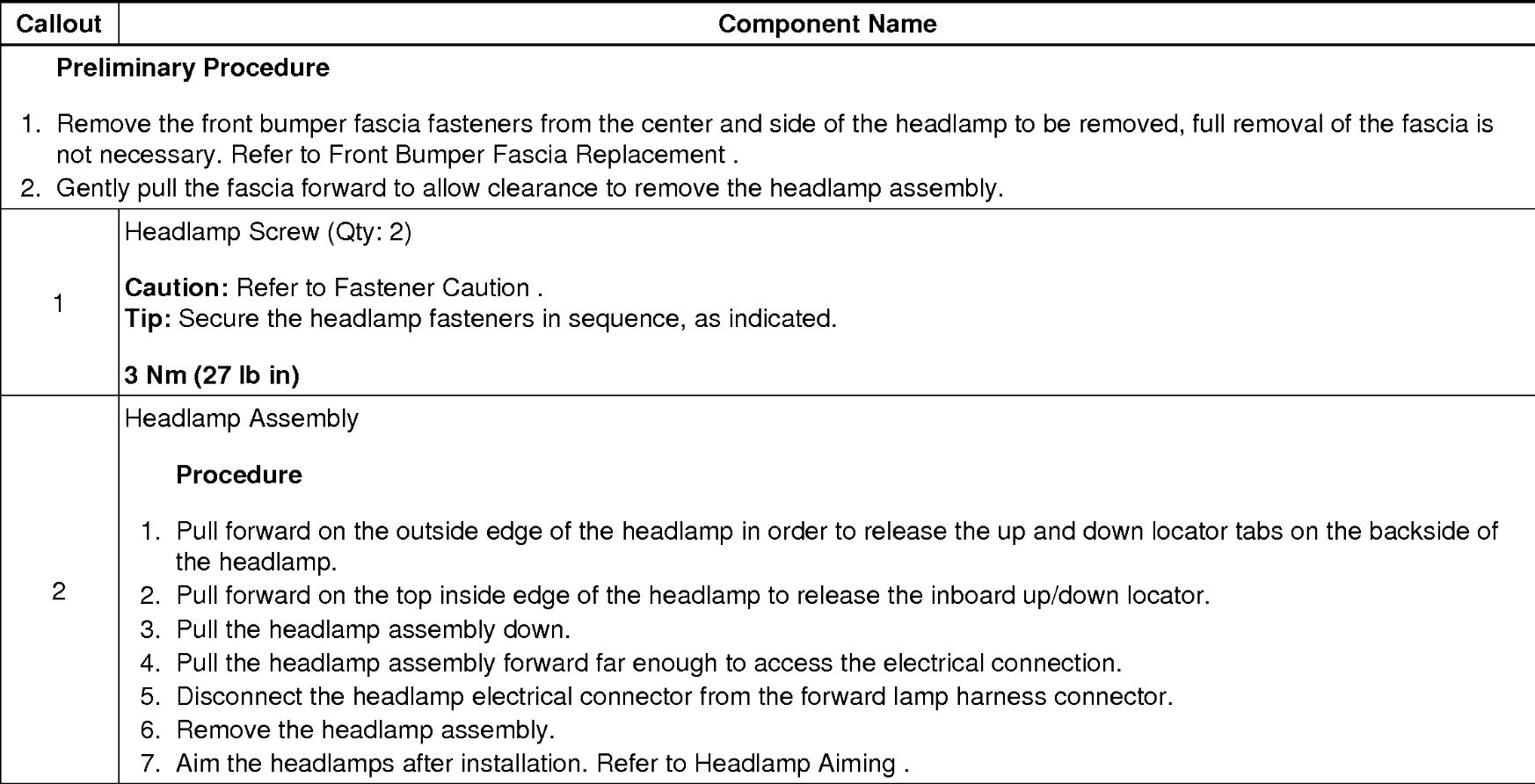

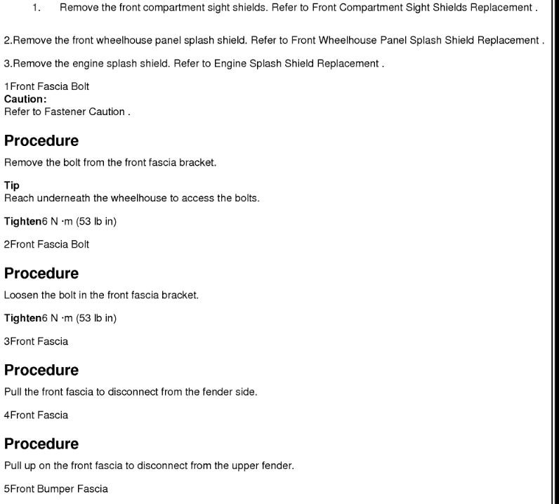

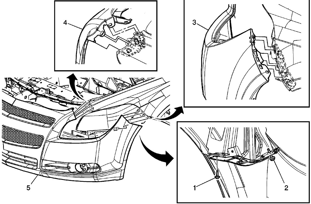

How do you replace the headlight bulb on the car listed above?
Mar 7, 2020 at 9:58 AM
STEVE W.
  • 15,113 POSTS
The easiest way is to trade the car in. LOL.
GM didn't do anyone a favor on the Malibu. You need to remove the front bumper cover assembly to get to the headlight mounting bolts so you can remove the housings to change the bulbs. You can do one side or make life easier and remove both sides and replace all of the headlight bulbs at once. That way if the new bulb is brighter or a different color output like bright white or one of the high performance types both sides match.
Mar 7, 2020 at 1:26 PM

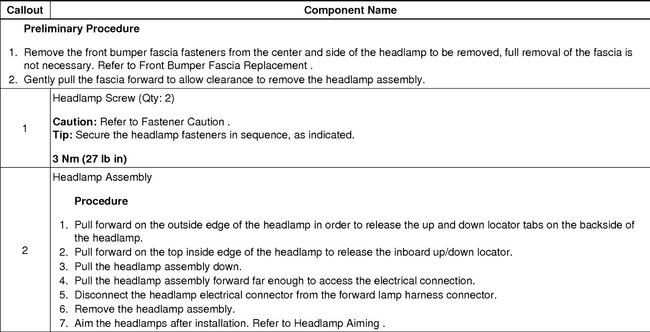

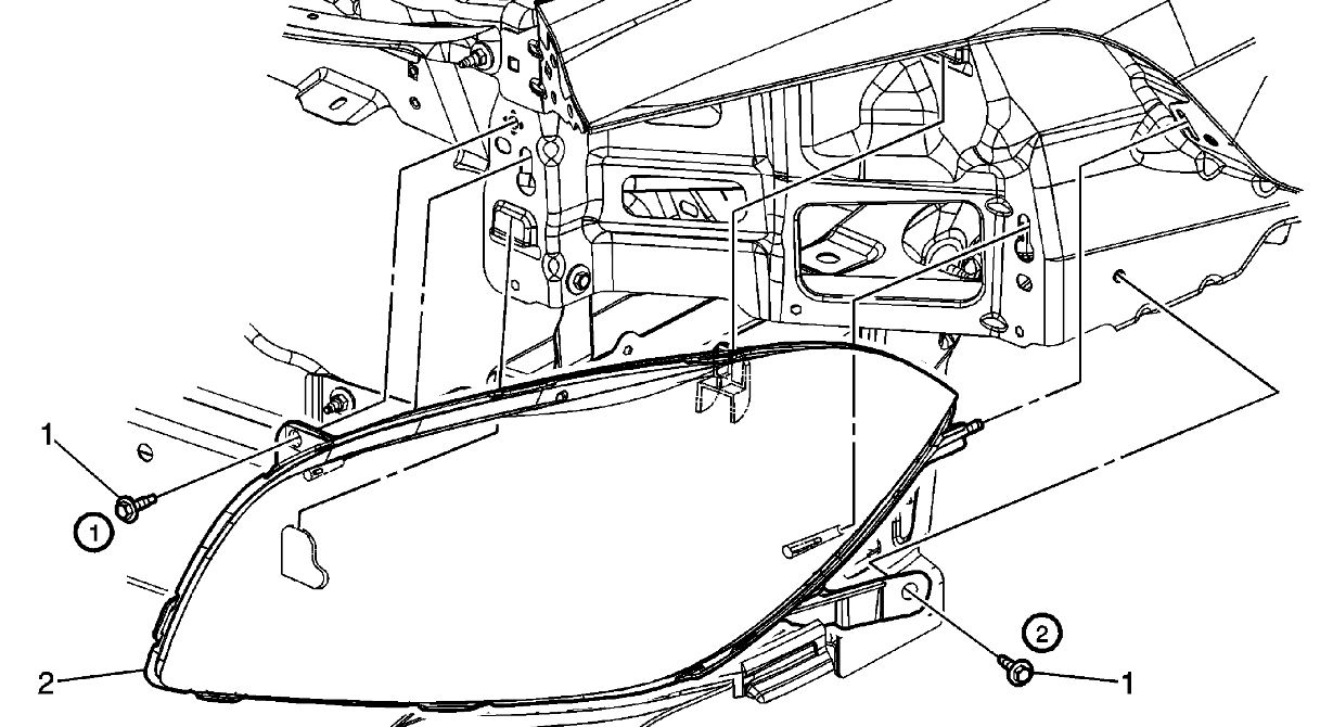

How do I replace my driver's side low beam headlight?
Jan 11, 2021 at 11:16 AM (Merged)
JDL
  • 16,098 POSTS
https://www.2carpros.com/forum/automotive_pictures/170934_headlamp_2.jpg
https://www.2carpros.com/forum/automotive_pictures/170934_headlamp_11_1.jpg
Hello, I found the above info in an owners manual.
