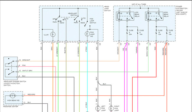

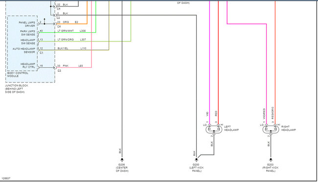

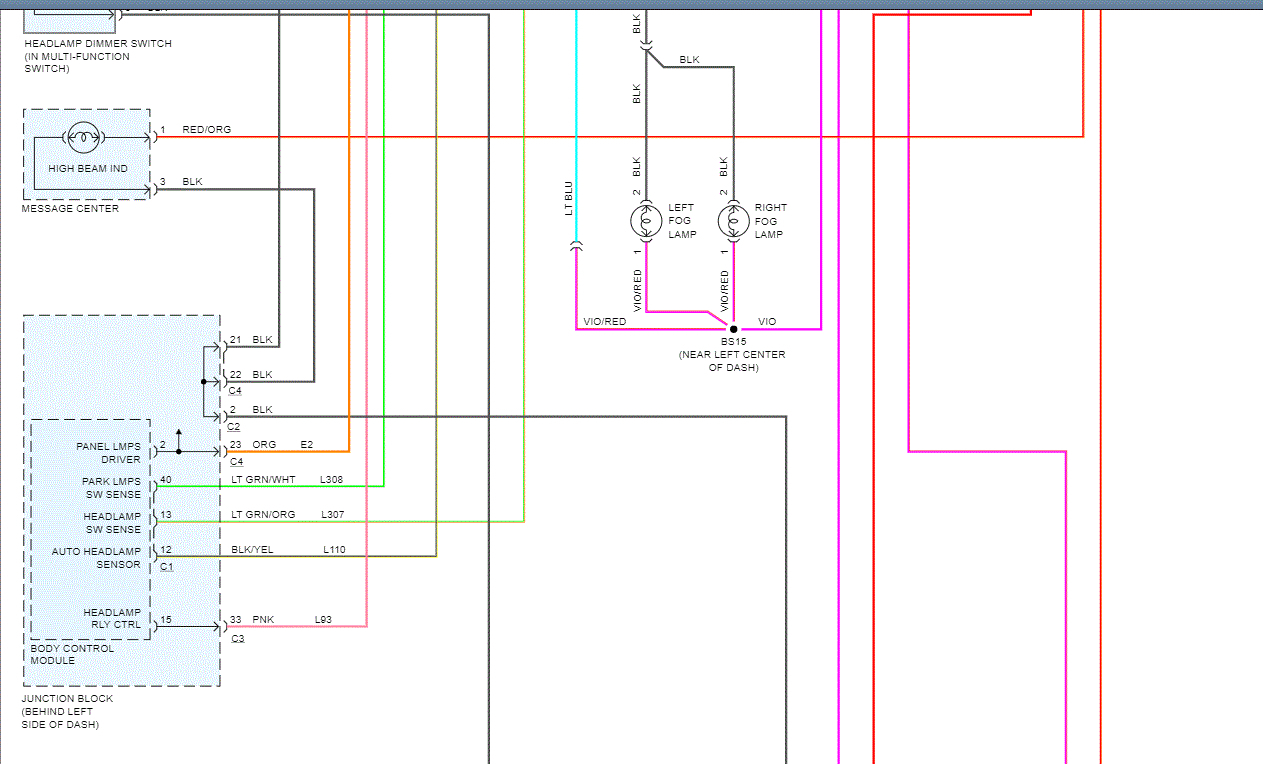

Here are the directions specific to your vehicle:
____________________

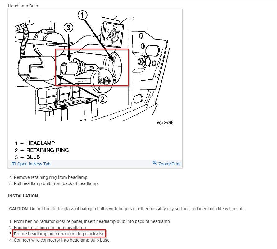

2000 Dodge or Ram Truck Grand Caravan FWD V6-3.3L VIN R
Procedures
Vehicle Lighting and Horns Headlamp Headlamp Bulb Service and Repair Procedures
PROCEDURES
REMOVAL

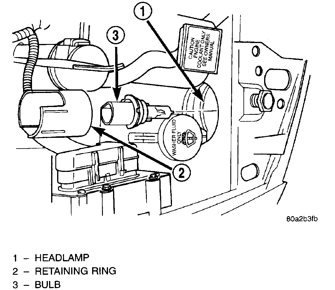

1. Release hood latch and open hood.
2. From behind radiator closure panel, disconnect wire connector from back of headlamp bulb base.
3. Rotate headlamp bulb retaining ring counter-clockwise.
Headlamp Bulb
Pic 1
4. Remove retaining ring from headlamp.
5. Pull headlamp bulb from back of headlamp.
INSTALLATION
CAUTION: Do not touch the glass of halogen bulbs with fingers or other possibly oily surface, reduced bulb life will result.
1. From behind radiator closure panel, insert headlamp bulb into back of headlamp.
2. Engage retaining ring onto headlamp.
3. Rotate headlamp bulb retaining ring clockwise.
4. Connect wire connector into headlamp bulb base.
If the bulb doesn't want to fit fully into the housing, make sure the o-ring hasn't stuck in the light assembly (some of these didn't have one). Also, if you look at the bulb, you will notice the tabs that push in are different sizes. Make sure it is in the correct position.
Let me know if this helps or if you have other question.
