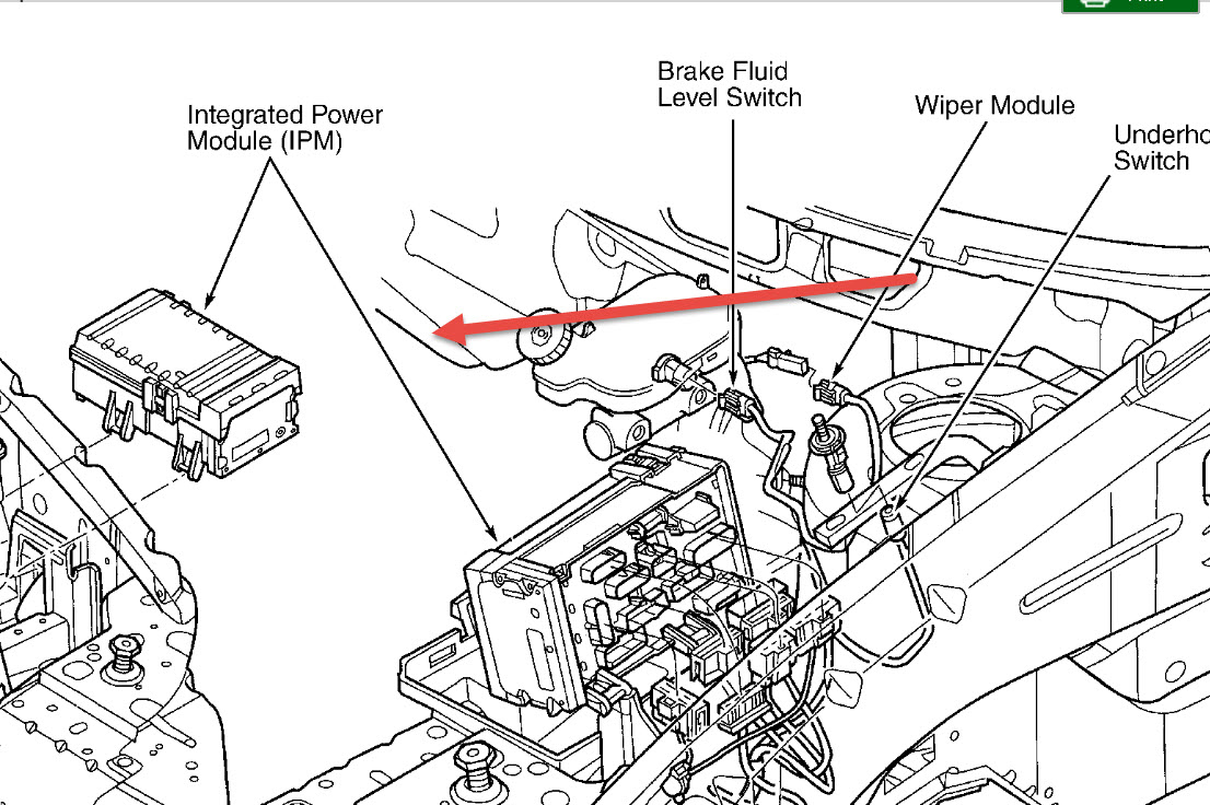

What does a headlight control module look like?

the headlights operate through the body control module and what is referred to as the TPIM module under the fuse box under hood that is probably what you want. they have to be programmed to your car by a mechanic to work. see pic
Image (Click to enlarge)
