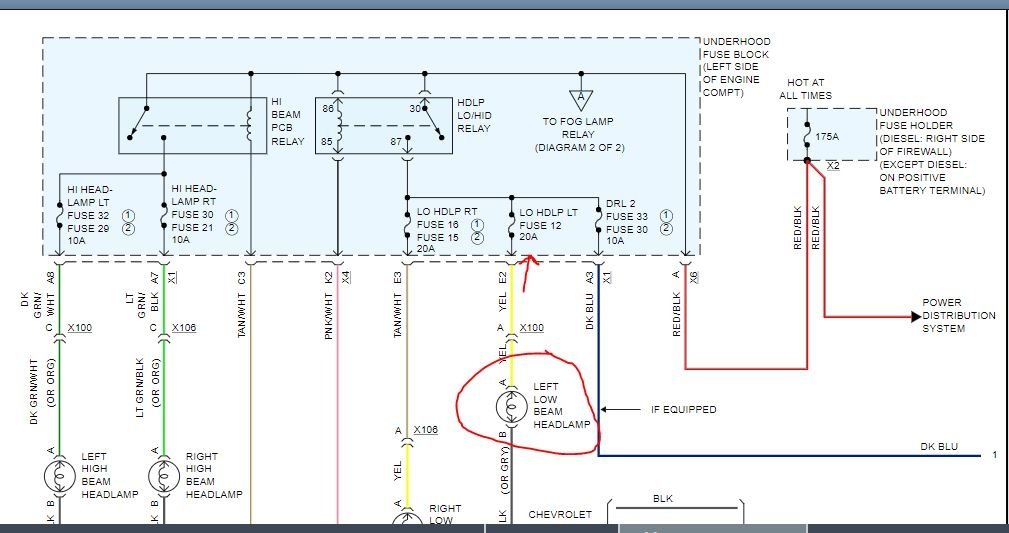

It has its own fuse. Have you checked that? I attached a pic from the wiring schematic showing fuse and location. Check that first and let me know what you find. Also, check for power in the yellow wire to the low beam. There should be 12v.
