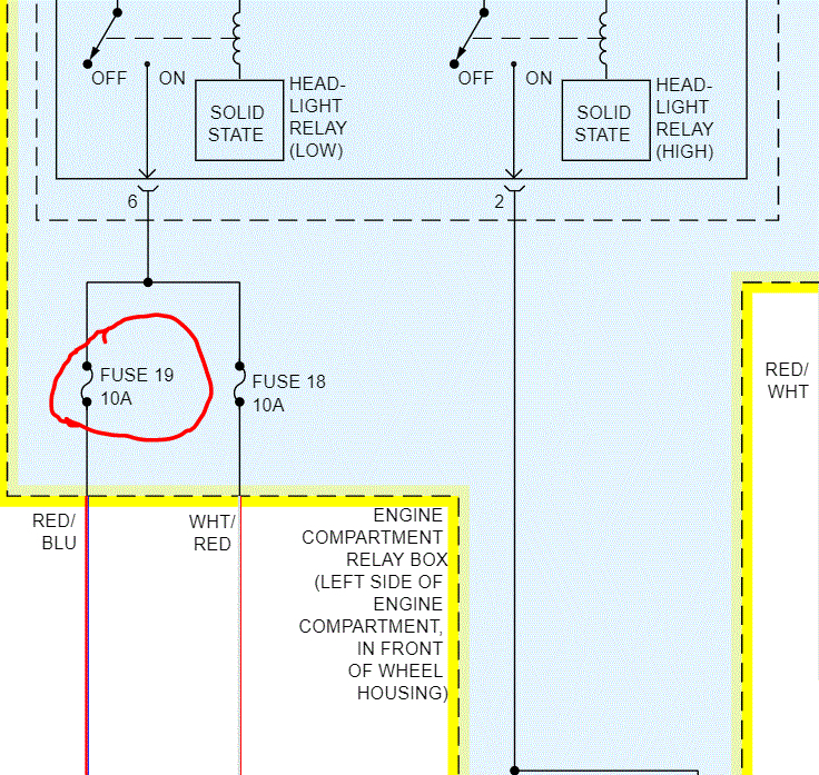

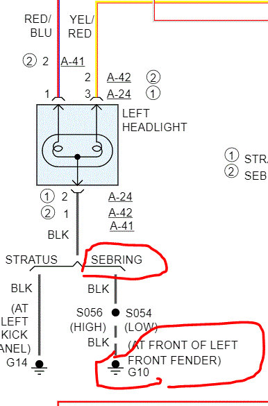

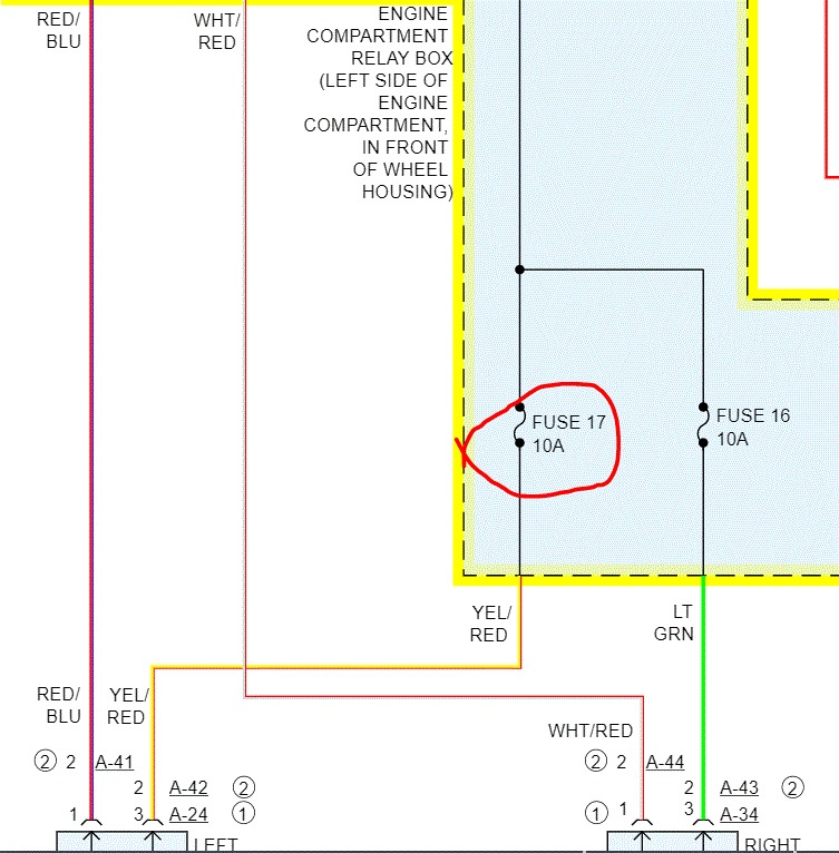

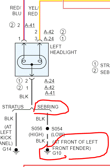

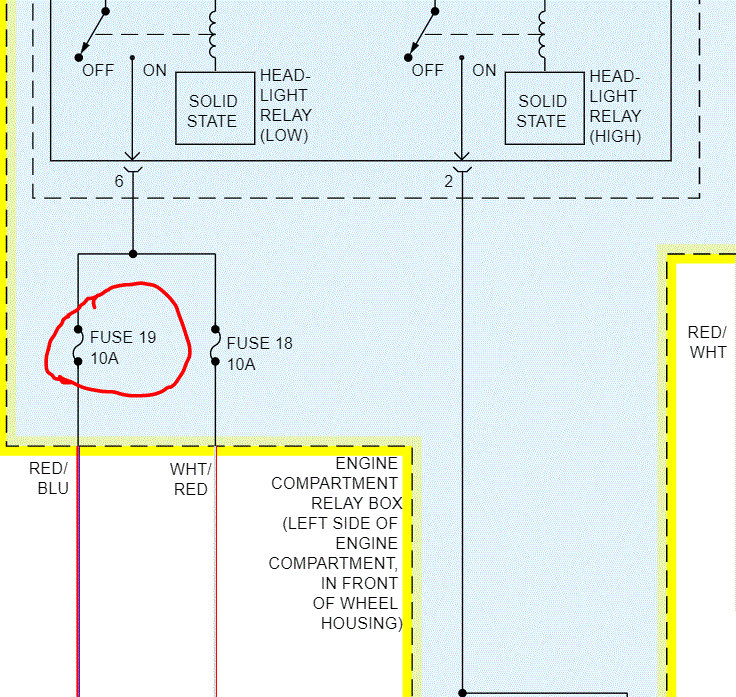

A dim light usually is indicative of a poor ground. First, since the high beam on the left isn't working, are you certain the bulb is good? Next, I attached two pics below. I need you to check both fuses indicated.
If the fuses are good, check that the black wire from the socket has a good ground. See pic 3 for ground location.

Hi Joe. thanks . i checked the fuses, all are good. not sure about the ground. i disconnected the main ground from the battery. can't seem to find the ground from the light. would it be grounded to a bolt or screw on the fender?
Feb 22, 2020 at 8:10 AM
Yes it should be screwed to the body. If you can't find it, simply run a jumper wire from the light socket ground directly to the battery negative to see if it chances things. If it does, then we know the problem.
