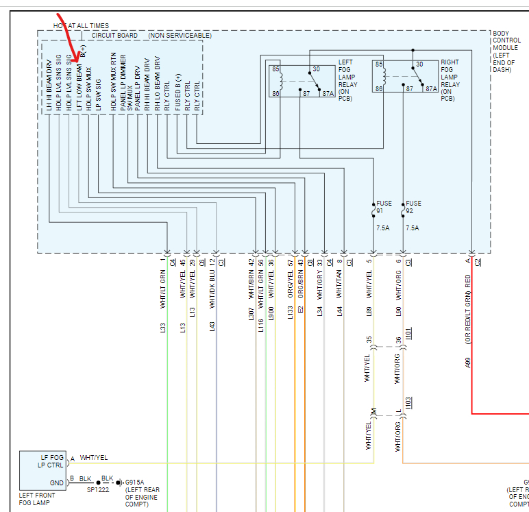

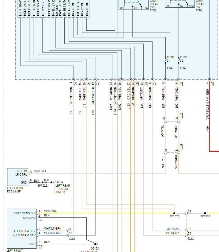

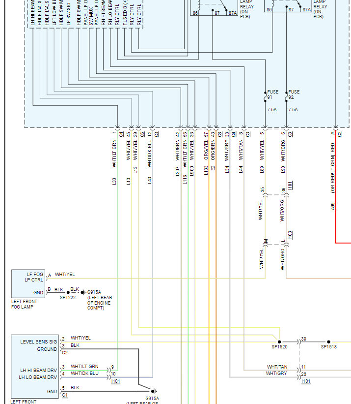

Can I ask if the high beams work on both sides? If so, let's check for power at the wht/drkblu wire at the connector, also let's check the blk wire for ground this guide can help.
If you don't have power and the ground is good chances are the BCM is going out, but did you look at the headlight bulb electrical connector? Sometimes they can burn and cause a bad connection. To confirm the BCM failure you will need to do a CAN scan. You can get a CAN scanner (Controller Area Network) which will work on most cars from Amazon.

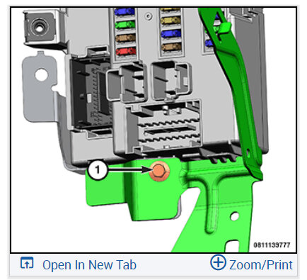

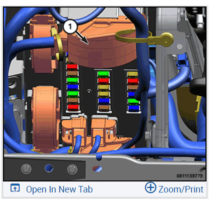

Or you can send the BCM to be tested and if found bad they can rebuild the unit for you. Here is the location of the BCM and how to change it out. Also, I have included the wiring diagrams for the left headlight so you can see how the system works.

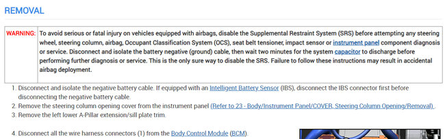

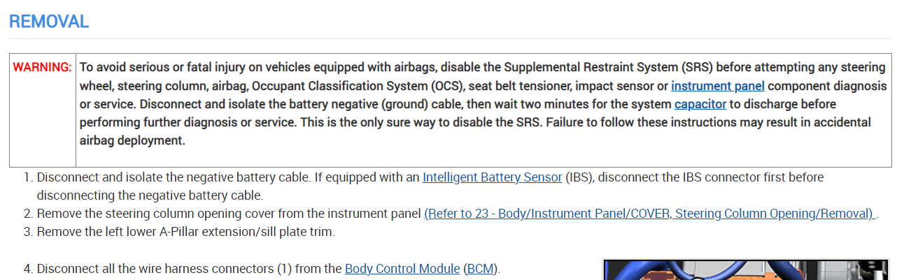

Disconnect and isolate the negative battery cable. If equipped with an Intelligent Battery Sensor (IBS), disconnect the IBS connector first before disconnecting the negative battery cable.
Remove the steering column opening cover from the instrument panel (Refer to 23 - Body/Instrument Panel/COVER, Steering Column Opening/Removal).
Remove the left lower A-Pillar extension/sill plate trim.

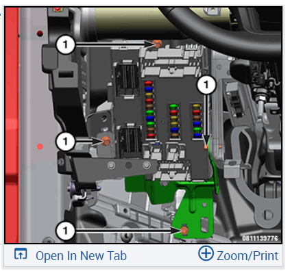

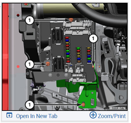

Disconnect all the wire harness connectors (1) from the Body Control Module (BCM).
Remove the fasteners (1) that secure the BCM brackets to the instrument panel carrier, outboard of the steering.

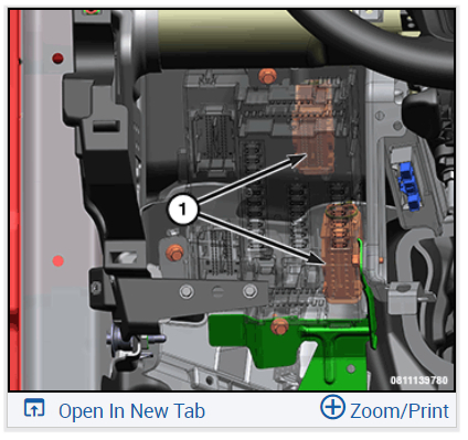

When removing the BCM, disconnect the wire harness connectors (1) from the back of the BCM.
Remove the BCM to bracket mounting fastener (1).
If necessary, separate the BCM from the bracket.
