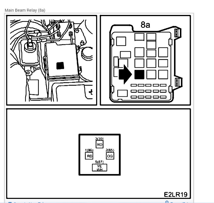

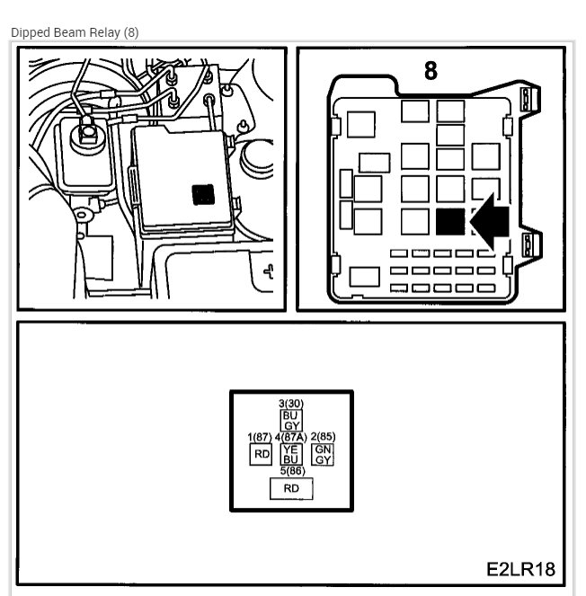

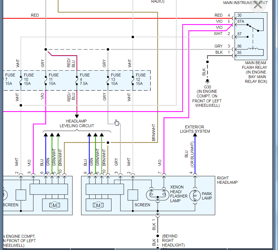

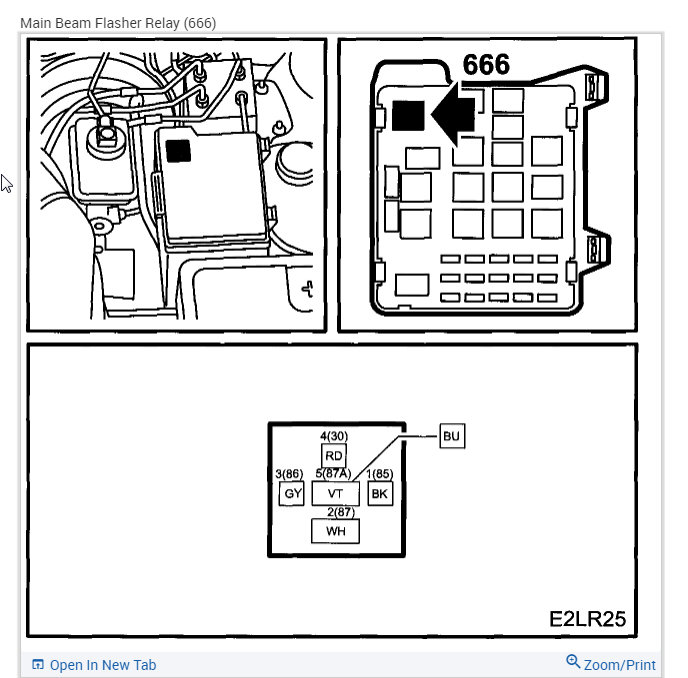

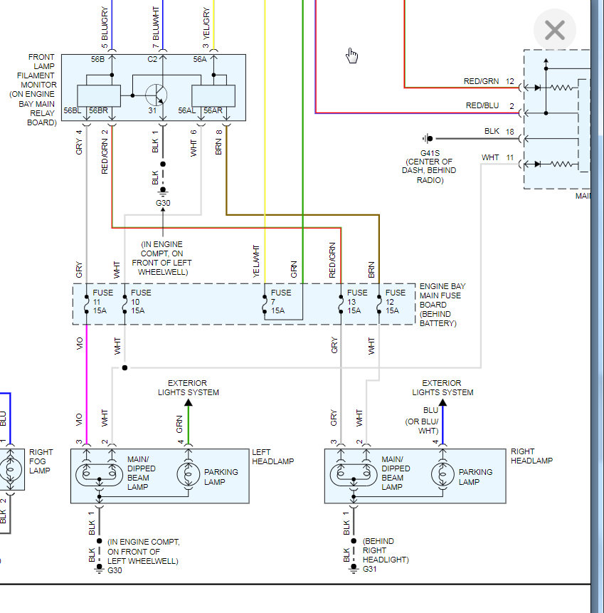

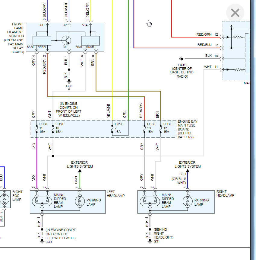

Which relay is for headlights?
Nov 12, 2019 at 3:42 AM
CERTIFIED EXPERT
18,907 POSTS
The first wiring diagram is for Xenon lamps and the second is without. Then the rest of the attachments are the various relays. Let me know if you have any other questions. Thanks
