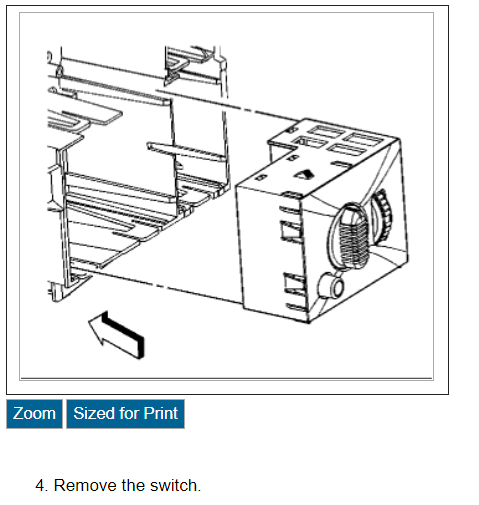

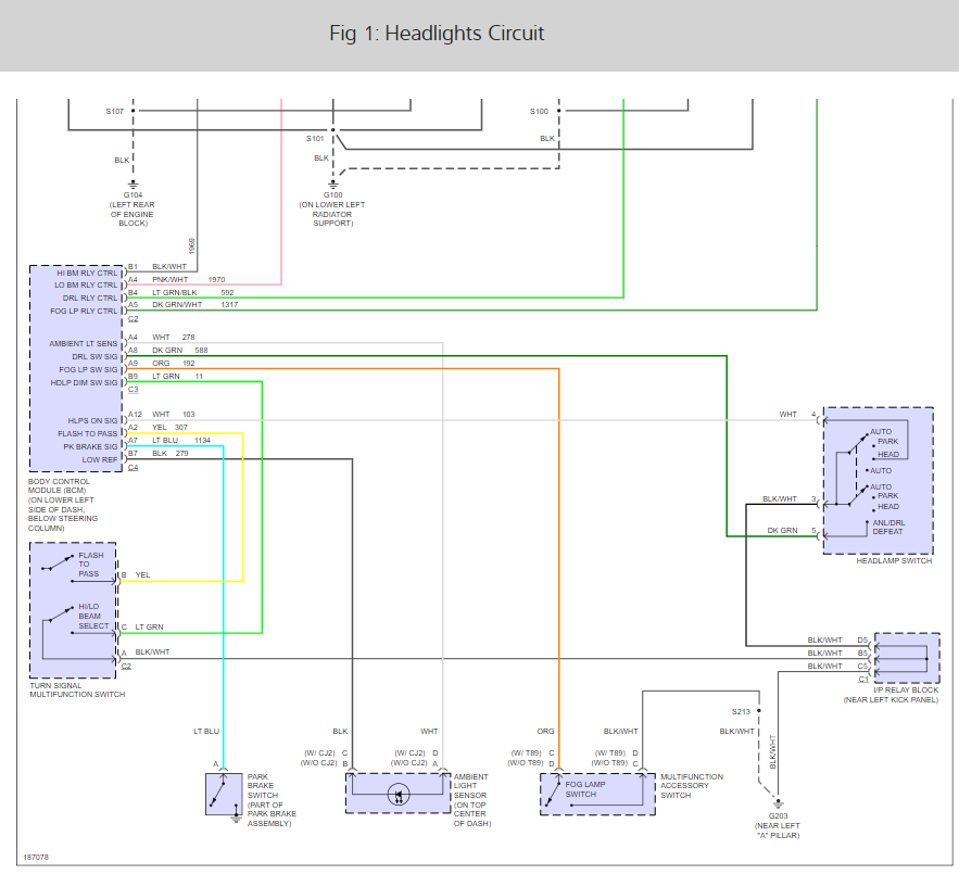

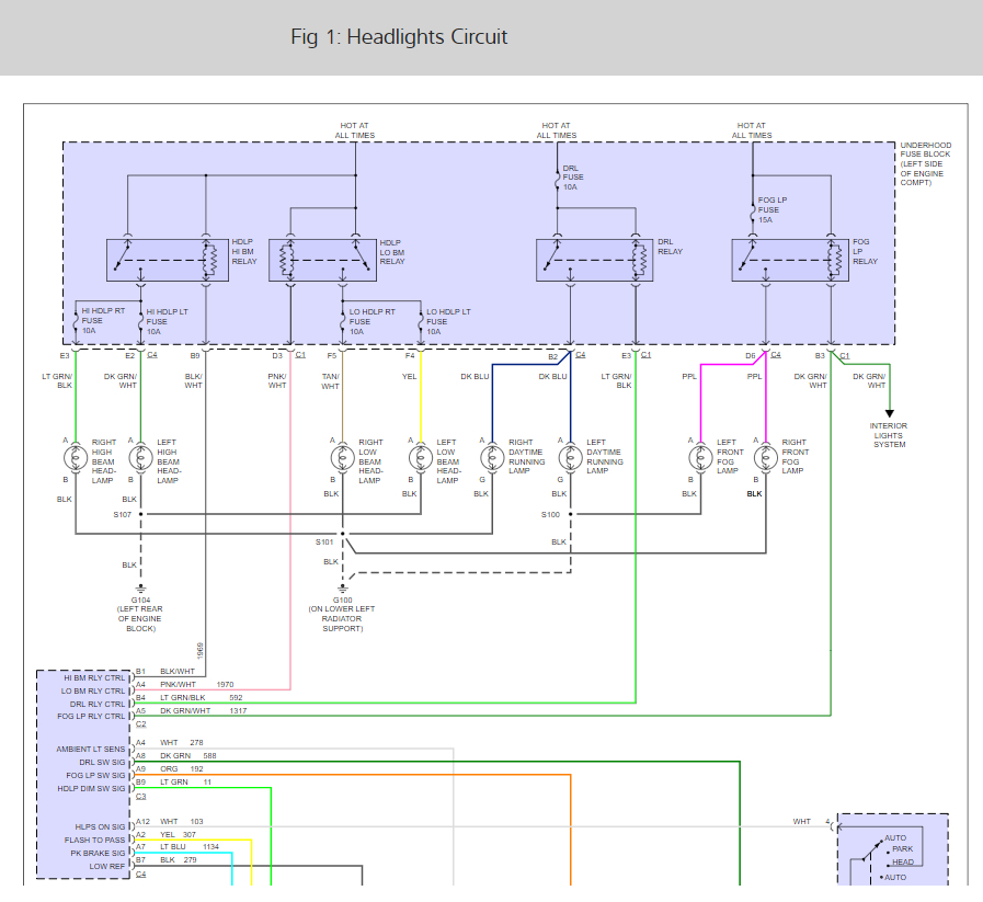

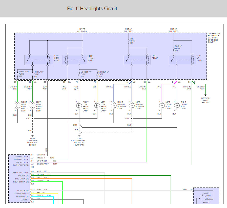

It sounds like the headlight switch is not working right or th BCM is having an issue. Let test the headlight switch first by following this guide and using the headlight wiring diagram below.
Test through the switch. Check out the diagrams (below). Please let us know what you find. We are interested to see what it is.

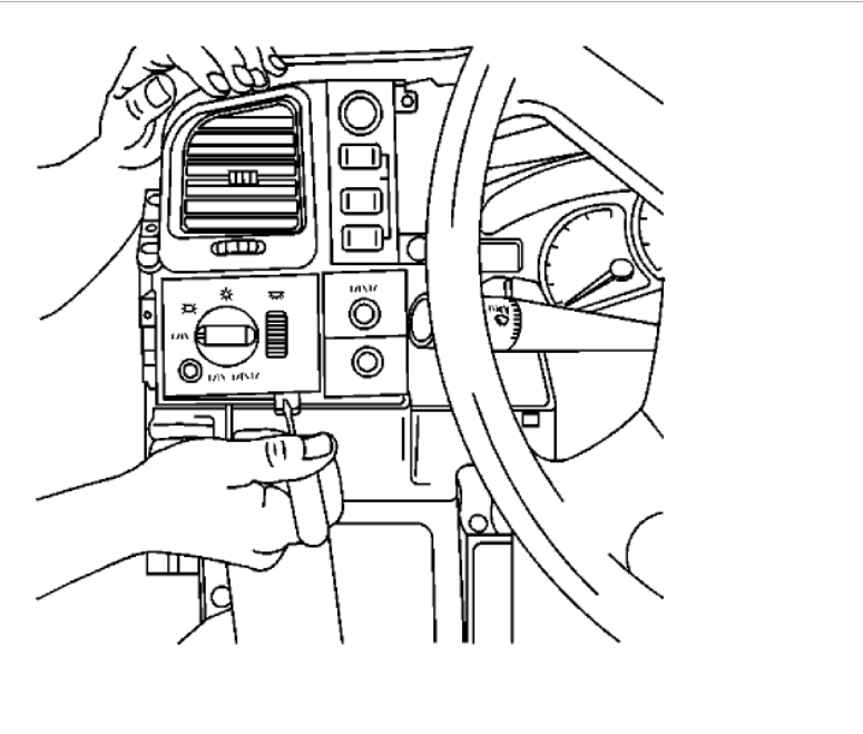

I had a thought as well that the multi-function switch can be out as well FYI. Use this guide to help test through the switch to confirm:
