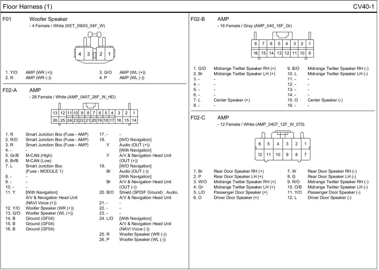

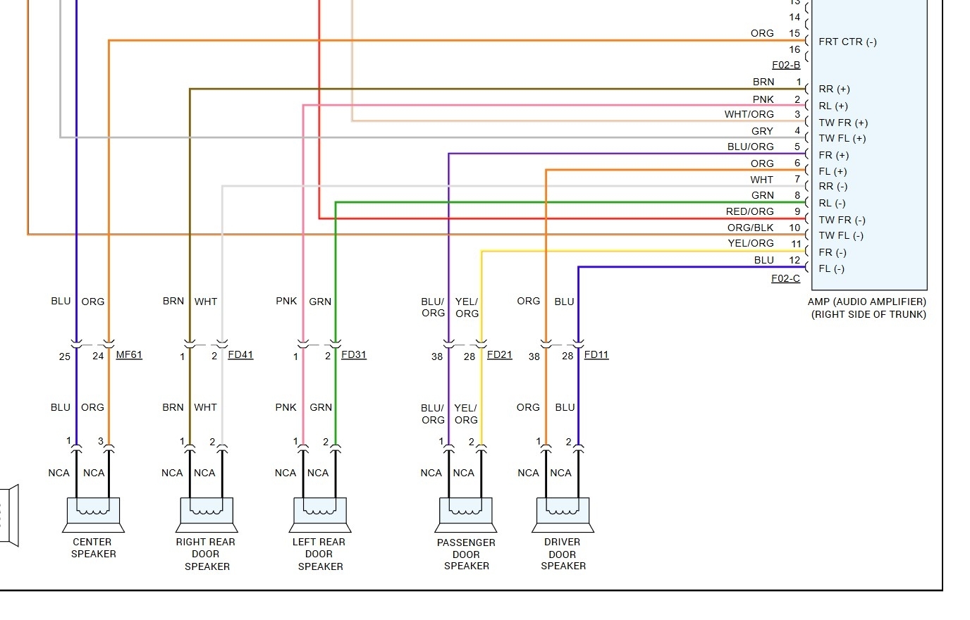

To narrow it down to the amp or something in the interface, the easiest way would be to go to the factory amp and use a speaker to test the outputs directly. I doubt that all the speakers failed, possible but doubtful. So, take the speaker you are going to use and connect it between like pairs. So, to test the right front you would connect to FR+ and FR- for the left rear it would be RL+ and RL- I would look at the back of the connector, you might be able to just slip the wires into the back of it to test. If say you get sound at the amp but not at its installed speaker then you would need to get to that speaker, but I sort of doubt that is the issue. The SPDIF unit doesn't really show how it gets the audio from the head unit, does it plug in to the audio output jacks as individual connections? The install book doesn't show it.
