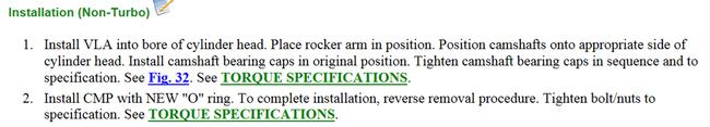

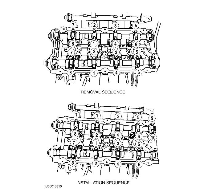

torque caps in sequence to 106 inch lbs. see pic for instructions. this is for a non turbo engine
