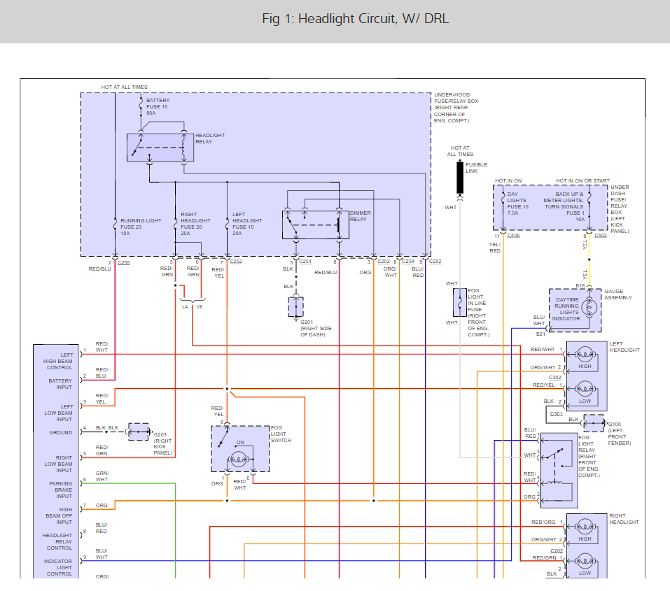

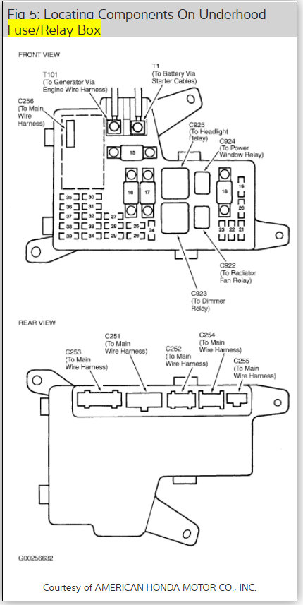

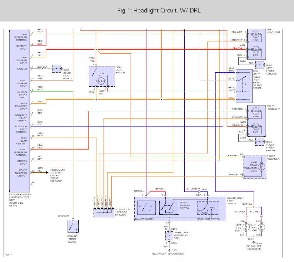

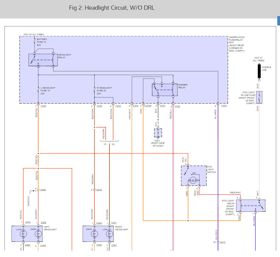

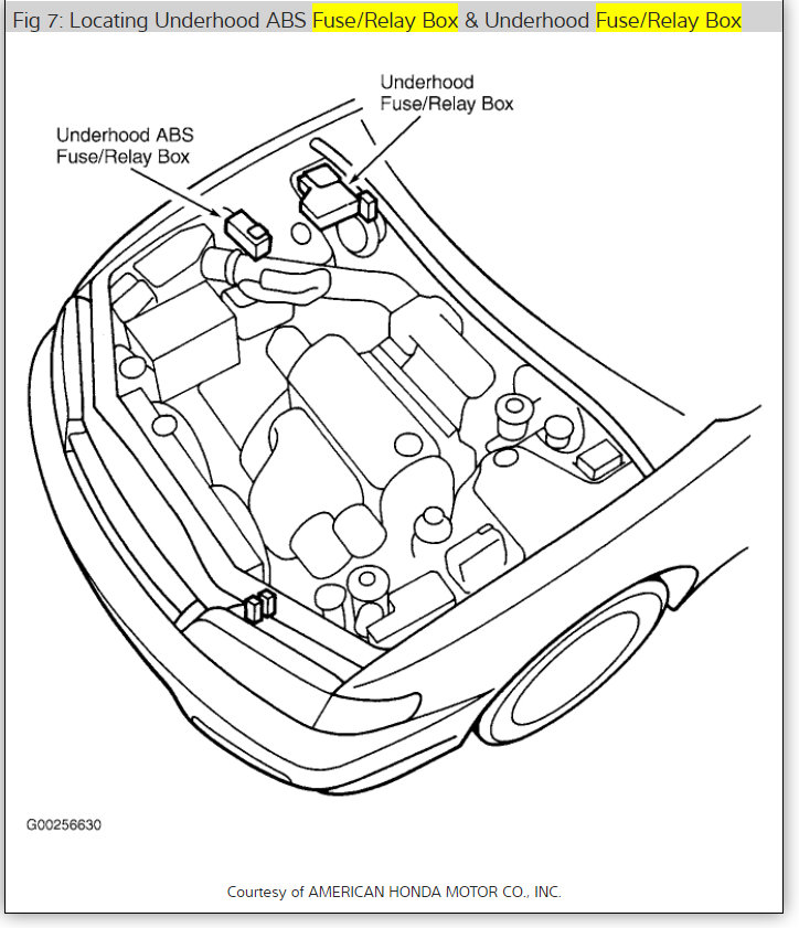

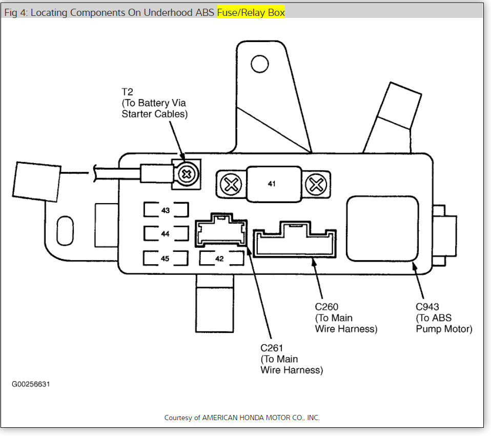

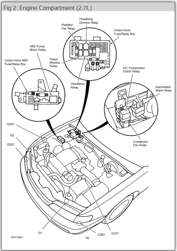

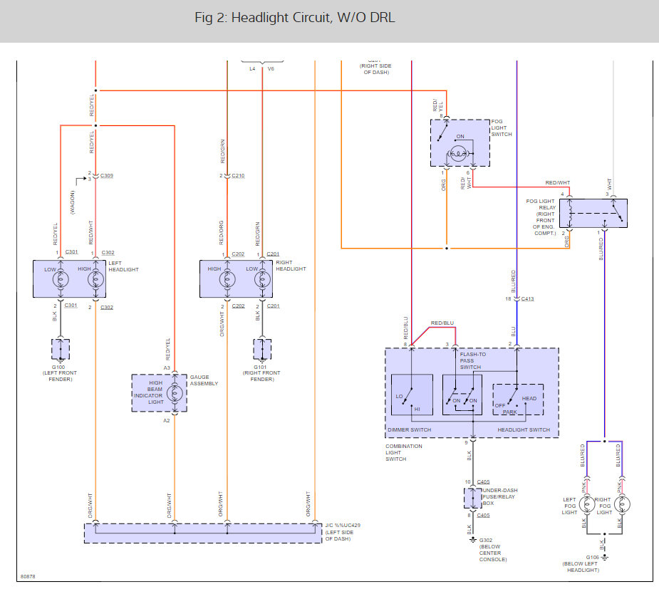

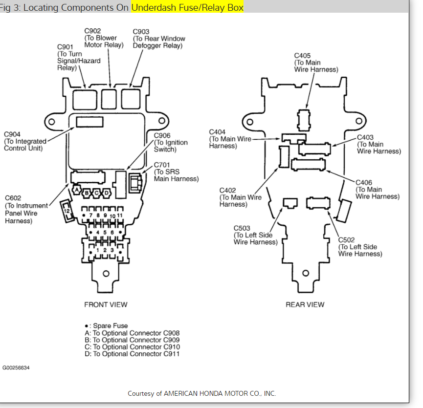

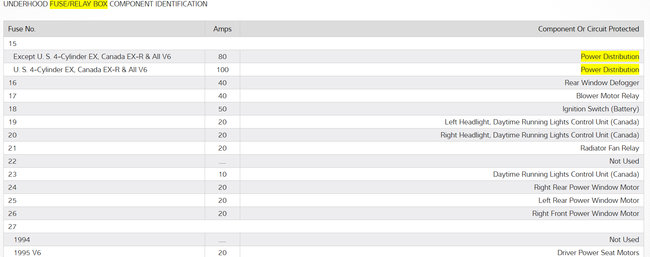

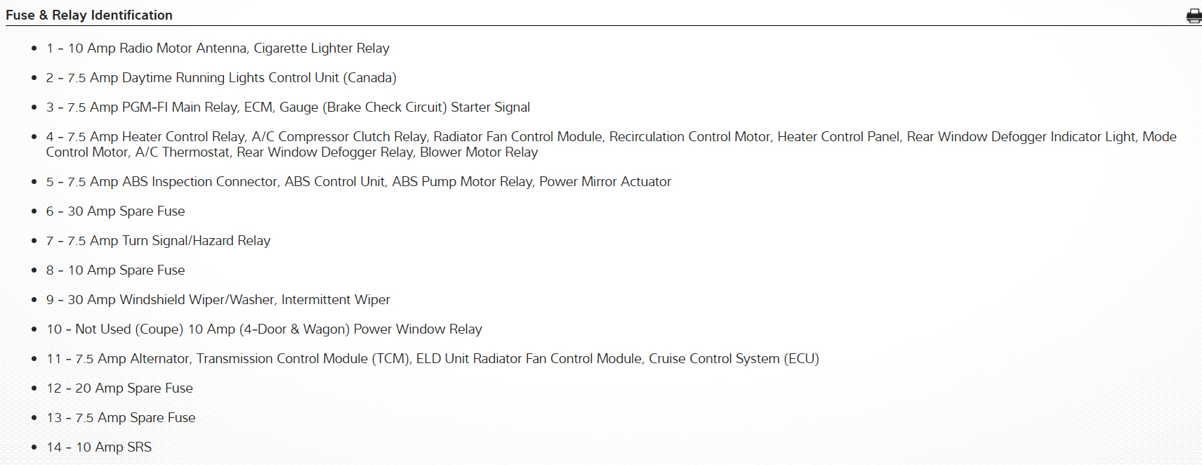

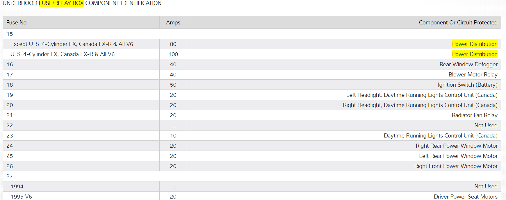

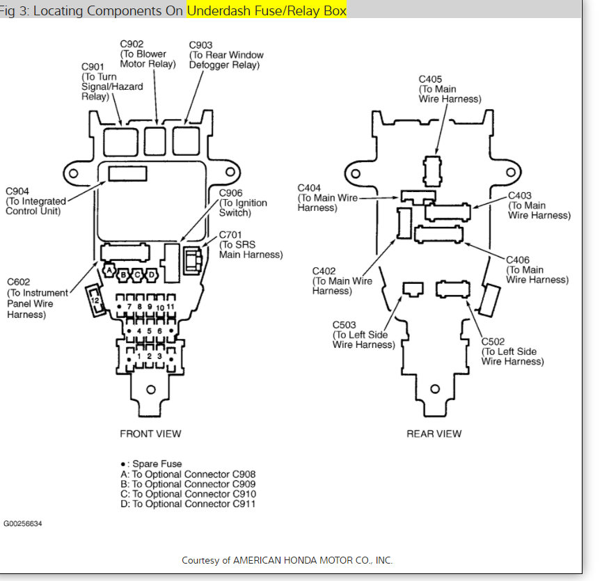

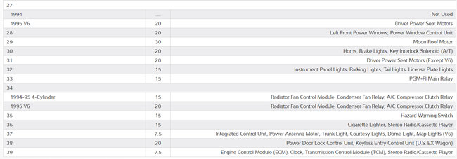

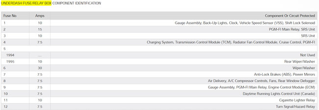

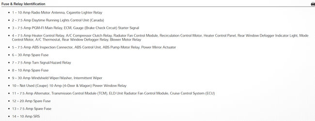

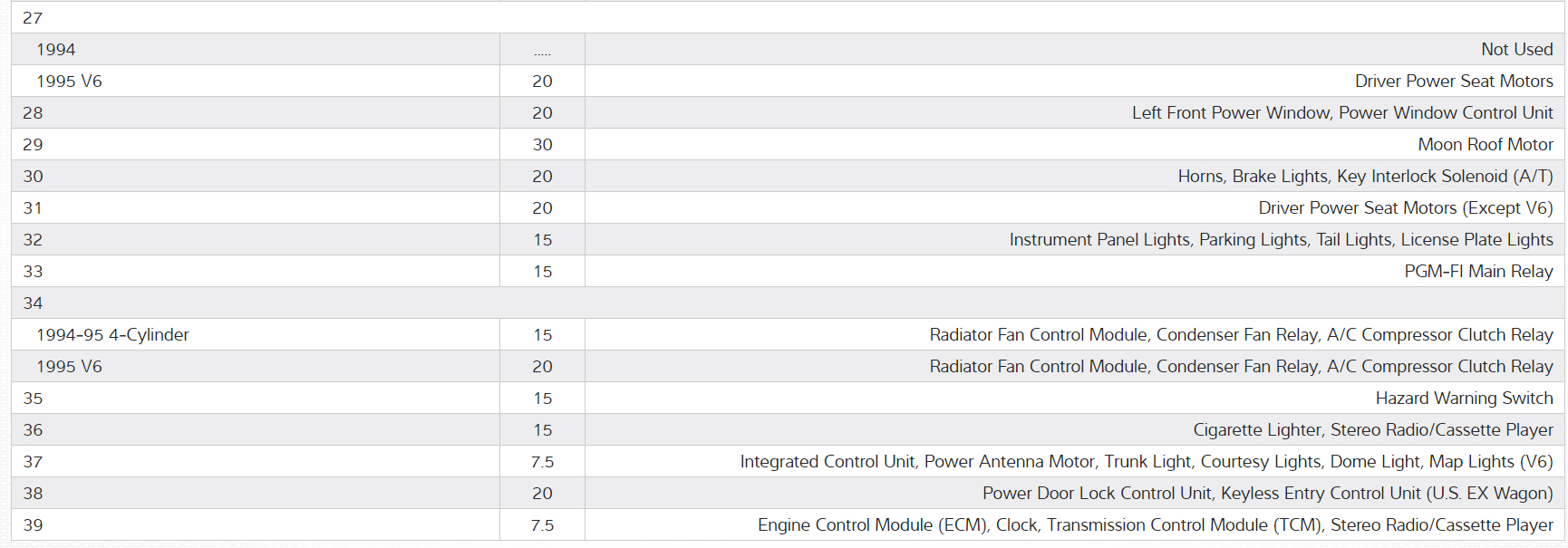

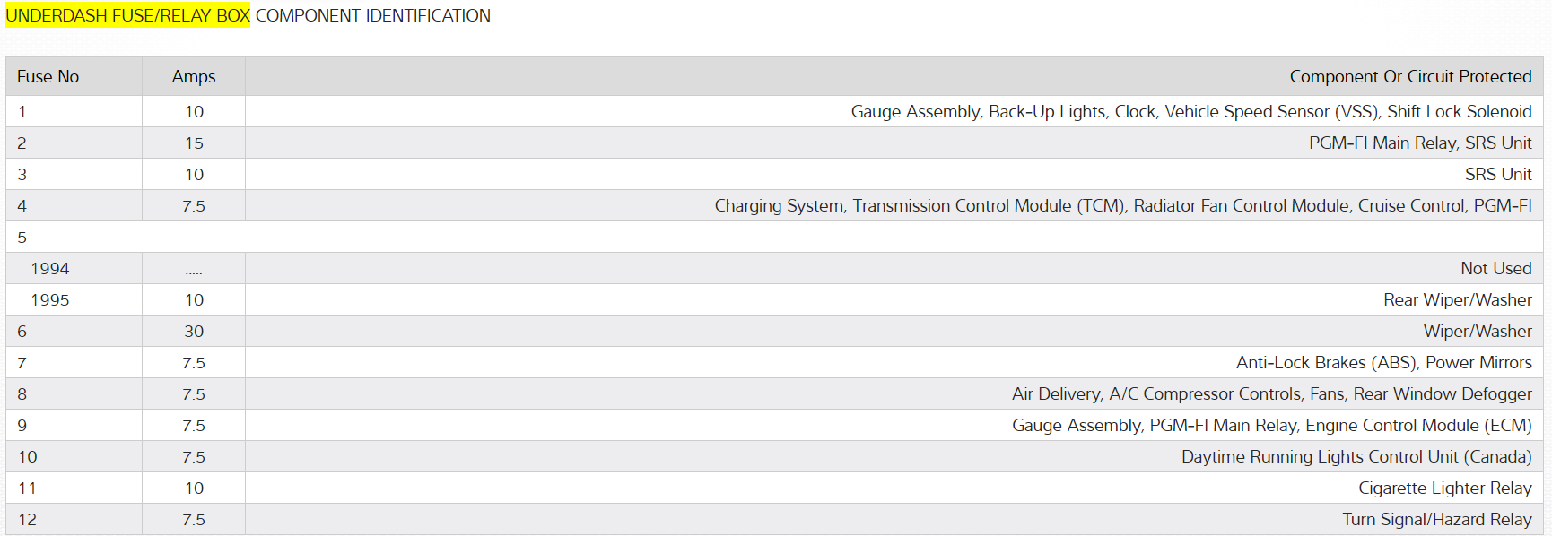

There is a headlight relay that sounds like it is out. Here is the location of the relay and a test guide to help you confirm the issue:
Check out the diagrams (below).
