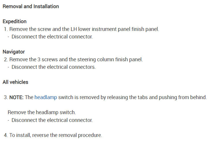

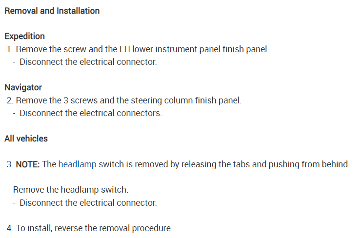

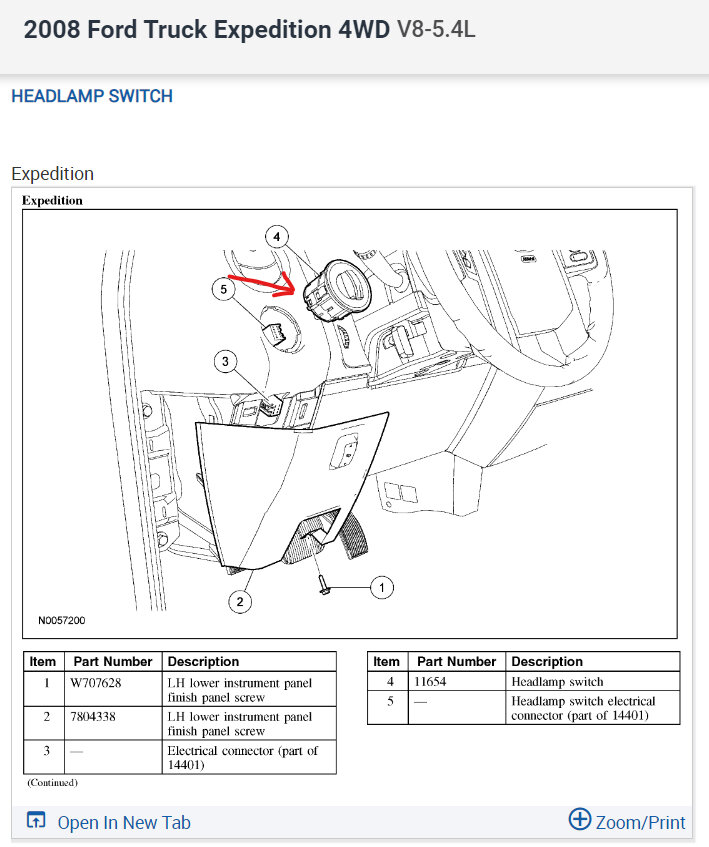

I have got access to the headlight switch. But I can't figure out what holds it in place. What is securing it and how do I get it out?
Sep 9, 2024 at 12:54 PM
The headlamp switch has two plastic tangs on either side that you need to push inward to release the switch, check out the images (below). Let us know if you need anything else.
