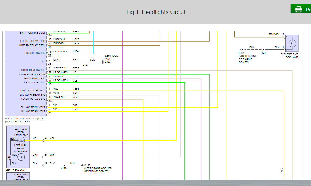

The passenger side dim headlamp is out. We have checked all the fuses and replaced the bulb. I've read that it could be a relay problem or reining, but I can not find a wiring diagram. Can you help me please?
