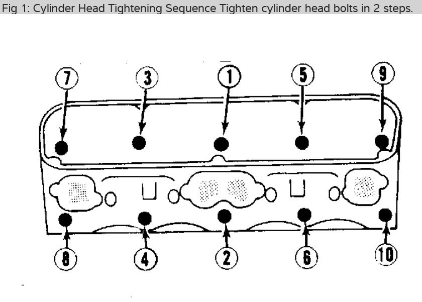

can you tell me which head goes on what side or does it matter? Had valve job done on blow head gasket. Also, it had no manifold gasket on it near the head do I put some there or not?
