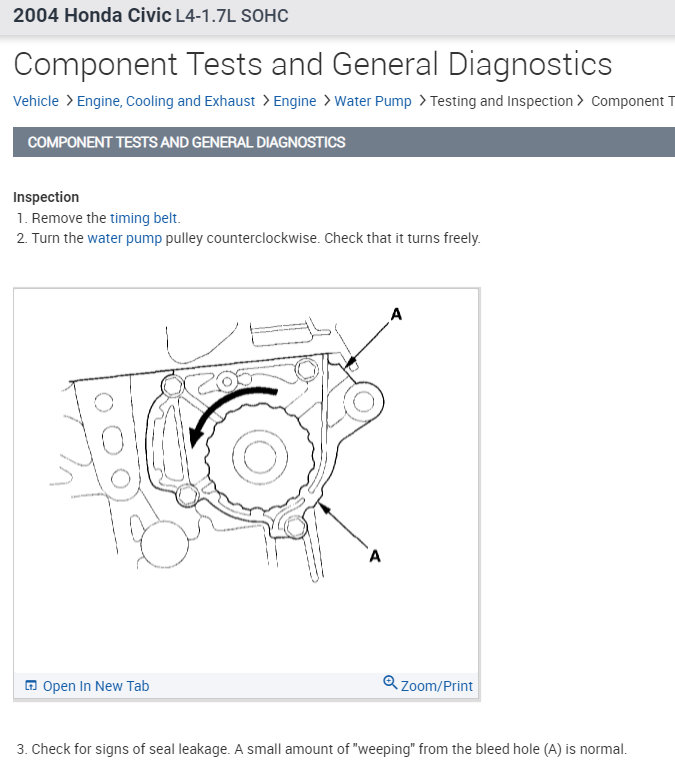

I have a leak under the water pump. Previously the engine overhand we had to replace the radiator.
The garage said that the head gasket was bad after they did a pressure test. Not sure if they noticed the leak. The car runs fine. No water in the oil. Leak under pump is minor. The level in radiator maintains level.
