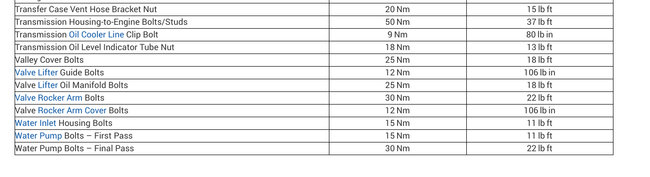

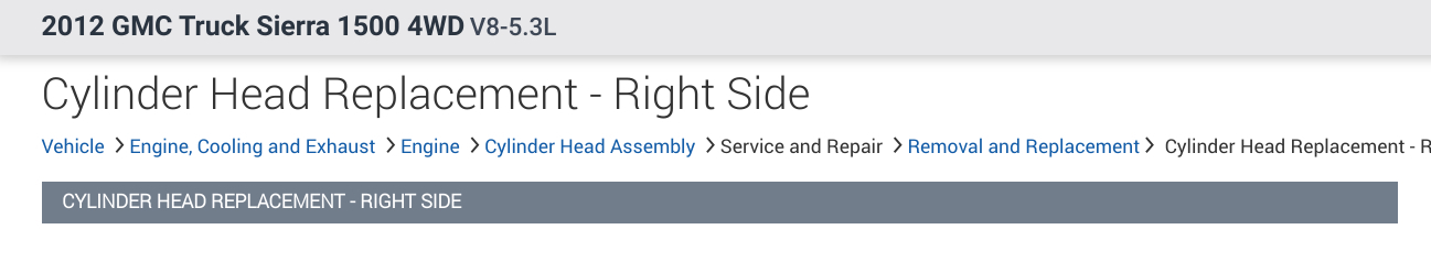

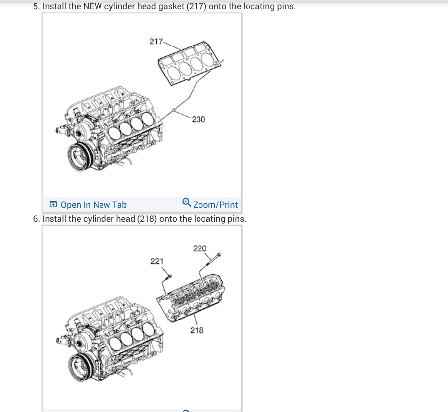

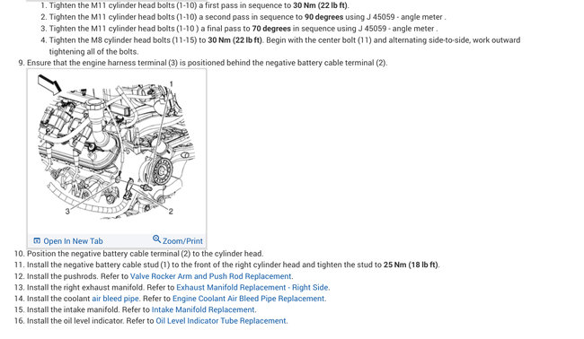

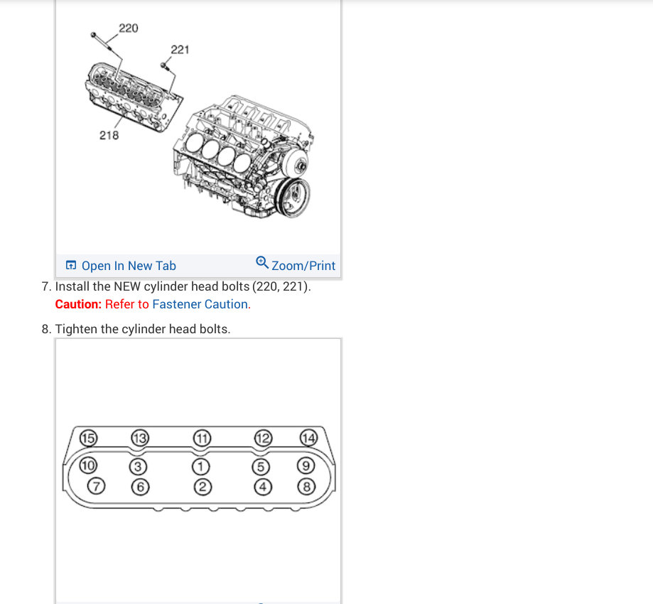

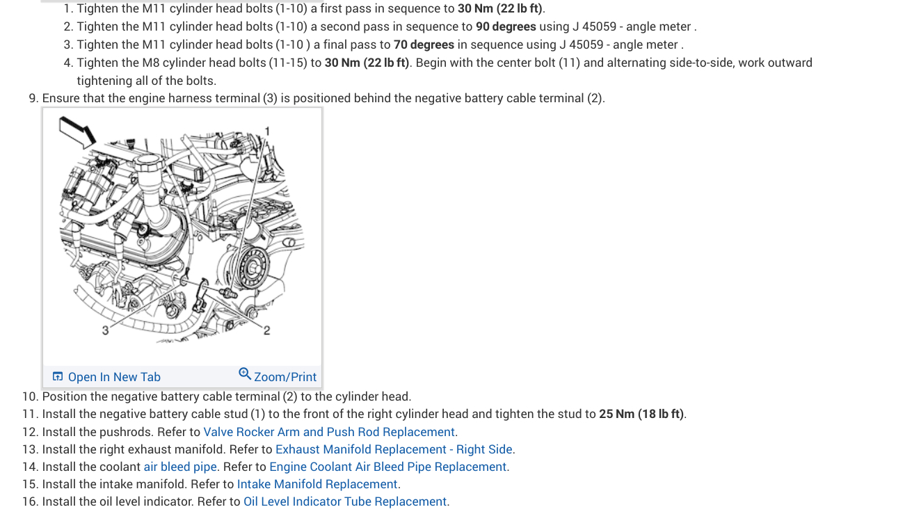

Hello, i need the diagram for the head gasket. Need to know how to tighten head bolt and torque spec 5.3 2012 Sierra silverado.
The lbs and degrees.
