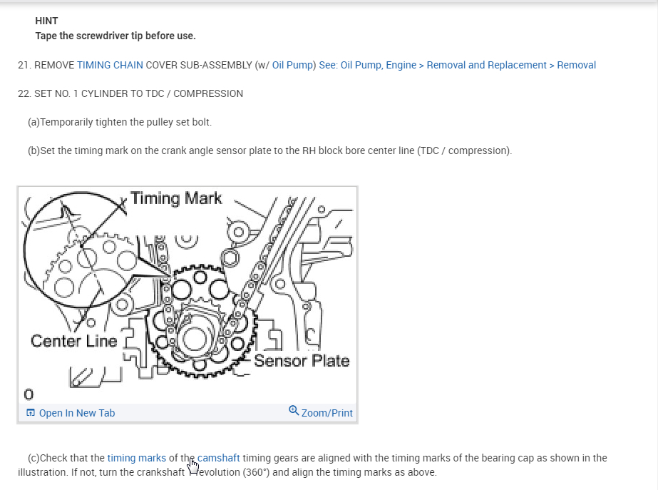

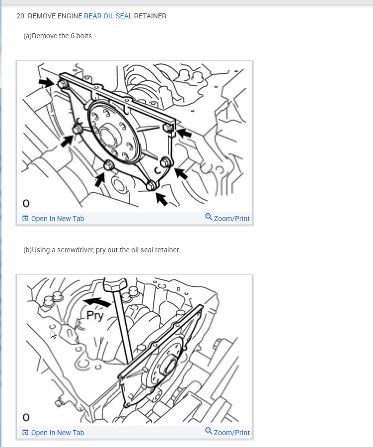

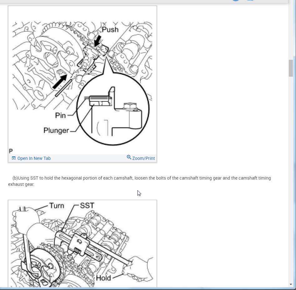

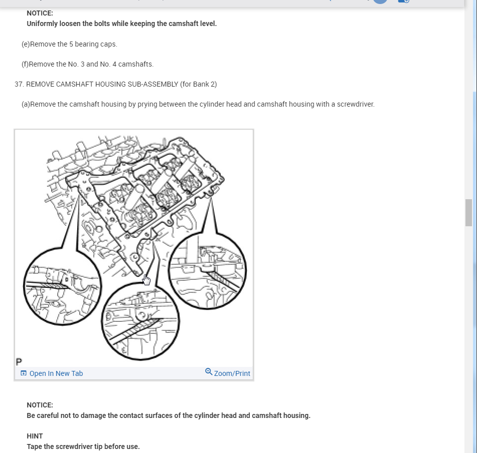

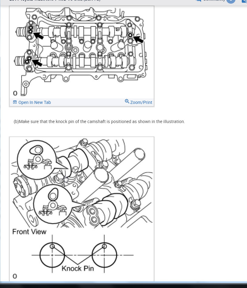

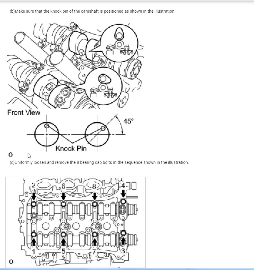

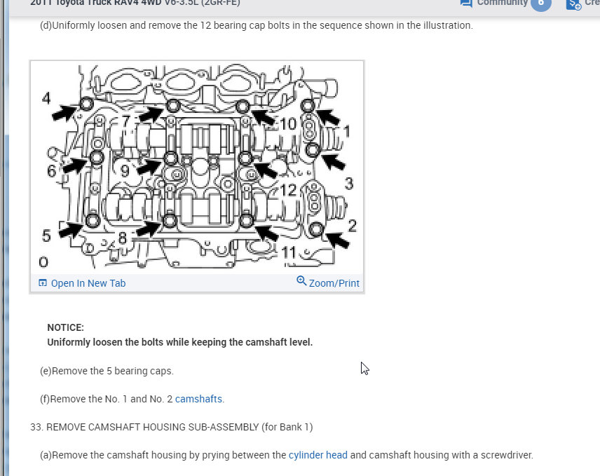

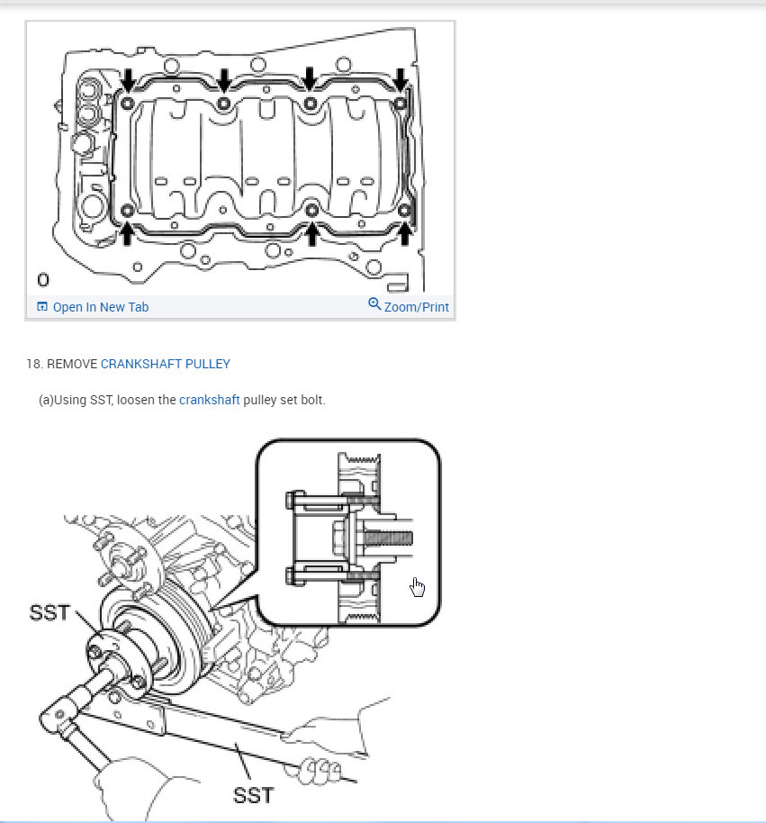

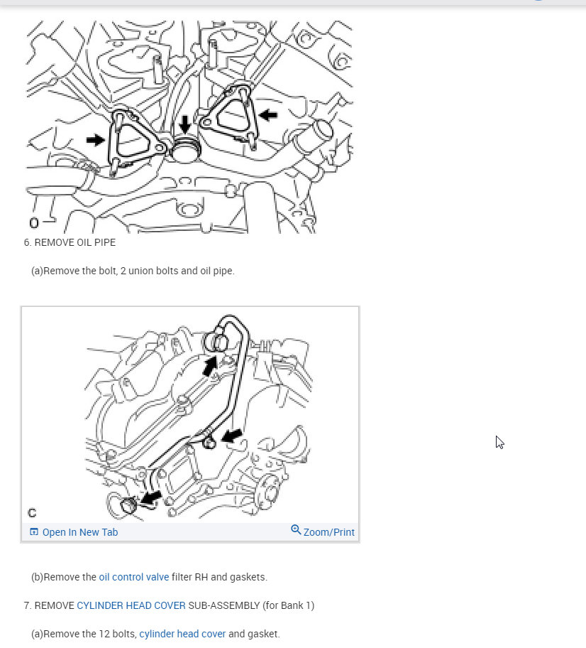

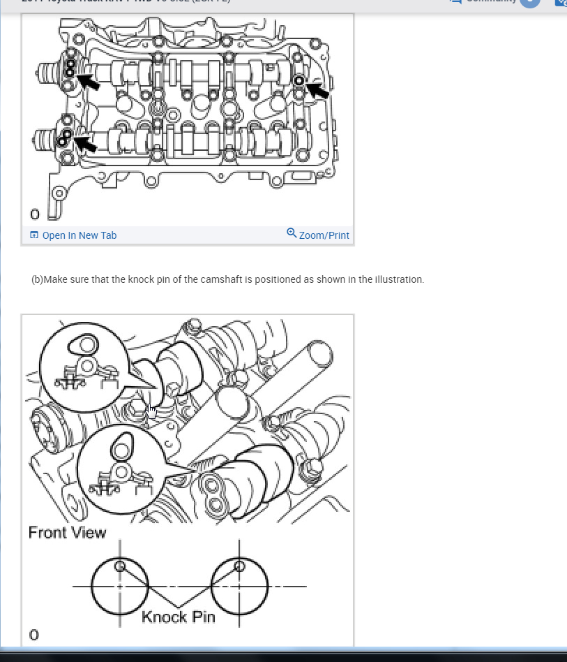

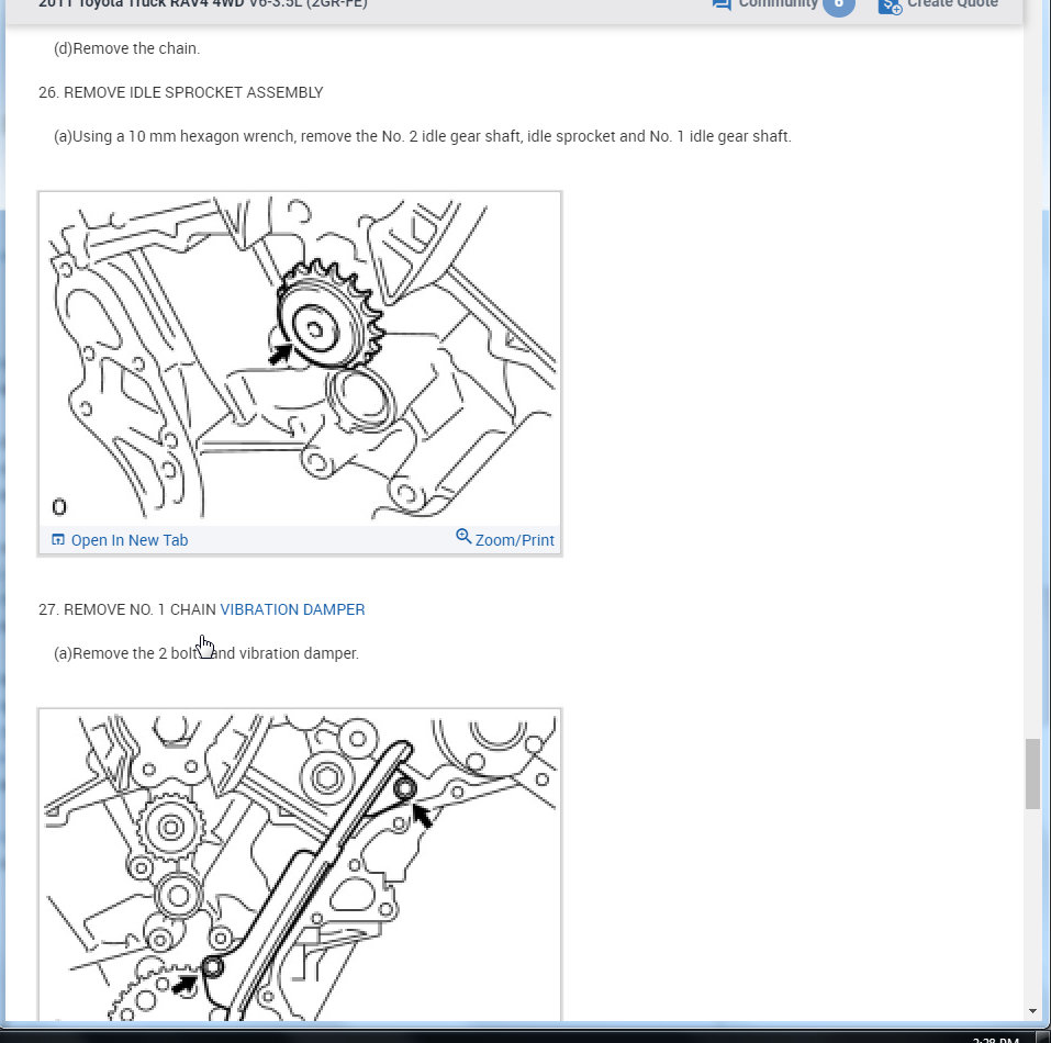

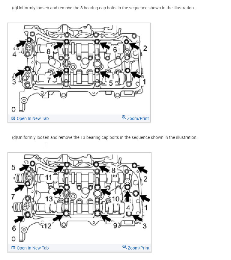

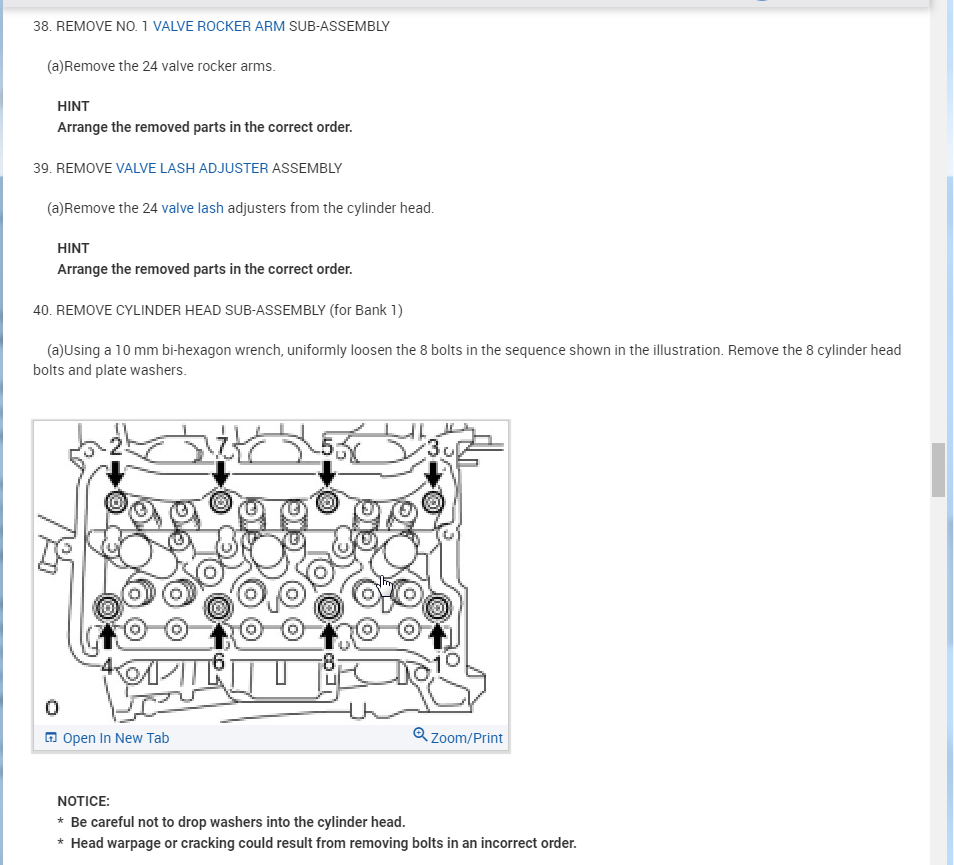

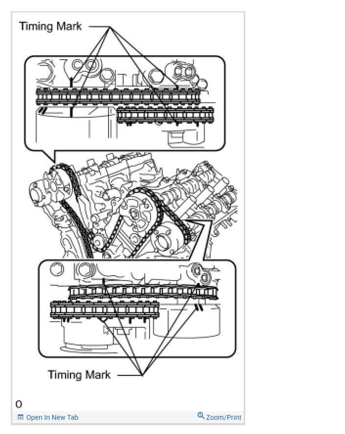

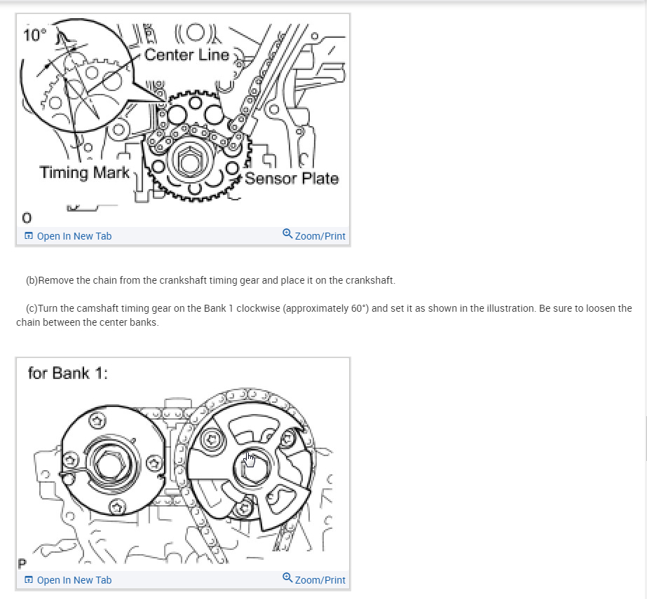

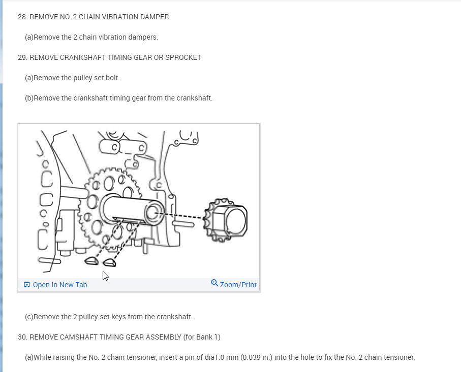

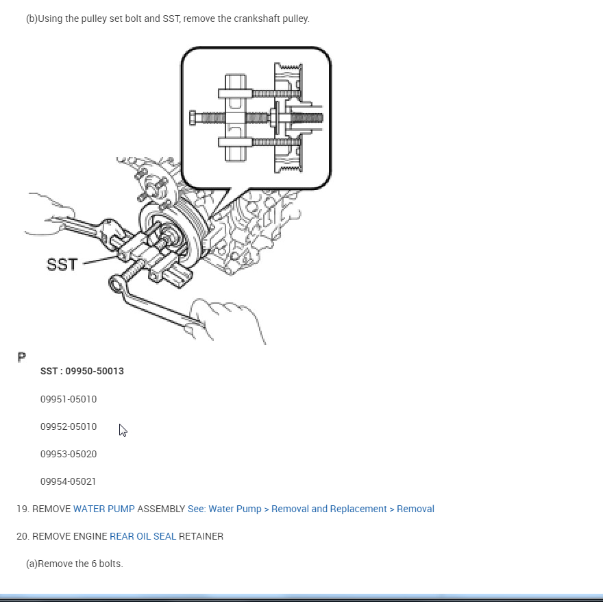

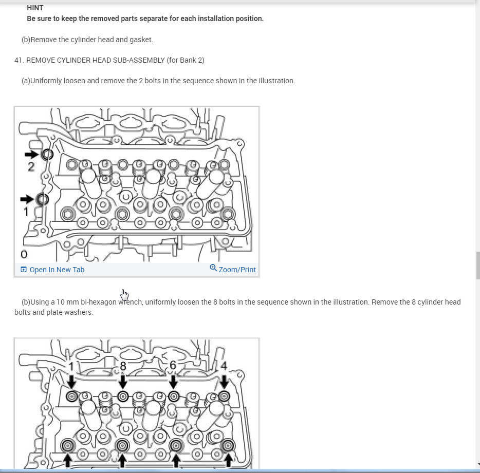

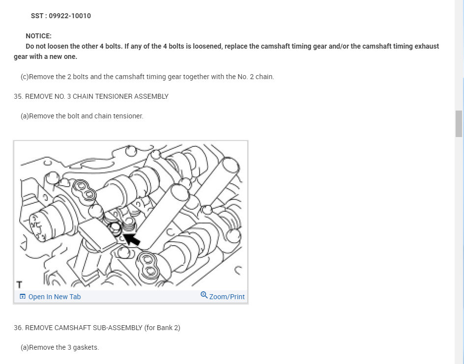

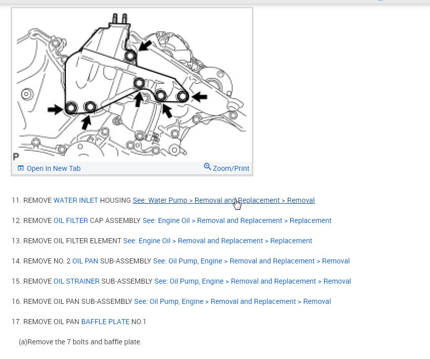

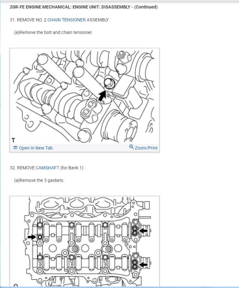

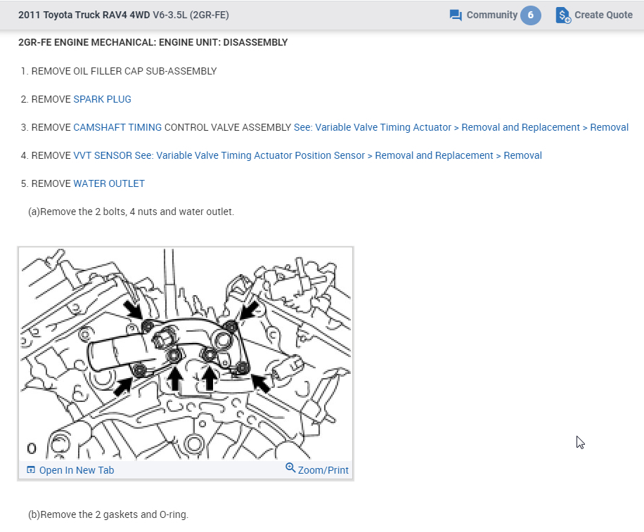

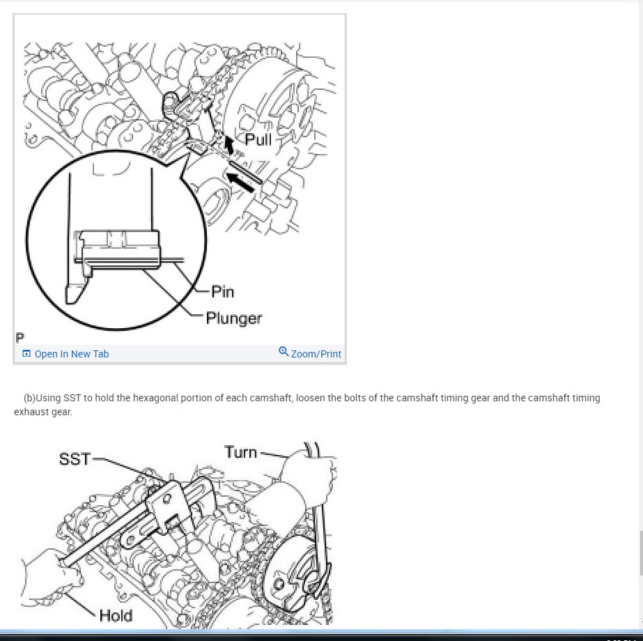

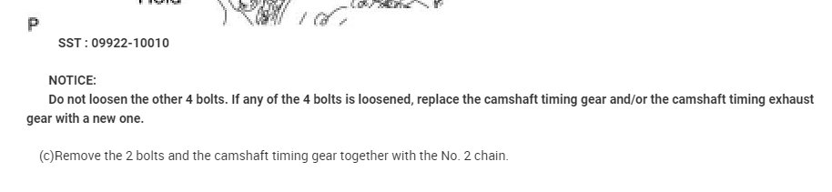

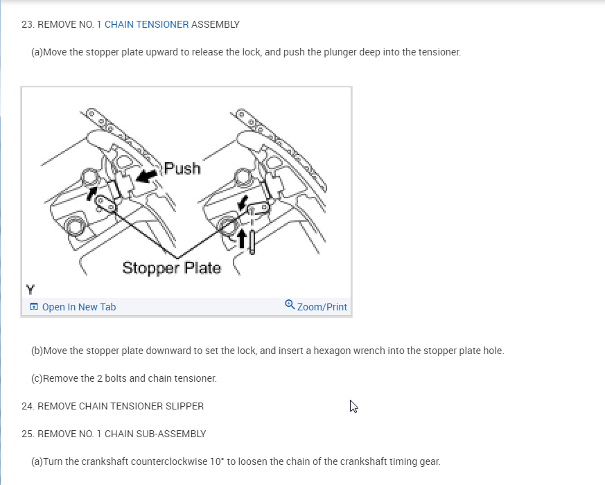

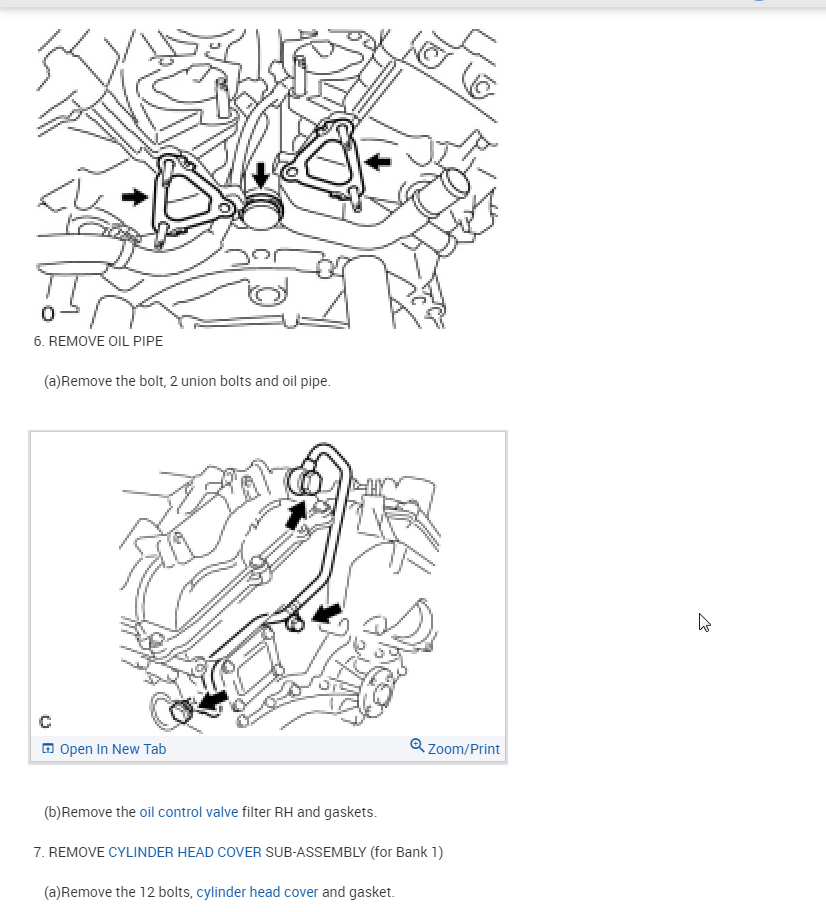

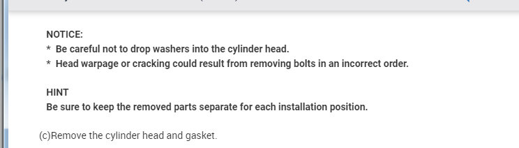

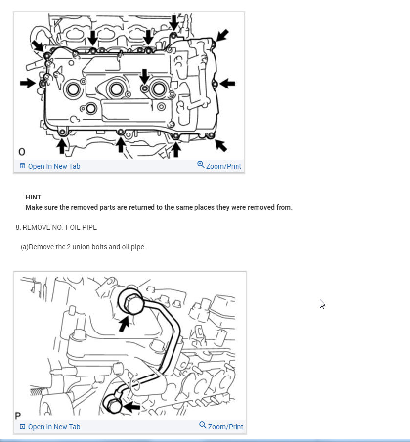

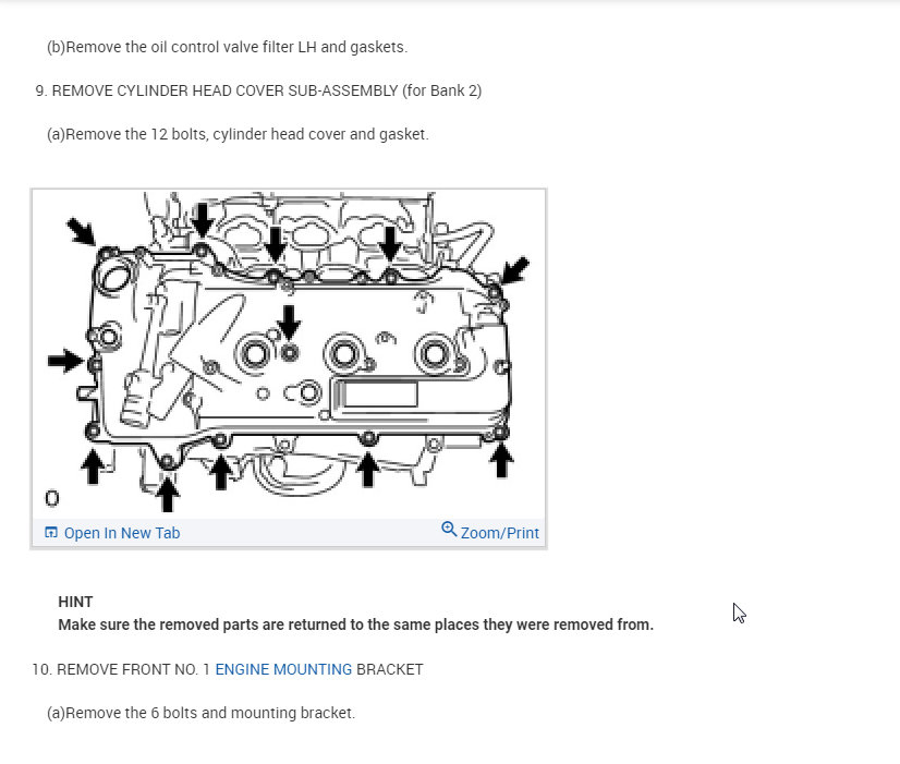

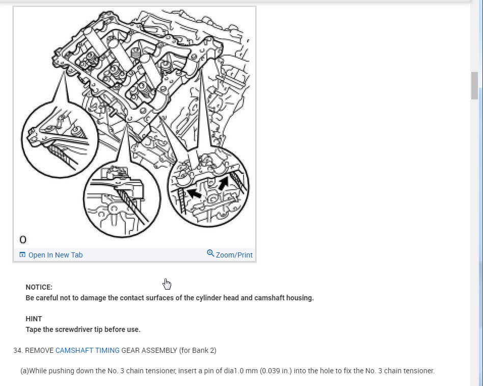

If you confirm a head gasket I attached the process to replace the gasket. It is pretty lengthy but it is all there if you would like to perform the repair yourself. Thanks
