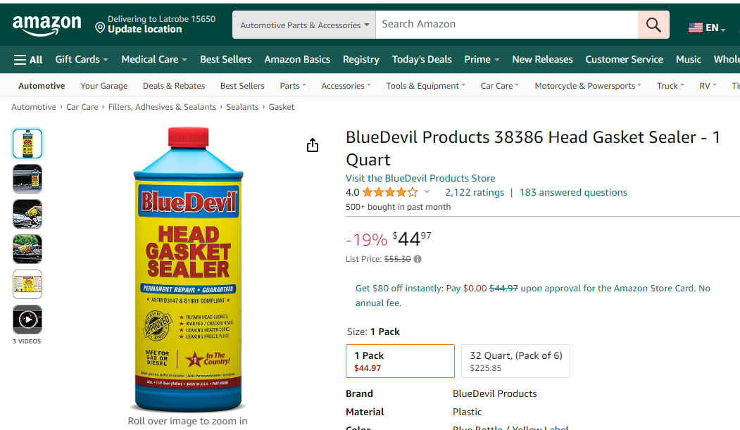

As I'm sure you are aware, the right way to fix it is by replacing the gasket. However, I know there are products that you can purchase that I've been told work. I have never used them, so I'm only telling you what I've heard.
I recall one person used a Blue Devil head gasket sealer on a Subaru and it worked for a couple of years. So you may want to check into that brand product. I took a second and looked it up and attached a pic from Amazon below.
Let me know if this helps. If you want to replace the gaskets, let me know that as well.
See pic below.
