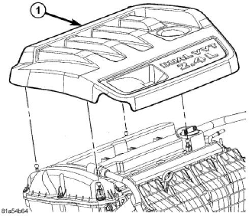

pic 1
1. Remove engine cover (1).

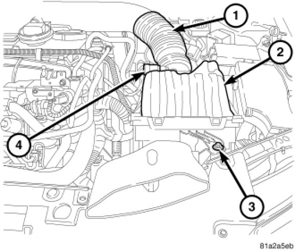

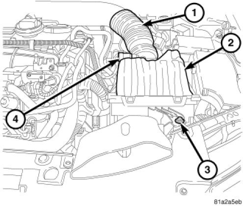

pic 3
4. Remove clean air hose and air cleaner housing (2)See: Air Cleaner Housing > Removal and Replacement > Air Cleaner Housing - Removal.

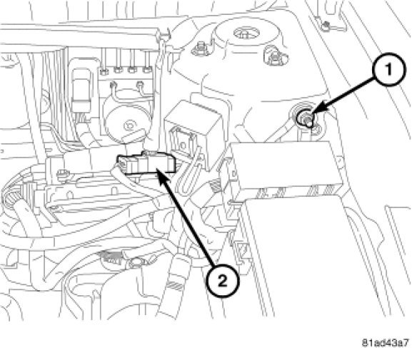

pic 4
5. Disconnect negative battery cable (1).

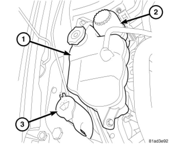

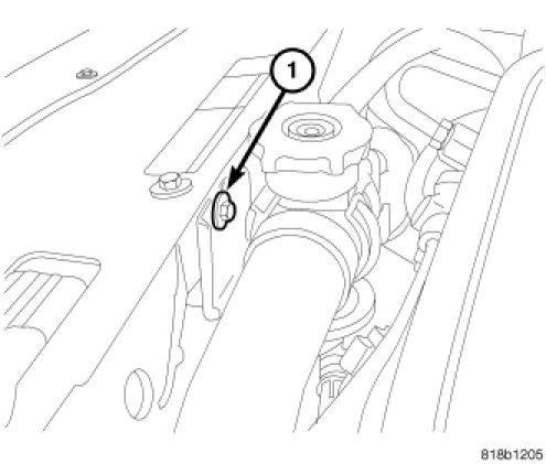

pic 5
7. Remove coolant recovery bottle (1).
8. Remove and reposition power steering reservoir (2).
9. Remove power steering pump and reposition.

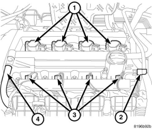

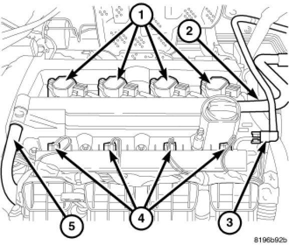

pic 6
10. Disconnect breather hose.
11. Disconnect PCV hose (4).
12. Disconnect ignition coil electrical connectors (1).

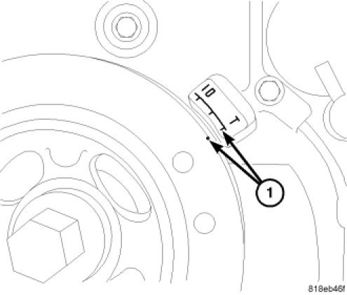

pic 7
14. Raise vehicle.
15. Remove right splash shield.
16. Set engine to TDC (1).
17. Remove accessory drive belts See: Drive Belt > Removal and Replacement > Accessory Drive Belt - Removal.

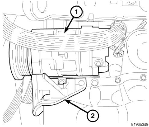

pic 8
18. Remove lower A/C compressor bolts if equipped.
19. Remove lower A/C compressor mount (2) if equipped.

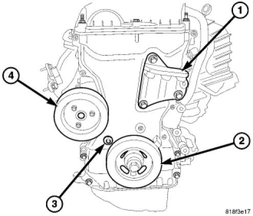

pic 9
20. Remove accessory drive belt lower idler pulley.
21. Remove crankshaft damper (2).
22. Remove water pump pulley (4).
23. Remove right side engine mount bracket (1) lower bolt.

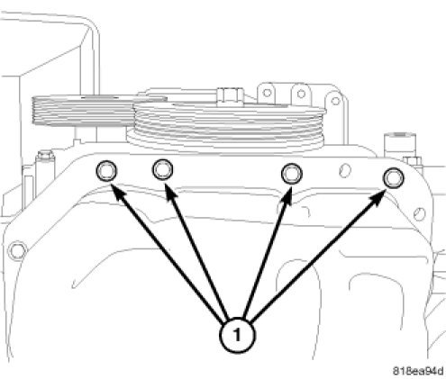

pic 10
24. Remove timing chain cover lower bolts (1).

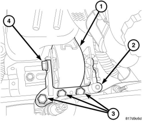

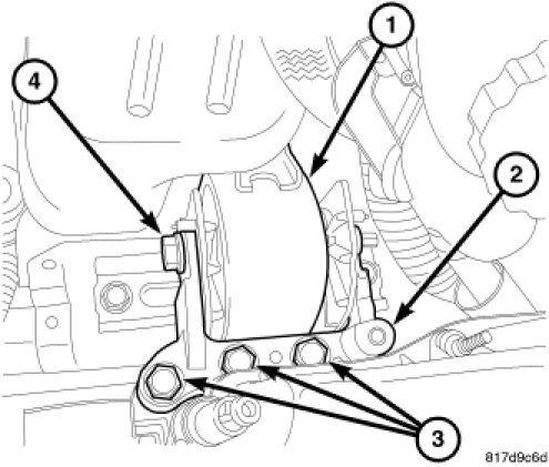

pic 11
29. Remove right engine mount through bolt (4).
30. Remove right engine mount to mount bracket bolts (3).
31. Remove right engine mount adapter (2).

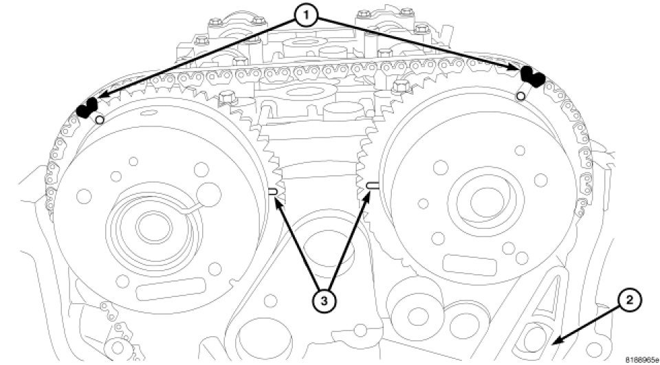

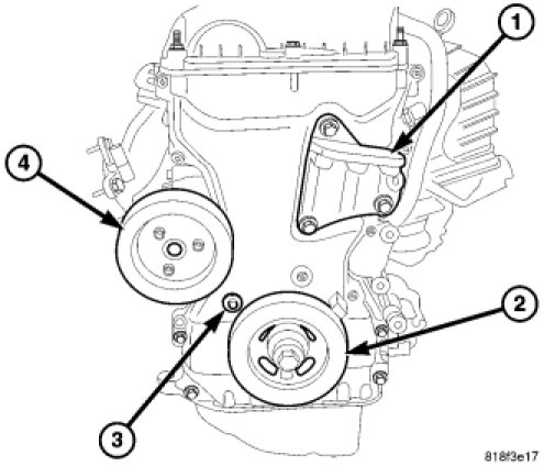

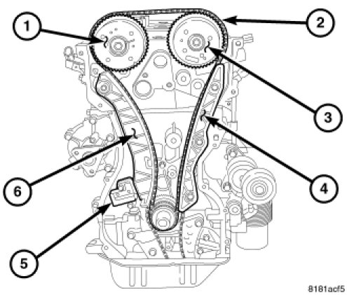

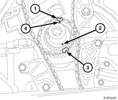

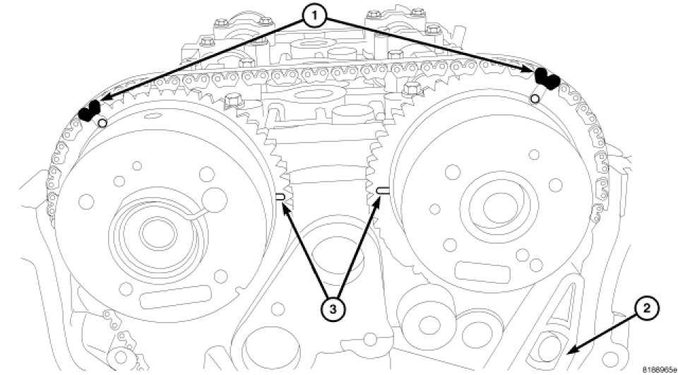

pic 13
NOTE: If the timing chain plated links can no longer be seen, the timing chain links corresponding to the timing marks must be marked prior to removal if the chain is to be reused.
37. Mark chain link (1) corresponding to camshaft timing mark.
pic 14
38. Mark chain link (3) corresponding to crankshaft timing mark (2).
pic 15
39. Remove timing chain tensioner (5).
40. Remove timing chain (2).
41. Remove timing chain guides (4,6).

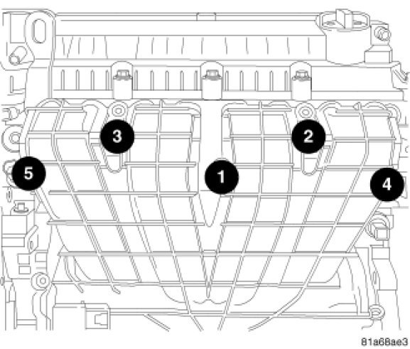

50. Remove intake manifold retaining bolts.

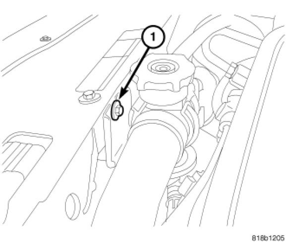

pic 18
51. Remove upper radiator hose retaining bolt (1).

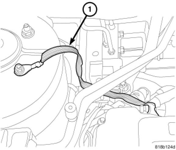

pic 19
54. Remove ground strap (1) at right rear of cylinder head.

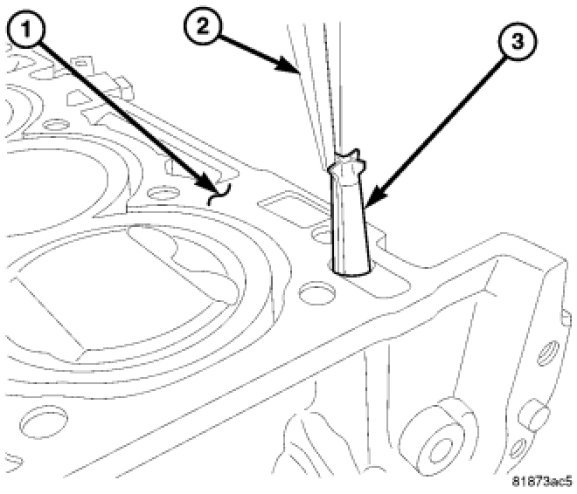

NOTE: Ensure cylinder head bolt holes in the block are clean, dry (free of residual oil or coolant), and threads are not damaged.

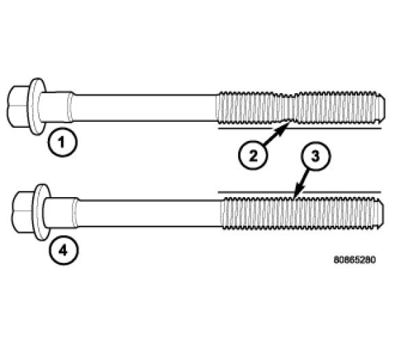

pic 21
NOTE: The Cylinder head bolts should be examined BEFORE reuse. If the threads are necked down, the bolts should be replaced.
Necking can be checked by holding a scale or straight edge against the threads. If all the threads do not contact the scale (2), the bolt should be replaced.

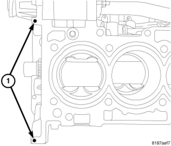

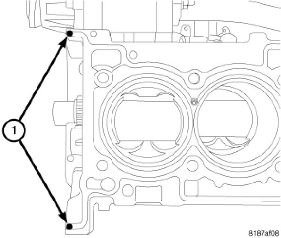

NOTE: When using RTV, the sealing surfaces must be clean and free from grease and oil.
NOTE: When using RTV, parts should be assembled in 10 minutes and tighten to final torque within 45 minutes.
2. Place two pea size dots of Mopar(R) engine sealant RTV or equivalent (1) on cylinder block as shown.
pic 24
3. Position the new cylinder head gasket on engine block with the part number facing up. Ensure gasket is seated over the locating dowels in block.
4. Place two pea size dots of Mopar(R) engine sealant RTV or equivalent (1) on cylinder head gasket as shown.
NOTE: The head must be installed within 15 minutes before the RTV skins.

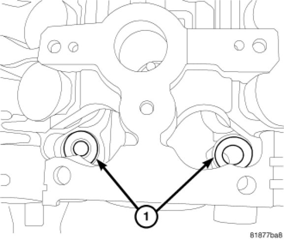

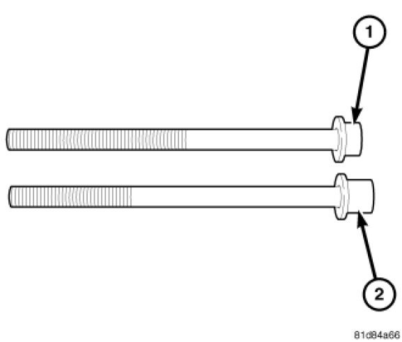

CAUTION: This engine was built with 2 different style cylinder head bolts. Each style bolt requires a different torque value. The bolts can be identified by the short bolt head (1) and the long bolt head (2).
6. Measure the bolt head from the washer to the top of the bolt head. The short bolt head (1) measures 8 mm (5/16") and the long bolt head (2) measures 13 mm (1/2").
7. Identify whether your engine has the short head design (1) or the long head design (2).
pic 26
NOTE: The front two cylinder head bolts do not have captured washers. The washers must be installed with the bevel up towards the bolt head.
pic 27
8. Install washers (1) for the front two cylinder head bolts.

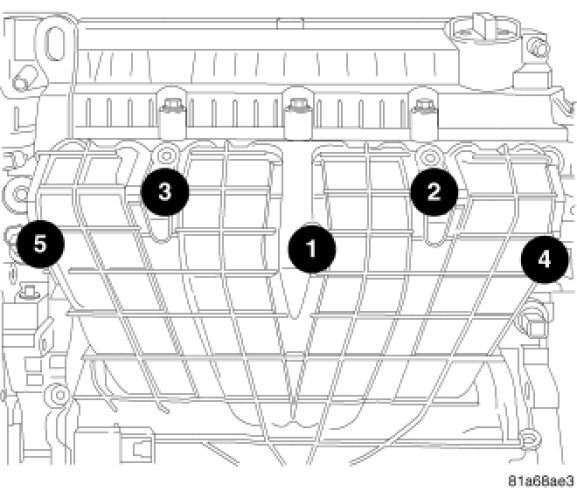

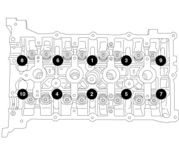

10. Install the cylinder head bolts and tighten in the sequence shown.

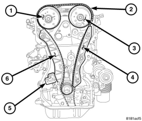

24. Install timing chain (2)See: Timing Chain > Removal and Replacement > Timing Chain & Sprockets - Installation.
25. Install timing chain cover See: Timing Cover > Removal and Replacement > Timing Cover - Installation.

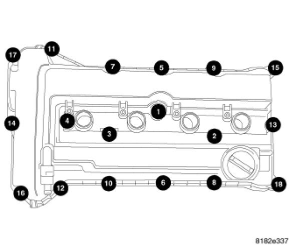

26. Remove coils from cylinder head cover.
27. Install cylinder head cover See: Valve Cover > Removal and Replacement > Cylinder Head Cover - Installation.

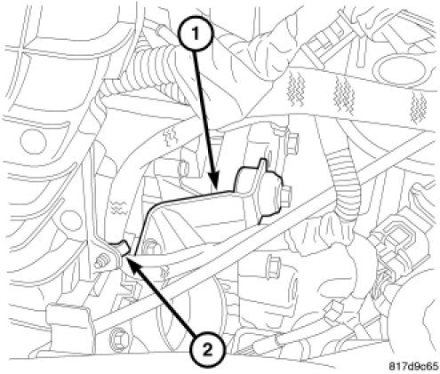

31. Install power steering pump reservoir (2).
32. Install coolant recovery reservoir (1)
33. Install accessory drive belts See: Drive Belt > Removal and Replacement > Accessory Drive Belt - Installation.

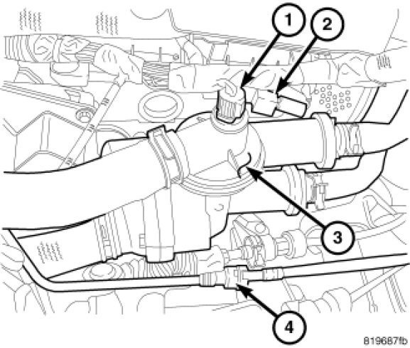

35. Connect coolant hoses to coolant adapter (3).
36. Connect heater hoses to thermostat housing (3).
37. Connect coolant temperature sensor (1) and capacitor (2) electrical connectors.
38. Install heater tube support bracket to cylinder head.
