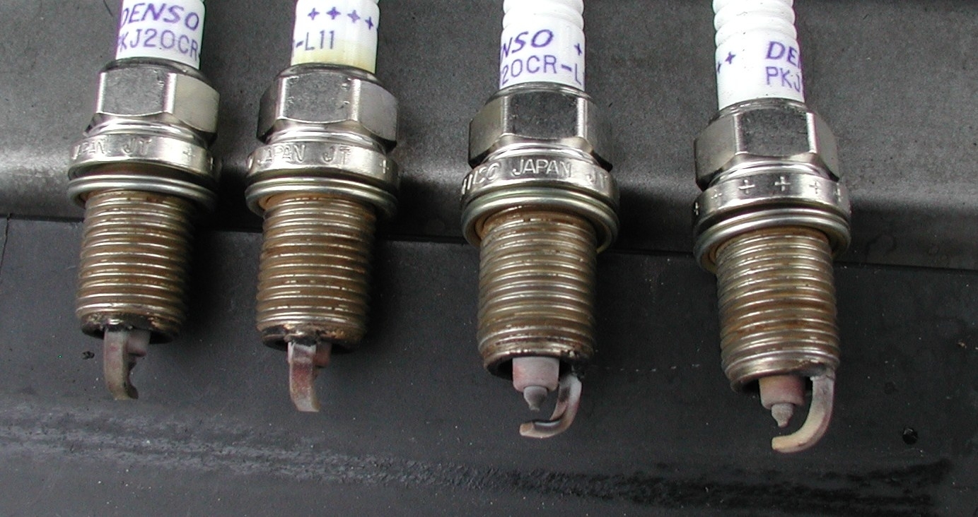

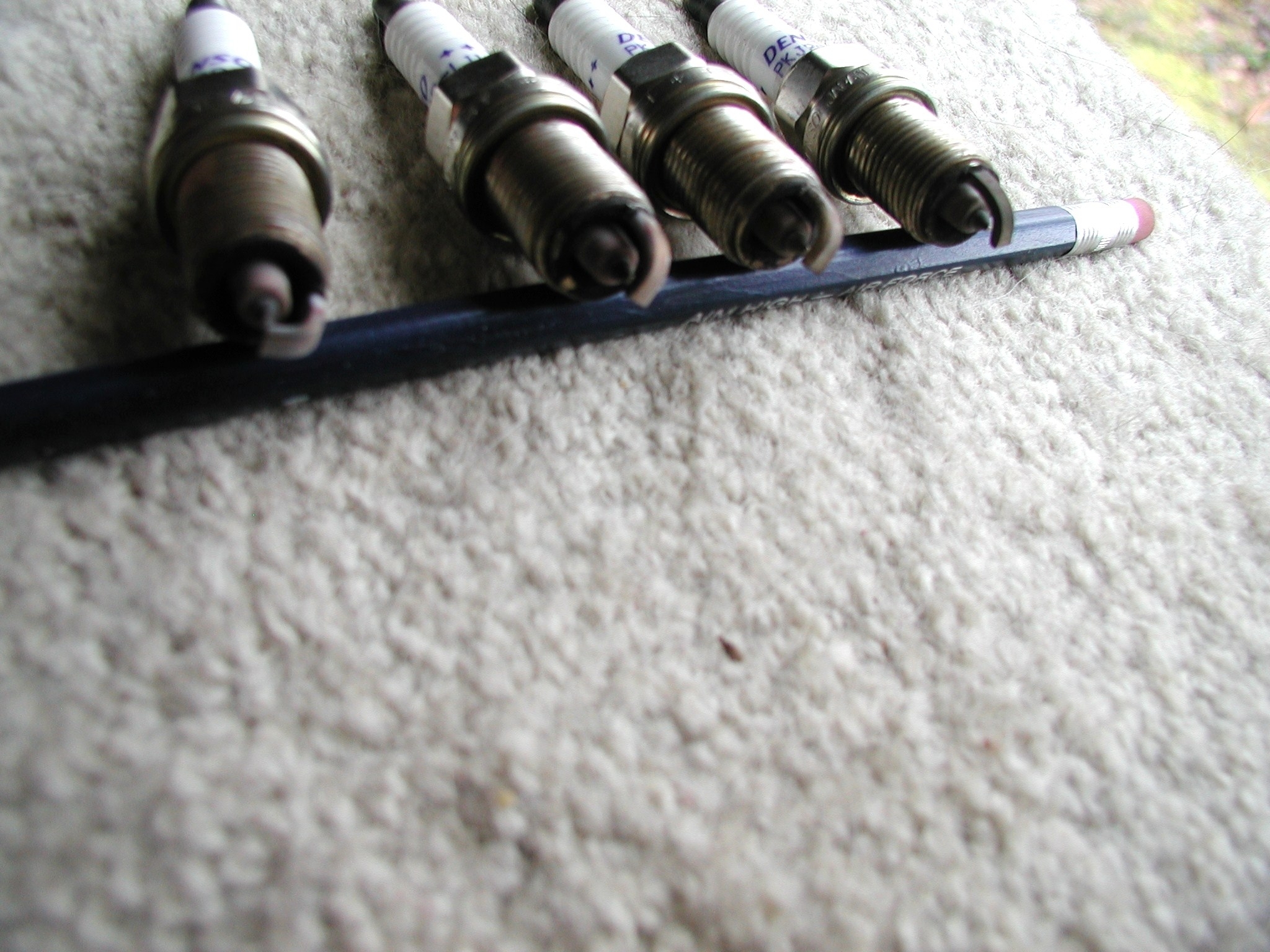

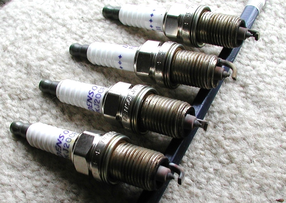

Steve, thanks again. I am including a picture of all four plugs. Remember, I have straight water right now, due to the leak. Straight water for about three weeks. I have a couple more pictures at a different angle if you need to see. Let me know what you think about the plugs, and I promise, I will not bother you anymore!

Another picture of plugs.

Steve, here is a better picture with more detail. Please let me now it this looks normal or not. Thanks.

Not a bother, this is what we do here. Try to gather as much data as possible to give a correct answer. The plug I circled looks like is has some build up on the electrodes and lass carbon in the barrel than the others. A small gasket leak could cause that or it could just be a trick of lighting and plug position. As for it being a fool proof test, it depends on how bad the leak is. With modern gas having alcohol mixed into it that can skew the results if it is a small leak because the alcohol will already have water in it and the extra can still be absorbed so the effect is harder to see. That is why you do the other tests as well.

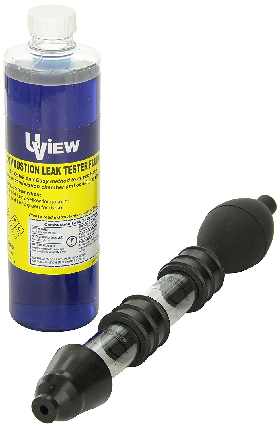

If it was me I would get a test kit. Many of the Advance/Autozone type stores have tool loaner programs. You "buy" the tool and the solution that goes with it. Run the test and return the tool and you get the price of the tool back. Below is what the tool looks like, they are about $50.00 to $75.00 depending on where you buy it. This one is on Amazon.
