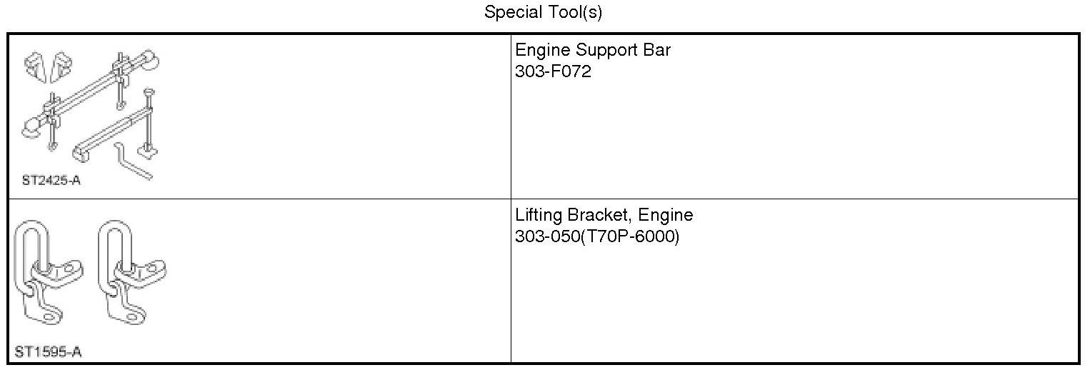

37. Using a floor jack and a block of wood, support the engine.
38. Remove the Engine Support Bar.
39. Remove the bolt and the Engine Lifting Bracket.

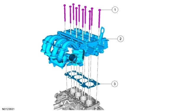

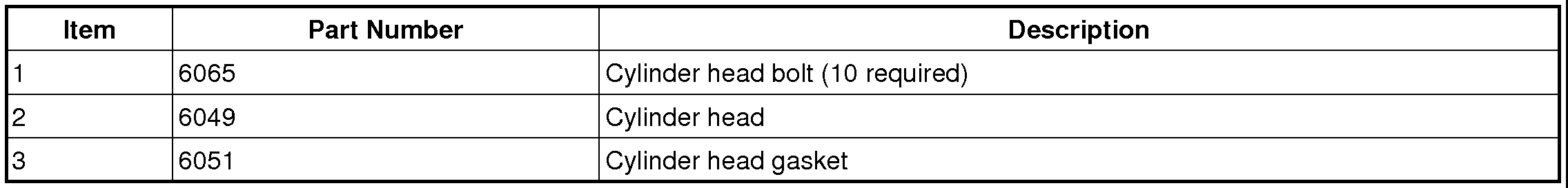

40. NOTE: Make sure that the cylinder head is at ambient air temperature before removing the cylinder head bolts.
Remove the 10 cylinder head bolts in the sequence shown.
- Remove the cylinder head.
- Discard the cylinder head bolts and gasket.

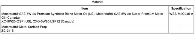

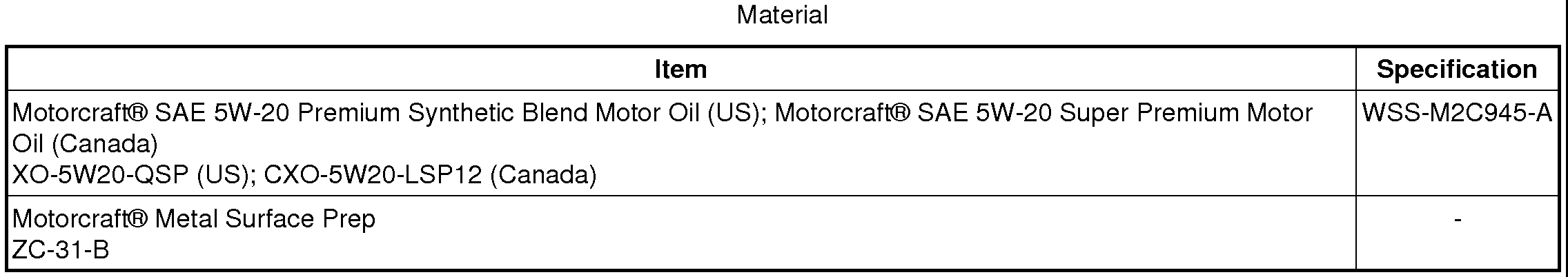

1. NOTICE: Do not use metal scrapers, wire brushes, power abrasive discs or other abrasive means to clean the sealing surfaces. These tools cause scratches and gouges that make leak paths. Use a plastic scraping tool to remove all traces of the head gasket.
NOTE: If there is no residual gasket material present, metal surface prep can be used to clean and prepare the surfaces.
Clean the cylinder head-to-cylinder block mating surface of both the cylinder head and the cylinder block in the following sequence.
1. Remove any large deposits of gasket material with a plastic scraper.
2. Apply metal surface prep, following package directions, to remove any traces of oil or coolant, and to prepare the surfaces to bond with the new gasket. Do not attempt to make the metal shiny. Some staining of the metal surfaces is normal.
2. NOTE: Lubricate the bolts with clean engine oil prior to installation.
Install the cylinder head gasket, cylinder head and 10 new bolts. Tighten the bolts in the sequence shown in 4 stages:
