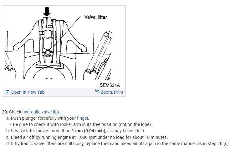

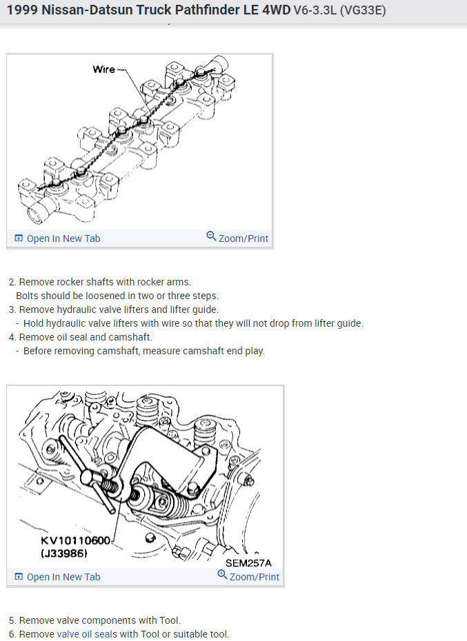

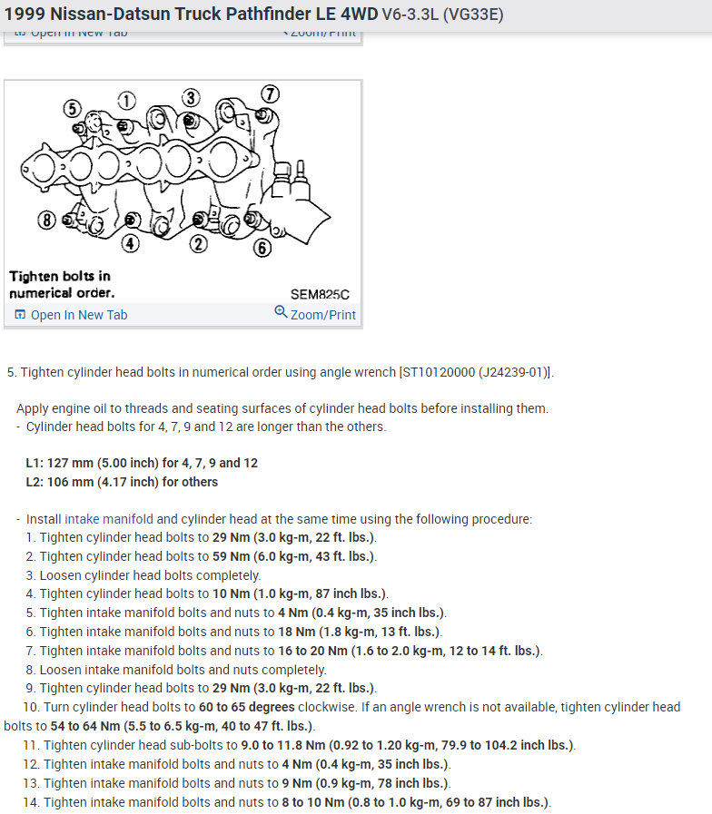

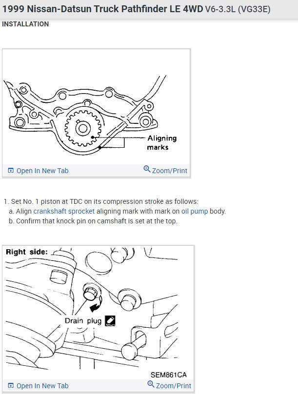

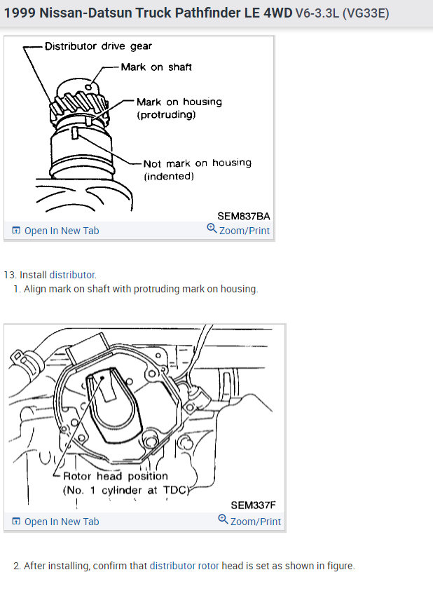

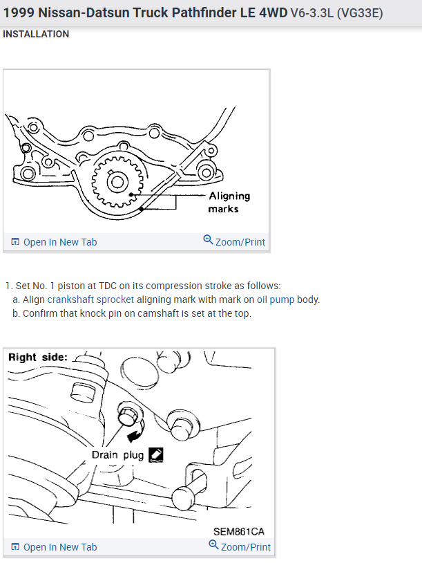

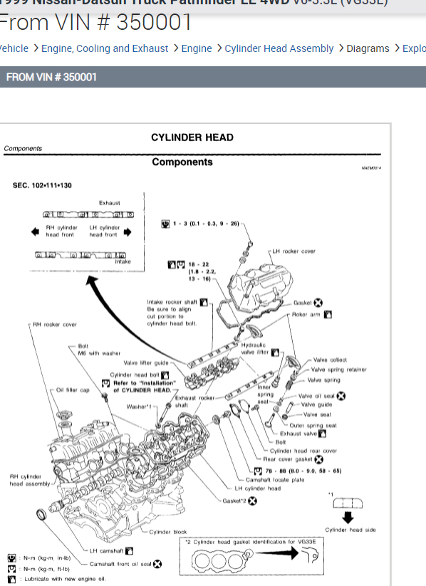

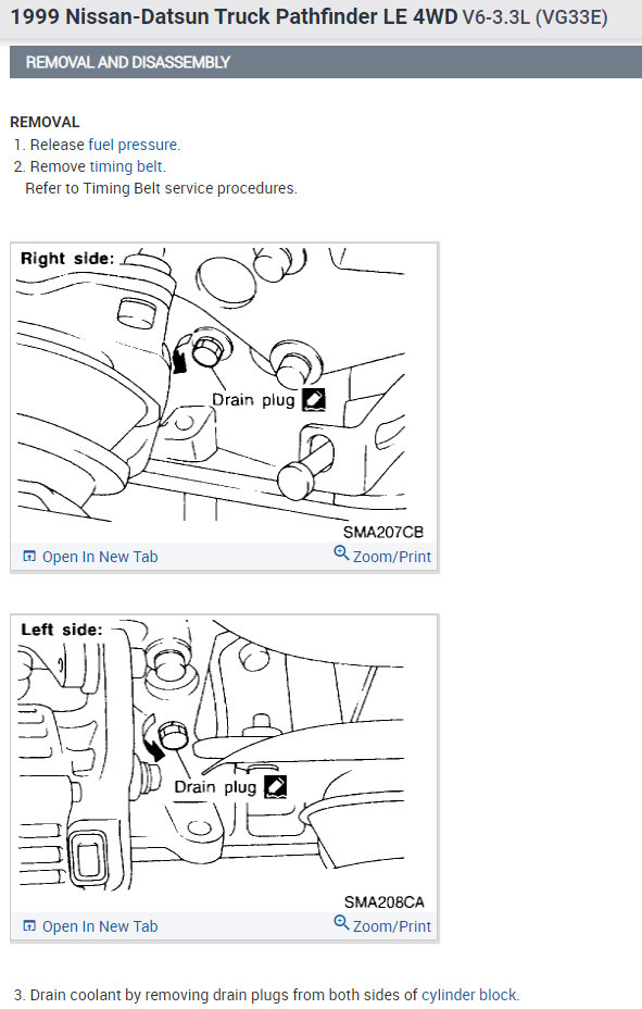

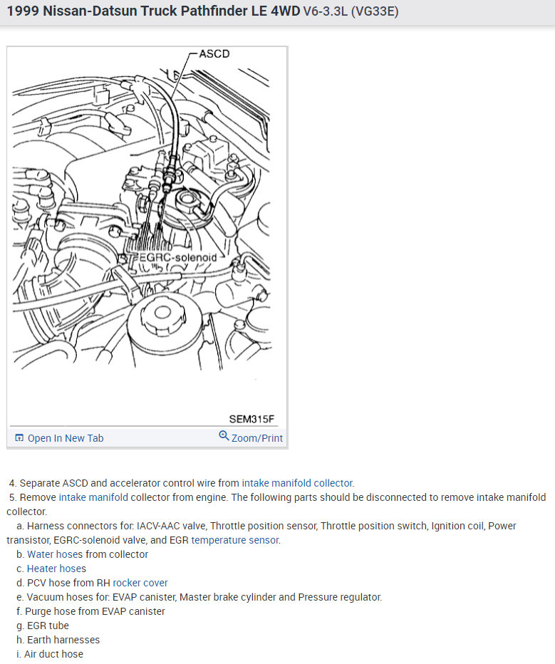

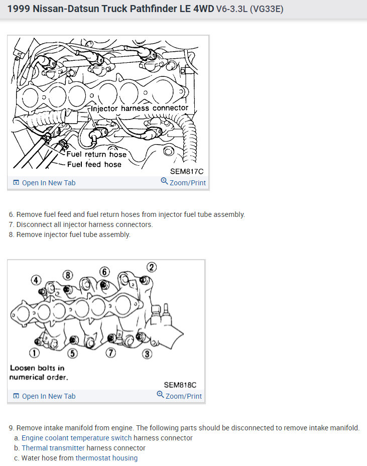

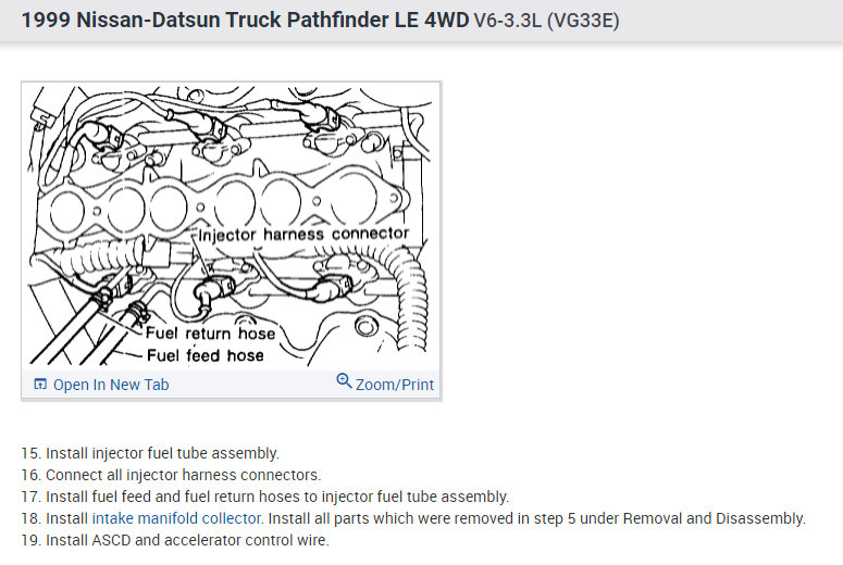

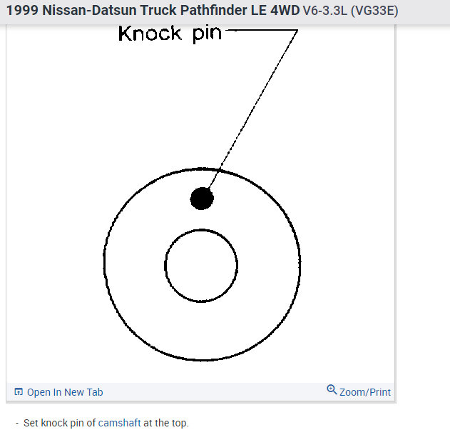

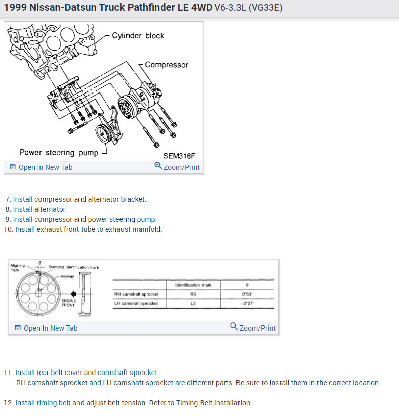

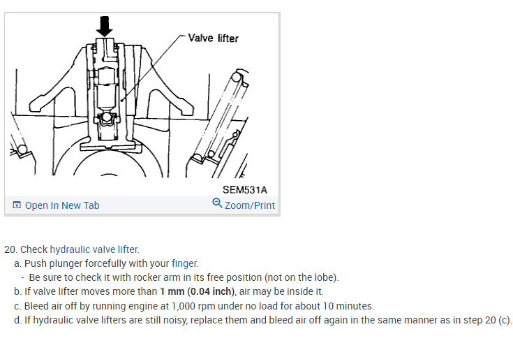

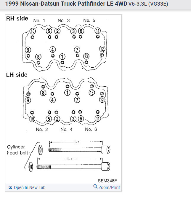

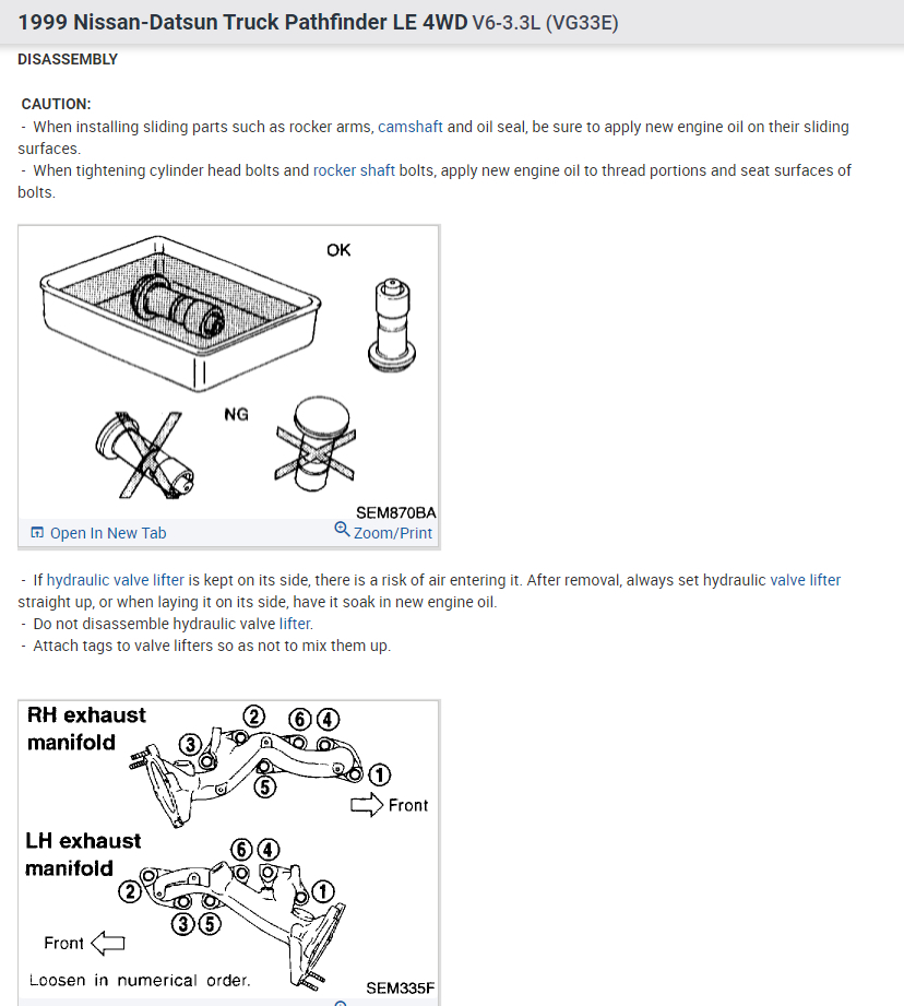

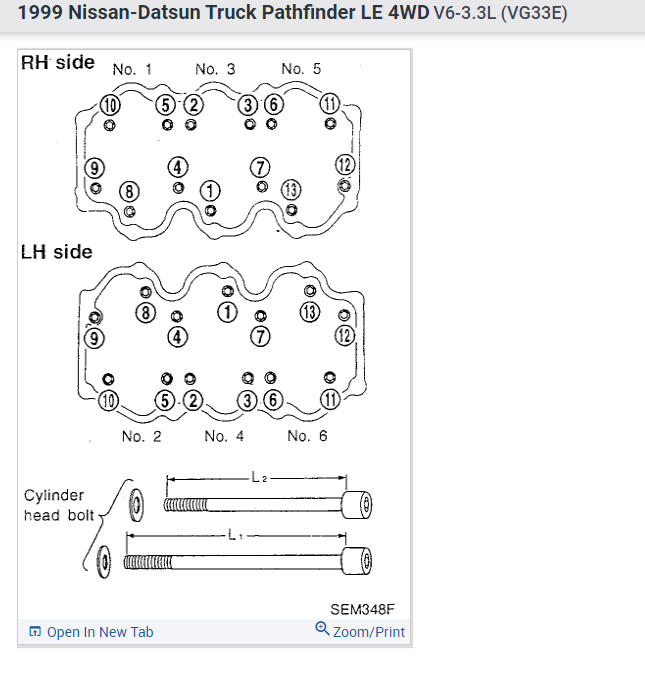

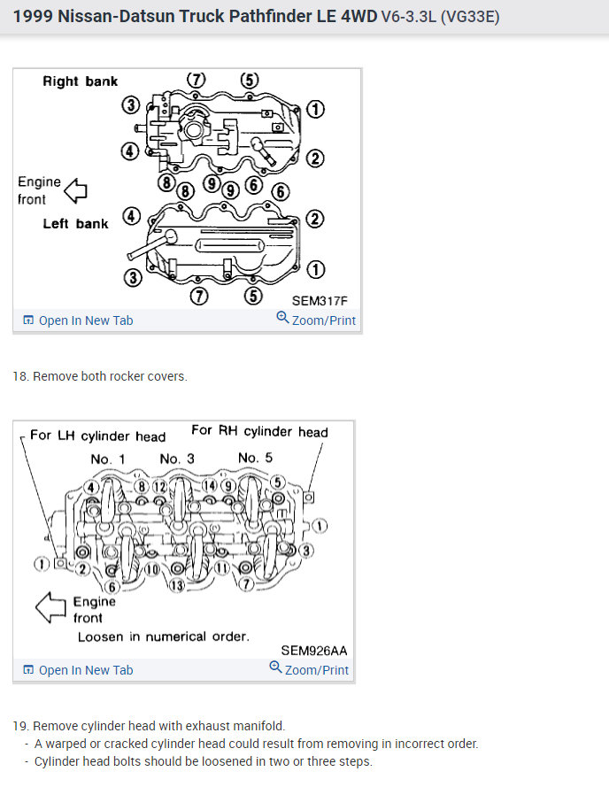

Do you happen to have repair info on replacing head gasket?
Oct 2, 2021 at 11:07 AM
SQM
  • 6,383 POSTS

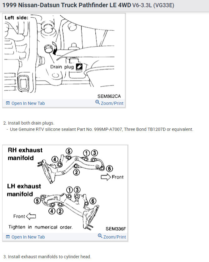

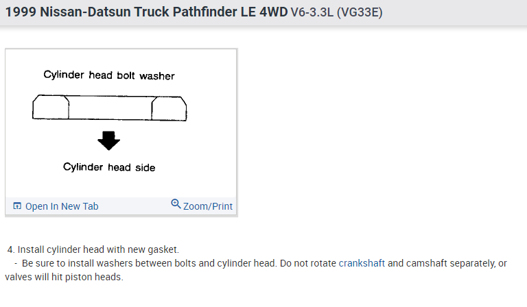

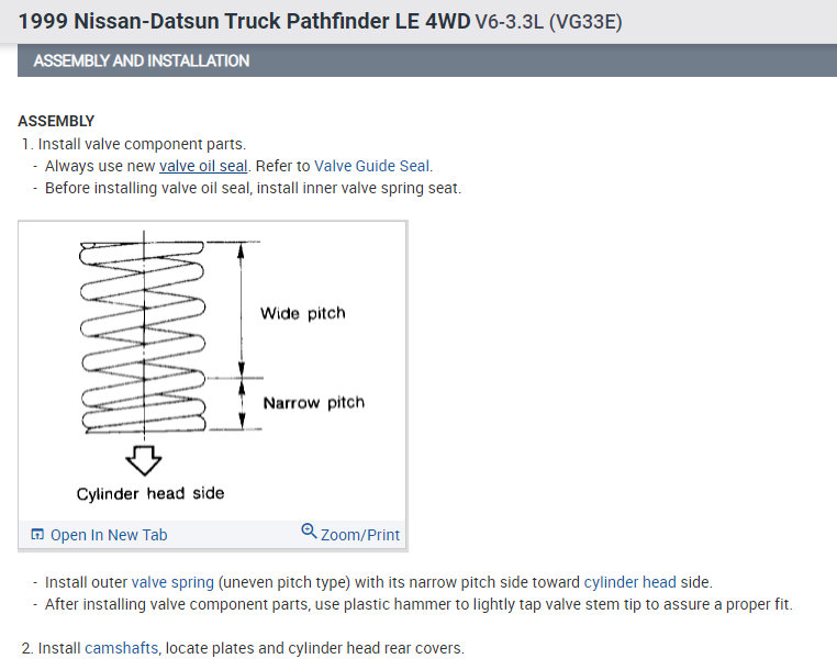

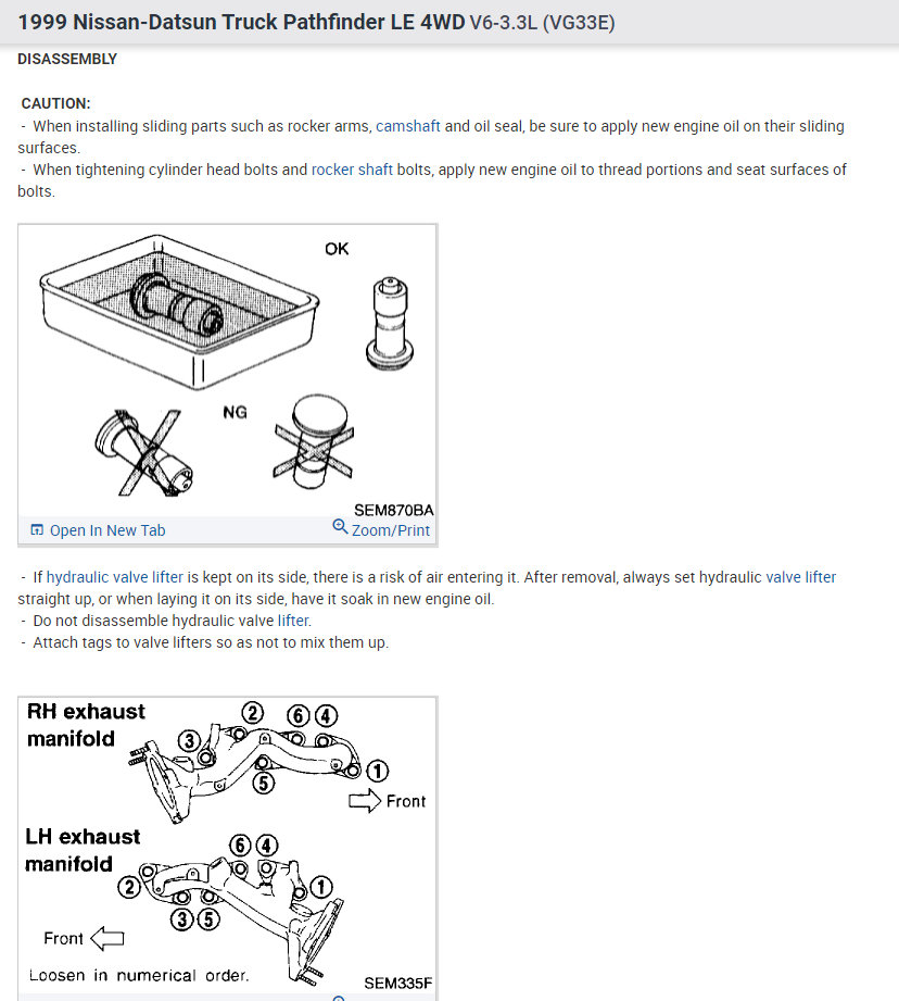

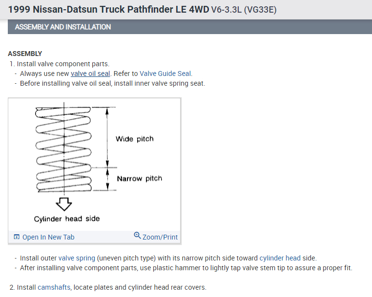

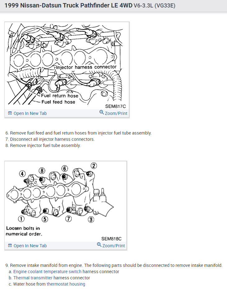

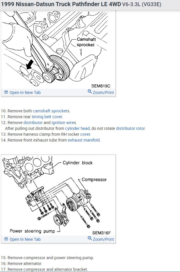

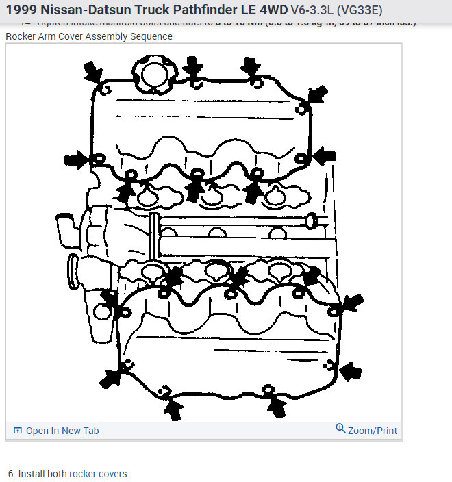

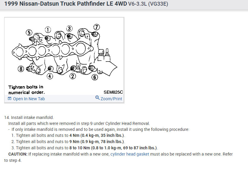

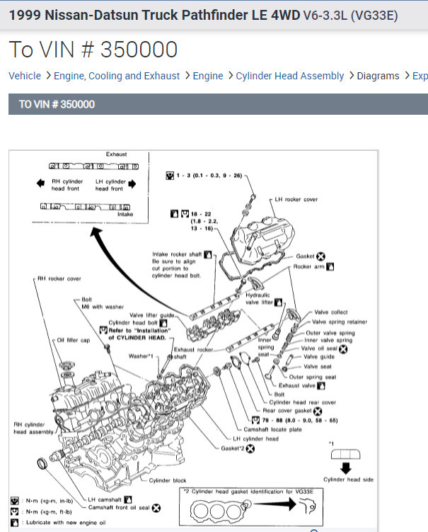

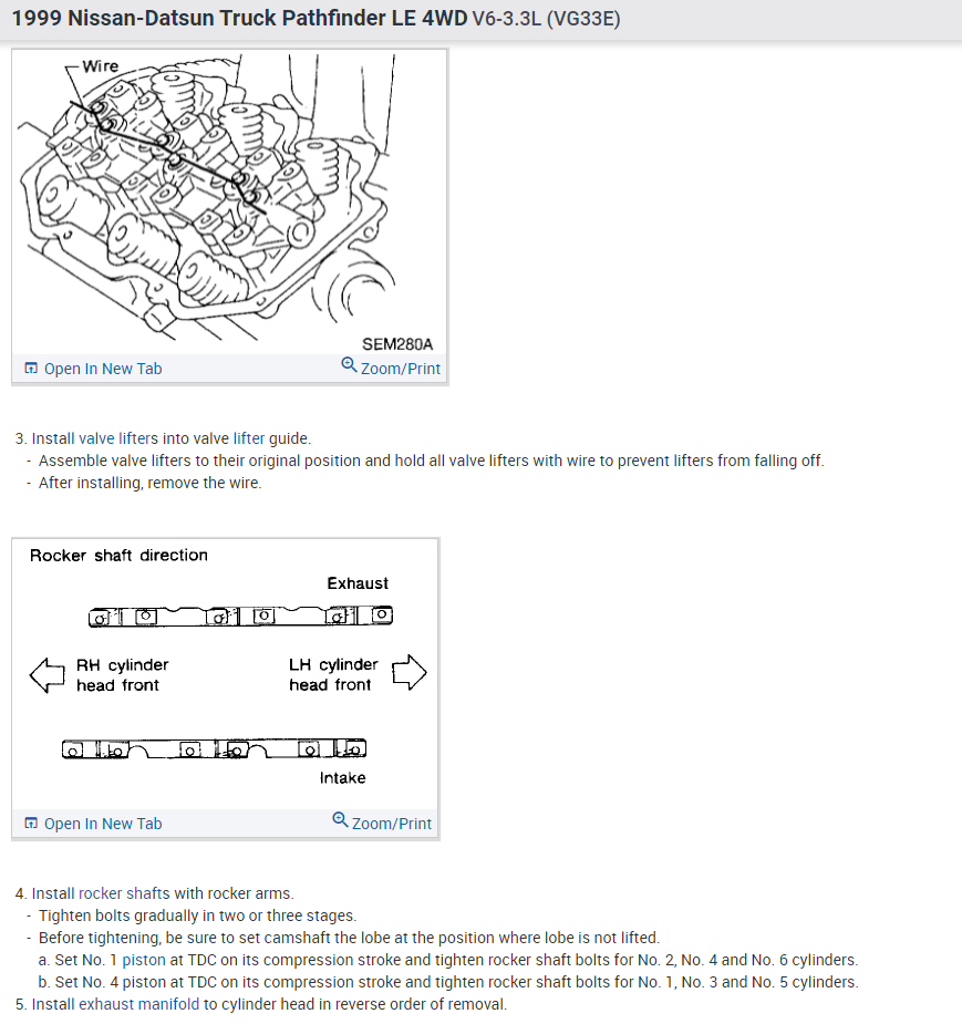

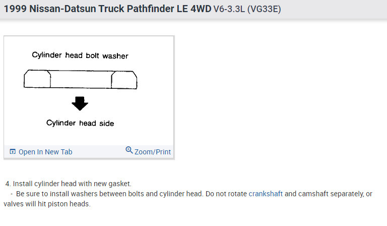

On this pathfinder there are two different version of cylinder head that was used.
One for VIN up to 350000 and the other for VIN from 350001.
They are primarily same with little variances.
I have attached the instructions for the 350000.
