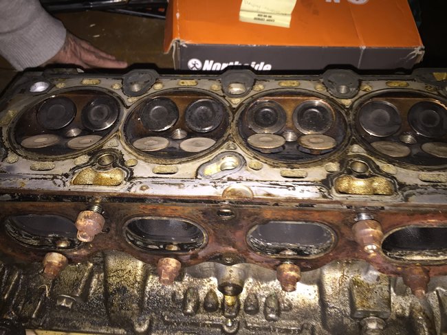

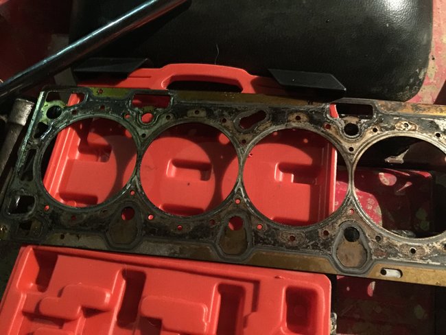

I have my head gasket off, I just need help to determine if it is blown and if my valves are bad?
Mar 5, 2018 at 5:01 PM
CERTIFIED EXPERT
52,796 POSTS
Good evening.
Yes the gasket is leaking.
You need to send the head to a shop and have them check the valves. you cannot test them visually. the head also needs to be checked to see if it is warped as well.
