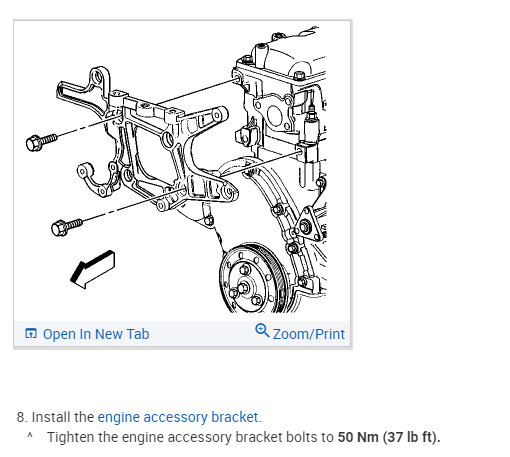

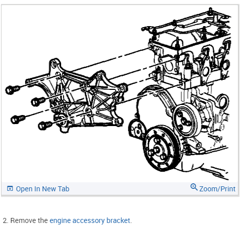

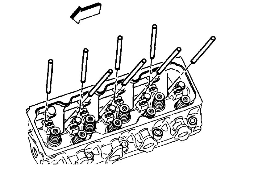

To remove the cylinder head, you need to remove the push rods, which does require the removal of the rocker arms. See pic 1 below. If they aren't removed, they will simply fall out when you remove the head.
Additionally, when reinstalling the push rods, it is very important to keep them in the same location where they were removed from.
Have you confirmed there is a head gasket issue? For example, is there any coolant mixing with the oil, excessive white smoke from the exhaust, or air entering the cooling system?
Take a look at this link. See if anything mirrors what you have seen and experienced.
See pic below.

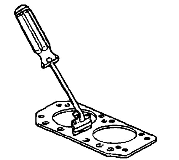

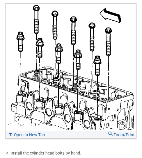

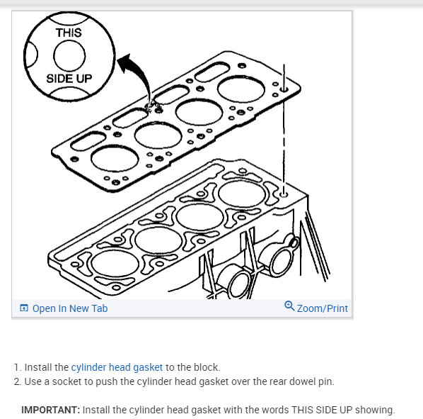

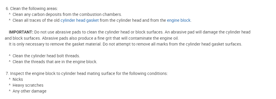

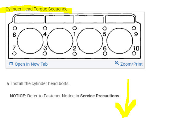

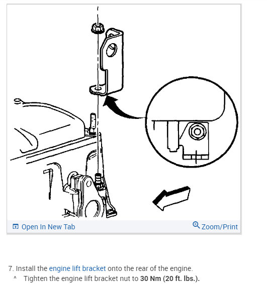

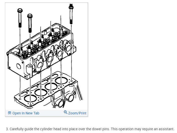

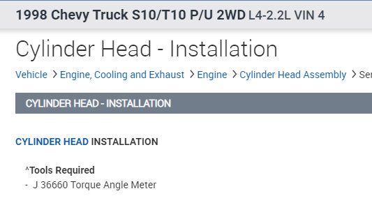

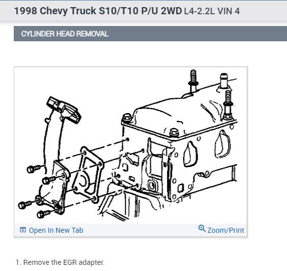

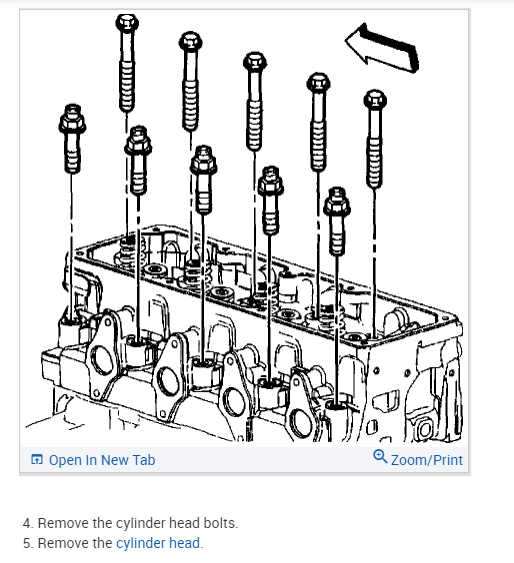

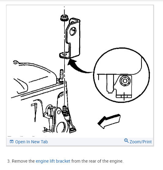

If the plugs have coolant on them and the radiator built pressure that quickly, your assumption seems correct.
When you remove the cylinder head, make sure it isn't cracked. You may want to have it checked by a shop to make sure.

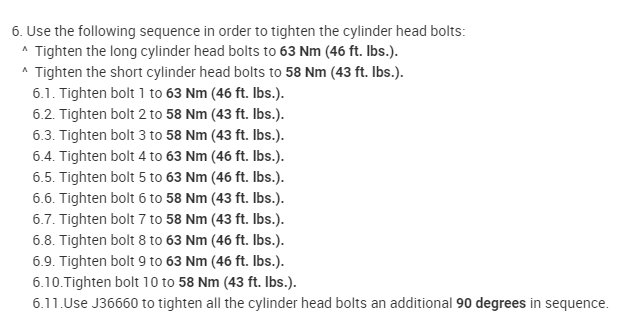

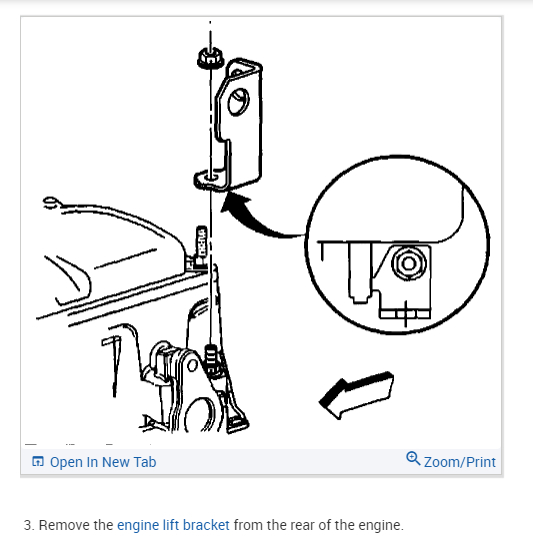

I attached the directions for the removal and installation of the cylinder head below. Take a look through them and let me know if you have questions.
Also, when reinstalling the head, make sure to follow the torque sequence and procedures. There are several steps to follow.
Take care and let me know what you find or if you have other questions.
See pics below. Also, make sure all lifters, rockers, and pushrods go back into the same position they came from.
